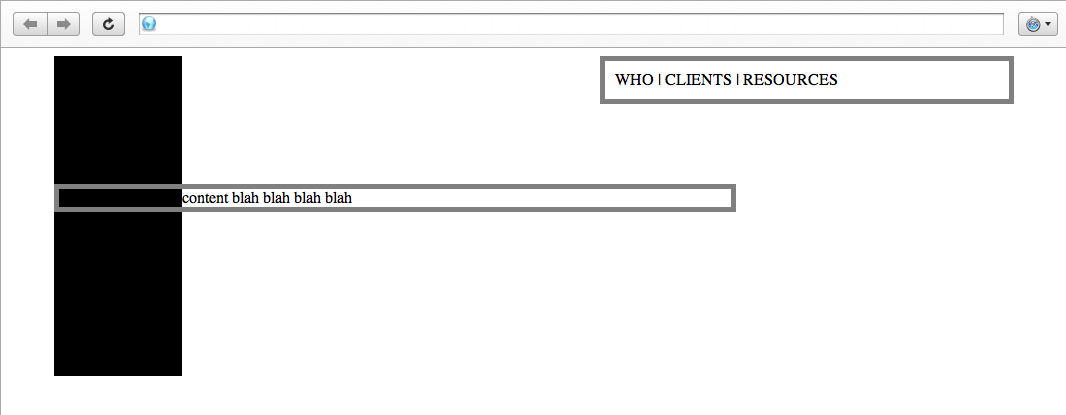

Everything is how I want it, except that I can't figure out why the text in the content area "content blah blah blah" is starting so far into the box. What controls that?

The explanation is simple: when you set it to relative and use a positioning property, the content stays on same position if it was in original place. Even though the div changed its position.
To understand better, try removing 'left:192px;' from the above code and reload the page. The result is that the black box pushes the content from that div:
