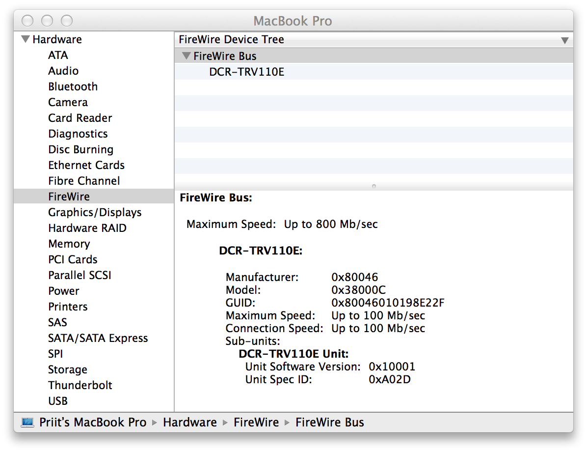

For starters, Sony camera needs to be in PLAYER mode for video capture! After you connect the camera, you shall see it in System Information under FireWire devices, as shown on 1st attachment.

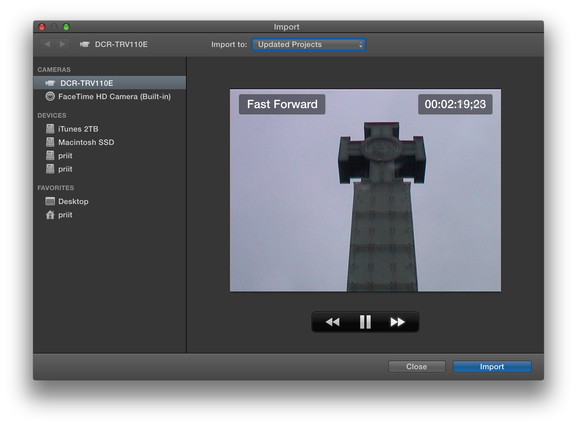

If it does, it will also show up in iMovie (or other capture program) in the Import view, as shown on 2nd attachment.

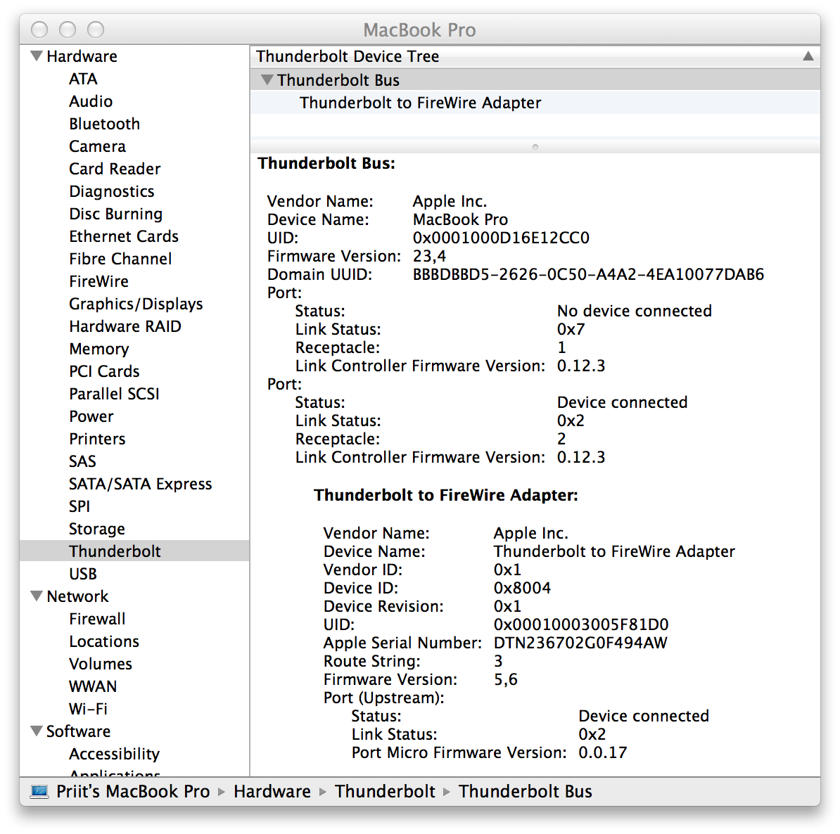

Could you also post what you get in System Info under the Thunderbolt section, while you have the FireWire adapter and camera (in Playback mode) connected?
Blank! nothing at all. All the Firewire cable and Apple Firewire adapter are also brand new.
That's disturbing!
Even without anything connected to TB ports, you shall see similar picture, as on my 1st attachment. So you shall see the TB controller on MBP's motherboard and the available ports (2 in case of my rMBP).
When you connect just the TB-to-FW adapter (even without FW cable and camera), you are effectively connecting a FW controller chip to your Mac's MoBo via PCIe interface. So you shall see the Adapter connected to one of the TB controller's ports, as evident on 2nd attachment.
If you don't even see TB device in System Info, then you need to have TB hardware or driver checked. If you see TB controller and ports, but no FW Adapter connected, then get the adapter changed for a working one.

My device tree showing Thunderbolt comes up just like yours it's just that nothing is shown being connected to it. Reading around on different sites I've seen that many people have had the same problem. Some people say that the video from my old Sony needs to be converted before my MBP will recognize it.
Do you see ThunderBolt ports as not connected in System Information? If so, then either the FW adapter or cable or Camcorder itself are at fault. If you can see the Apple FW Adapter connected in System Info, then one can assume, the adapter's ThunderBolt side is OK.
