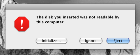

Hi, i just restarted to install a new version of itunes and the latest security update for snow leopard. Once i restarted, i notice one of my hard drives isn't showing up, and i get this message: (i took a screenshot and attached it) "The disk you inserted was not readable by this computer" with 3 options... initialize, ignore, and eject.
I hit "initialize" and go to disk utility, but all the options such as restore, verify disk, etc. are grayed out. So... i insert my OSX snow leopard install DVD, and restart holding down "c". It holds at a gray screen for awhile, then the disk just ejects and i start up normally. I really have no idea what to do at this point. Any help would be much appreciated.
