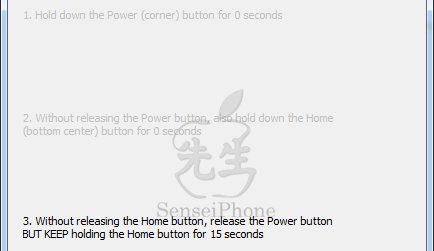

I've been getting exploit failed on this computer for days. It works when I use a different computer.
Other than this, you can also try to hold the home button a little longer in this step:
You can also try to download redsn0w latest version if you haven't done so.
Hope it helps!
