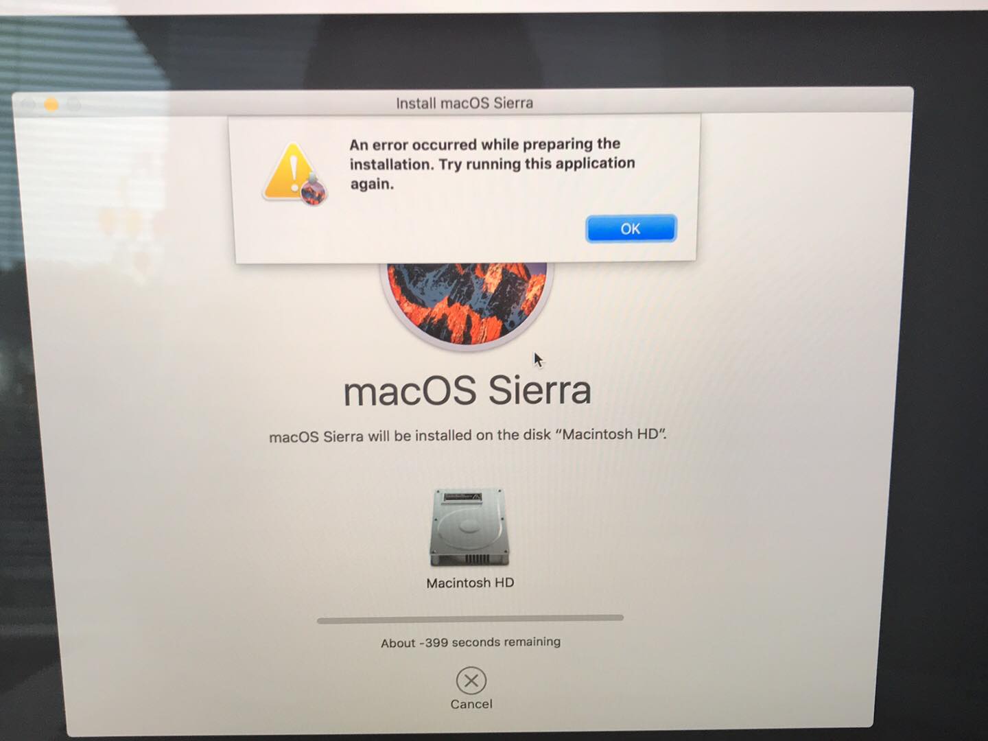

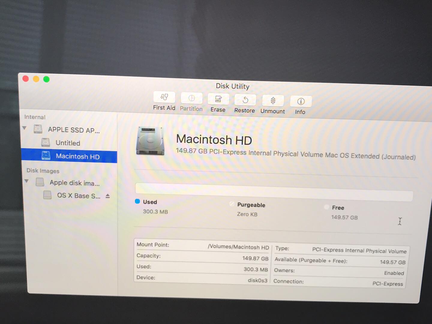

I was trying to re-install macOS on my intel based macbook pro 2016 because I was going to sell it, however after I erased/formatted the disk, it was showing error when I tried to re-install Sierra under internet recovery. I did First aid, made two partitions, but it always got stuck a few minutes into the installation and showed the same error. Really not sure what to do now, could someone help please...

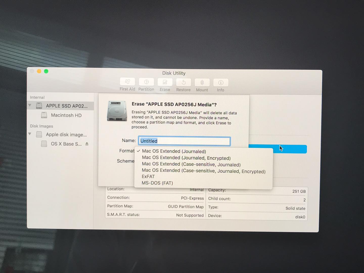

First thin I would do is completely erase the SSD, boot into Internet recovery or off a USB and go into disk utility and chose the Apple SSD entry at the top and then click erase and format as Mac OS Extended (Journaled). Then shutdown.
Next, reset the NVRAM. Press and hold CMD + OPTION + ‘P’ + ‘R’ (minus the quotes) all at the same time and while keeping them pressed turn on your MacBook. Keep holding the keys down, it will gong and then reboot and the gong again, release after three gongs (two should be sufficient but do three).
Now boot into internet recovery and try again - I would format the drive again, just to be safe.

The main error shown within the log is something about "Failed to get physical whole disk SKDisk"
I just tried these but no luck. I opened up the log while installing, and the main error it seems to show there is something like "Failed to get physical whole disk: SKDisk"
Do you suppose this is a problem with the drive? What if you did Option + Cmd + R to get internet recovery from the latest supported version (Monterey)?

I don't think there's a problem with the drive because it has been working perfectly without any issue until I erased the drive and tried to reinstall the system a few hours ago. The only version with internet recovery seems to be Sierra although the latest supported version for this model is Monterey. Could it be any problem on the Apple server side since it's a very old MacOS version(Sierra)?
Reactions: rm5
I honestly do not remember if Sierra had a system data on a separate volume and by formatting the APPLE SSD** you did not removed it. Have you tried to install the macOS from a bootable USB?

I figured out the problem... I was pressing cmd+R when rebooting which brought me to Sierra internet recovery where the installation of system couldn't go through(must be a server problem since it's an old OS). Instead I should've pressed option+cmd+R when rebooting which would bring me to Monterey where I was able to format the disk using APFS and the installation also went smoothly. I'm sure installing from a bootable usb will do the trick too.

  • Installation failed: 'Error Occurred While Preparing the Installation Error'

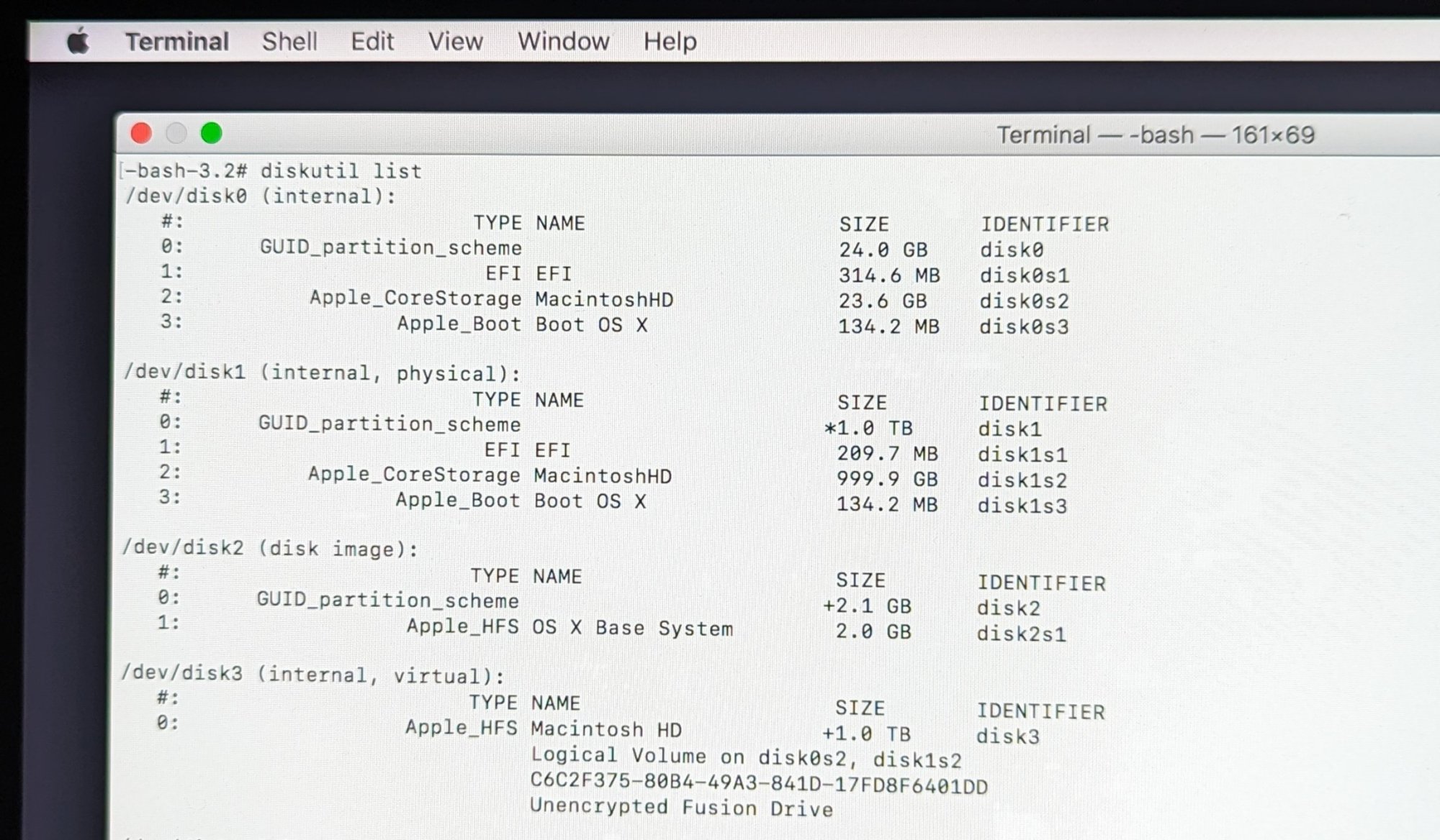

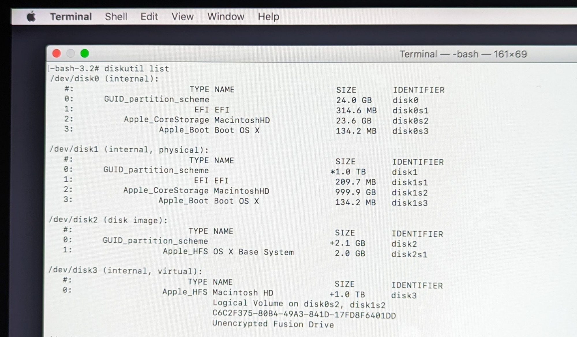

Thanks for your assistance unclemiltie. Before I go ahead and erase, I want to show how it's currently setup after having followed these instructions originally https://support.apple.com/en-us/HT207584
Please take a look and let me know if you think I should go ahead and do it
So you have a fusion drive, which are kind of a pain in the ass. If you do as I said above you will "split" the fusion drive into two drives, which is probably not what you want.
there is a terminal command to repair a fusion drive back to what it should be, I'm trying to get out of the house right now so don't know it off hand.
So what you could do is reformat and erase both disk0 and disk1 (disk0 = the SSD part of the fusion drive, disk1 is the hard disk part) and then find that command (google will help) to re-merge the fusion drive. Then install again.
The drive was split when I first got the computer. The drive had been completely erased and two disks showed in disk utility, a spinning disc and SSD. I followed the instructions to rebuild the fusion drive: https://support.apple.com/en-us/HT207584. I did it via the terminal like you describe. Are you suggesting that I need to start over and do it again?
