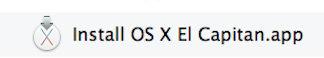

I downloaded El Capitan a long while ago. This is the way it looks, here is a picture. If this doesn't look like it will do the trick, please offer where I might find an El Capitan.
It shouldn't be too hard getting all of my husband's data up as he doesn't save videos, pictures, or movies, that's my area of expertise. I'm assuming that I will have to buy program called iWork (Pages) since his data is mostly tided to iWork '09/.
To answer Darmok N Jalad's question, I downloaded El Capitan a long time ago, I think it downloaded as a.dmg, but I can not be 100% sure. If I am wrong, and you are familiar with my picture above, do you know of any place it might be available? If push comes to shove, then I would have to replace High Sierra with Sierra, I guess.

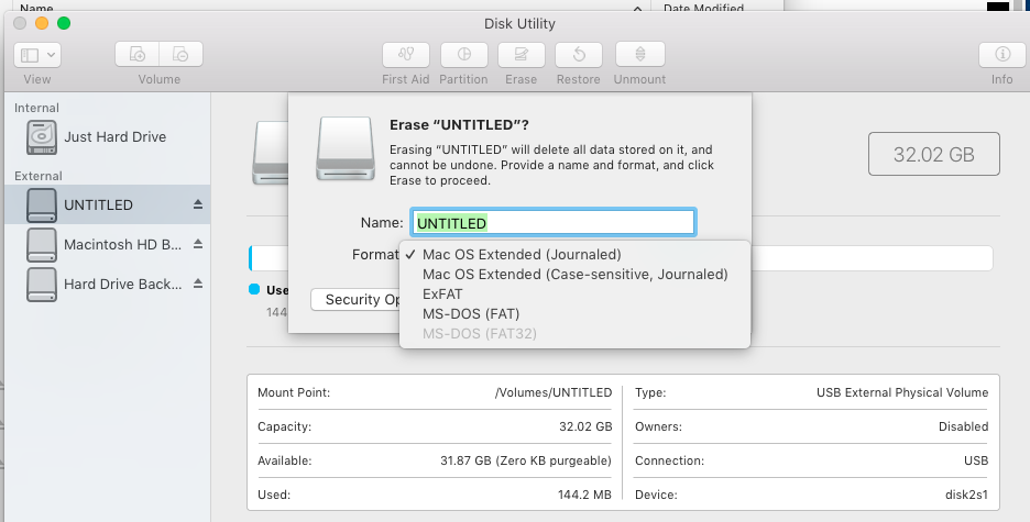

1. Get a USB flashdrive. 16gb will do. If you don't have one, try 8gb (absolute minimum).
2. Open Disk Utility and ERASE the flashdrive to HFS+ with journaling enabled.

You will find the "Install OSX El Capitan.app" in the /Applications directory. More than likely it was not downloaded as a DMG, however these links I posted address all of that. You will need to use the Terminal app that came with OSX, which can be found in Applications -> Utilities. I actually prefer iTerm instead of Terminal, which can be downloaded here:

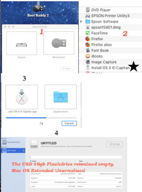

Thank you for your step by step instructions, and the Boot Buddy helper. I have printed off all the instructions.

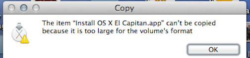

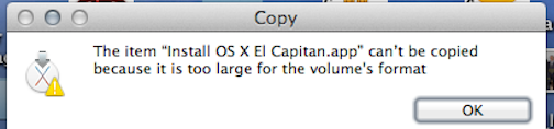

I neglected to tell folks that the El Capiton was downloaded onto my Mac Mini which is running on OS X 10.8.5 (12F45) Mountain Lion (Late 2012).

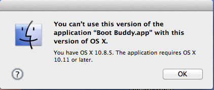

Using my 10.8.5 Mac Mini, I downloaded Boot Buddy, but could not get the El Capiton application to merge with my 31.87 GB thumb-drive to be connected to the Boot Buddy. Below is the message I received.
Opened for suggestions.

You probably have the drive formatted in FAT. Reformat the drive as an HFS+ volume.
]titangears You are correct, "Duh", I was so nervous I forgot to Formatted in FAT.
I formatted as suggested, unfortunately, this is what I saw.
Guess I will have to move over to my Husband's computer and try to download an different EL Capiton.

My USB flash MacOS installer drives are formatted with the Master Boot Record partition map, with the format being MacOS Extended (Journalized).
  • Once you get your flash drive setup with the installer, you'll need to plug it into the Mini, and turn it on.
  • After the Apple bong sound, hold down the Option key (or Alt if it's a non-Apple keyboard), and then select this USB drive from the list of boot option. It will start the installer.
  • When the installer loads, select Disk Utility.
  • From Disk utility, select the Mini's hard drive and select "Erase" (which obviously destroys all data on this drive, hence the need for a backup of important files).
  • Select GUID partition scheme, Mac OS Extended (Journalized). Give the drive a name of your choosing and continue.
  • When complete, close disk utility and proceed with "Install MacOS X."
  • When prompted during the install process, select your newly formatted internal drive and proceed to the finish line. It's all downhill from there!
OP:
In the screenshot of Disk Utility posted in #18 above, the choice you want is the checked one:
Mac OS Extended (Journaled).
Just make sure you erase the correct drive!

Fishrrman, didn't think I had any other choice but to erase hubby's (Bob) internal drive. Today is my big challenge. BTW, what does OP sand for?
Looks like I am missing something. Below are four pictures showing how far I got just trying to get Boot Buddy to work. I won't give up if ya'll won't give up. I took screen shots to show how far I got, is the Boot Buddy Flash Drive suppose to have something
inside, because mine didn't?
If you have your USB drive formatted and named "Untitled," plug it into the machine that has the the "El Capitan" installer. Make sure the El Capitan Installer is in your Applications folder. Highlight the following with your mouse, right click on it, and "Copy"
sudo /Applications/Install\ OS\ X\ El\ Capitan.app/Contents/Resources/createinstallmedia --volume /Volumes/Untitled --applicationpath /Applications/Install\ OS\ X\ El\ Capitan.app
Open the program "Terminal," right click, and paste. The command above will drop in. Hit "enter" and you will be prompted for your password. Terminal will take some time to copy the El Capitan app on the USB drive, but it will show the progress and let you know when it is done. Once it is done, the USB drive on the desktop will change from "Untitled" to "Install El Capitan." You should then be ready to go for the install process.
It looks intimidating, but it really isn't.
In Picture 3: The Source (Install OS X El Capitan) is correct. The Destination should be the "Untitled" USB thumb drive.
