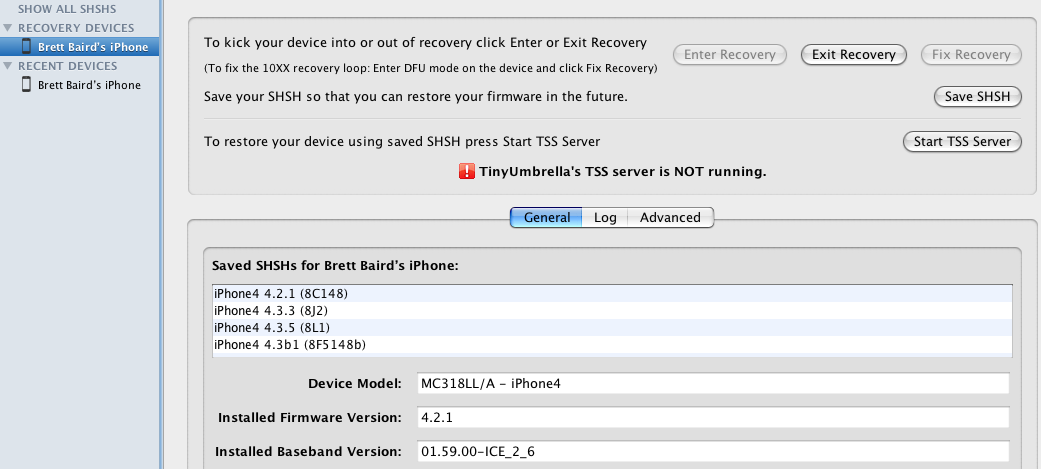

Here is a screenshot from umbrella if that helps.

You have blobs save, so you should be able to restore your phone to any of that firmware. Make sure you have TU's TSS server running while restore to that firmware. Also, make sure your phone is in DFU mode and not recovery mode first.
