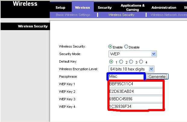

well i tried it and i'm having no luck. i got into the setting for the router, and i went to wirless security settings. i used SEP (or whatever), it made a password and when i try to connect and type in the password, i get the error "there was a problem connecting to the airport network" (or whatever). any ideas?

With WEP you type in a Password and ti shold give you a Hex-Decimal key. I have had the error that you are describing and using the key made the conncetion work. In the attcahed photo i show what i think you did.
The blue outline is not the password. One of the red oultiled keys are. It all depends on what one you pick.
I am using a linksys wireless b router and the screenshot is in the Wireless-> Security. Hope this helps

thanks for all the replies. i finally got it to work. i had to change it from 64-bit to 128-bit, b/c for some reason my powerbook only does 40-bit and 128-bit. (at least i think). but either way, i got it to work by changing to 128-bit. thanks for the help
128 is more secure than 40 bit. If you live in a fairly rural area, you should be fine, but if you live in a city or apartment complex, etc, I would recommend using WPA. Given enough time (hours or days, depending), WEP can be cracked without much effort.
