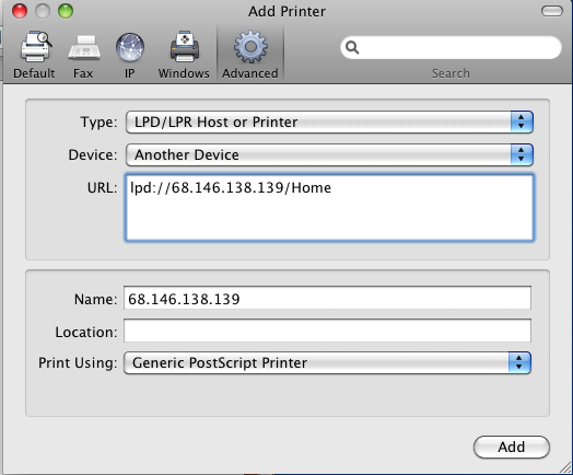

Hi Guys,
This is driving me nuts, what I want to do is share a printer on my network. It is hooked up to my dads PC with Windows 7, I want to be able to print on my Mac, I've looked at tutorials but I cant get it working.. when I attempt to print it says
Network host '68.146.138.139' is busy; will retry in 5 seconds...
Printer I am using is a Brother MFC-465CN
My Dads IP is : 68.146.138.139
Port: USB001
Sharename: Home
Hope someone can help =/
Thanks for your time :]

How to connect Snow Leopard client to Win 7 Print Server
Enable Printer Sharing in the Win 7 Printer's Properties, and note how they change the name from "My Printer Name" to "My-Printer-Name". Use this string in the Mac settings for the printer name.
On the Snow Leopard clients, Click on the Add Printer button and then enable the Advanced setting in the Toolbar.
Choose the "Windows" option under Advanced and enter your print server address and printer name on the SMB line (eg. smb://10.1.2.3/My-Printer-Name ).
You don't need to enter your "Name😛assword@" in this line (doing so make your info visible to others).
When you first go to print to the Windows server, it will ask you to Authenticate as a registered User on the Print Server.
Note: you need to make an account for yourself there first, or use the Name and Password of an existing User on the Print Server.
Caveat : On my Win 7 server, in the Advanced Sharing Settings : HomeGroup Connections section, I am using "Use user accounts and passwords .." instead of "Allow Windows to manage ..." to control how my computers talk to each other.
