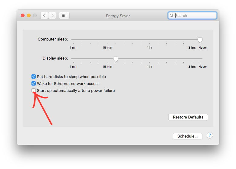

Never tried to do something similar, so sorry for not answering your main question.
But i just wanted to ask you have you checked if both Macs, yours 1,1 and friends 5,1, have the same Energy Saver settings?

Thanks for the tip. In BOTH system, this option was turned off.

I've tried all possible scenarios (i too have power bar with on/off switch), even to shut it down (power button and power bar) during OS running, and it won't turn on by itself.
The only time it turns on after cutting the power directly from the wall (with a bar's switch) is if i have that option checked in Energy Saver (Start up automatically after a power failure).
