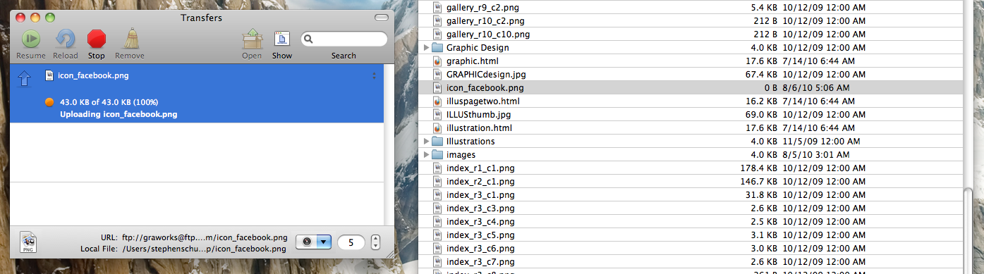

Here's the problem in detail. I can connect to the server and see all the files but when I try to upload anything it starts... gets to 100% and then just freezes. It then shows the file on the site remotely but has a great big 0kb right next to it like it's not there. After it gets to 100% and freezes it usually tries to disconnect itself. Same thing happens every time.

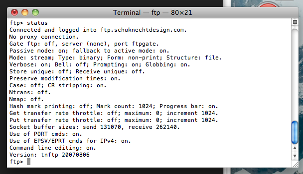

I have some photos that I can post that might help some more. I got on the terminal to get a status. It doesn't mean a whole lot to me but maybe you can make sense out of it?
Thanks a million.
Here's the status through terminal...

Looking at the ftp client.
