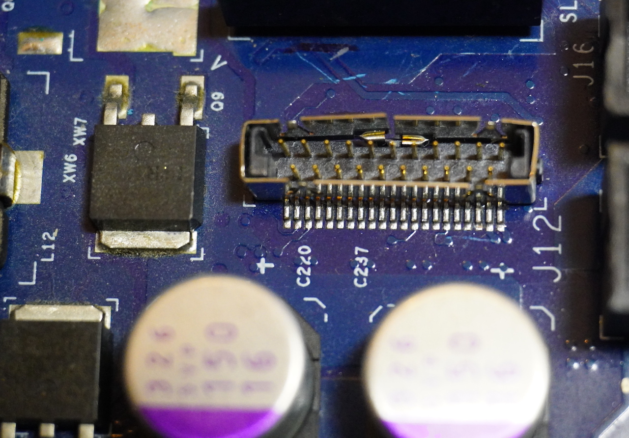

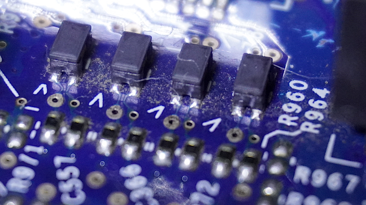

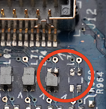

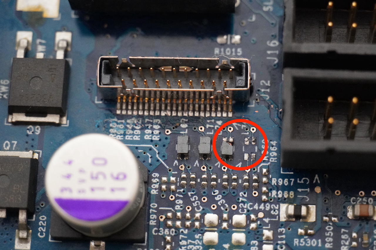

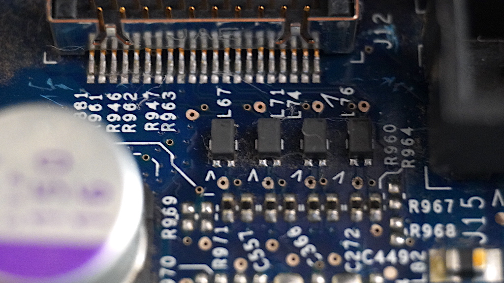

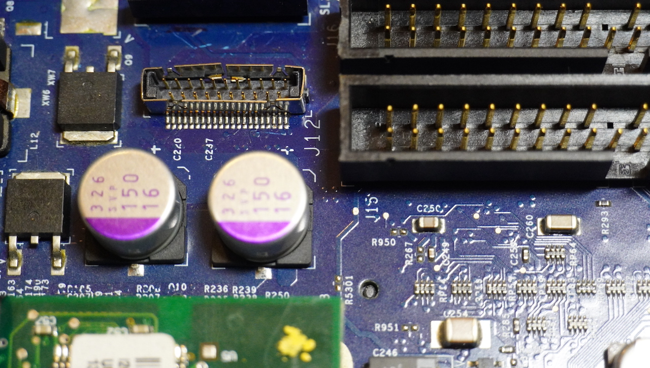

I was recently preparing the subject model iMac to install an SSD (which I've performed several times successfully on another 17" and also 20" iMac G4).
Unfortuntaely on this occasion whilst trying to prise-off a rather tight connector I damaged 2 adjacent components on the motherboard.
See following photos:
i) Is anyone capable of identifying these components please.
ii) If so from where can they be purchased?
iii) Can anyone suggest from where I may be able to get these installed.
I'd have no problem in removing the motherboard and shipping within Europe to facilitate the repair.
Any help would be greatly appreciated.

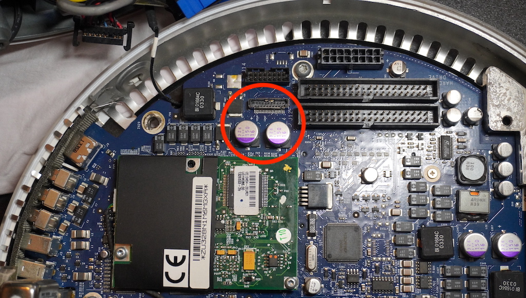

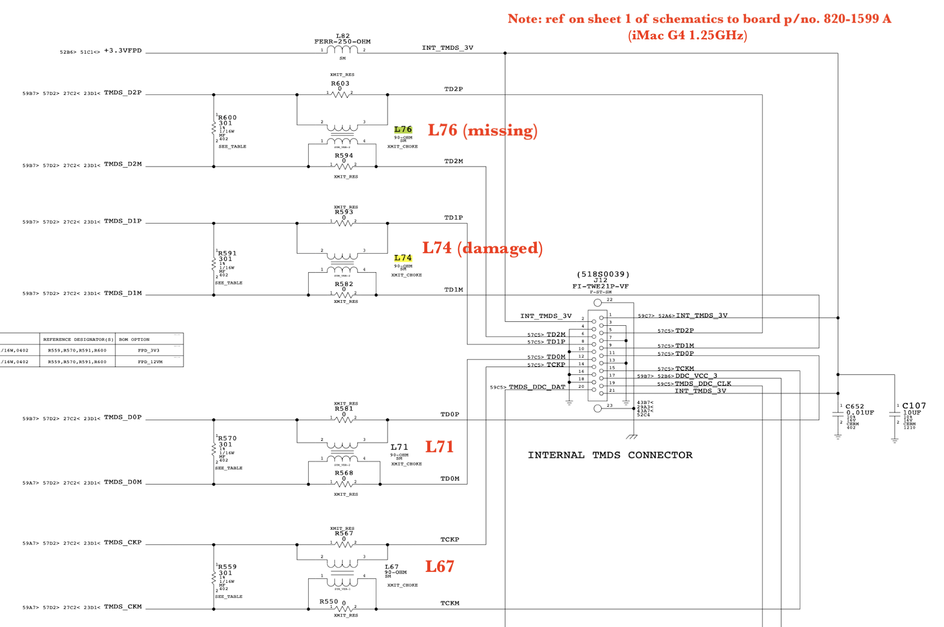

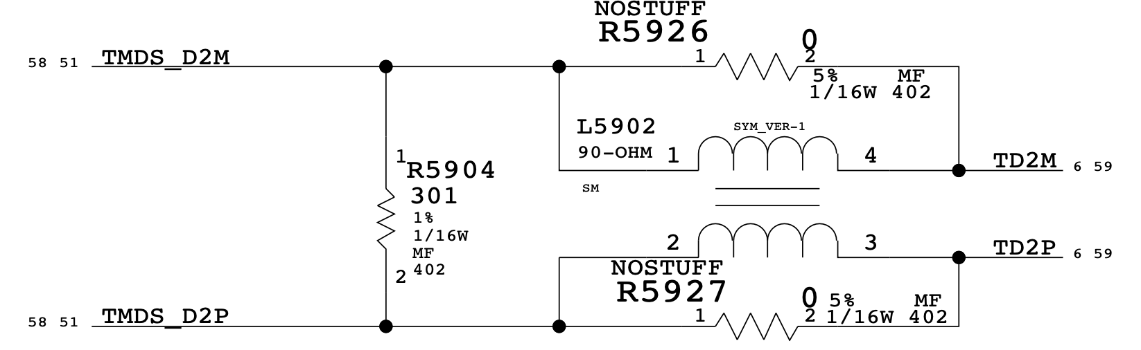

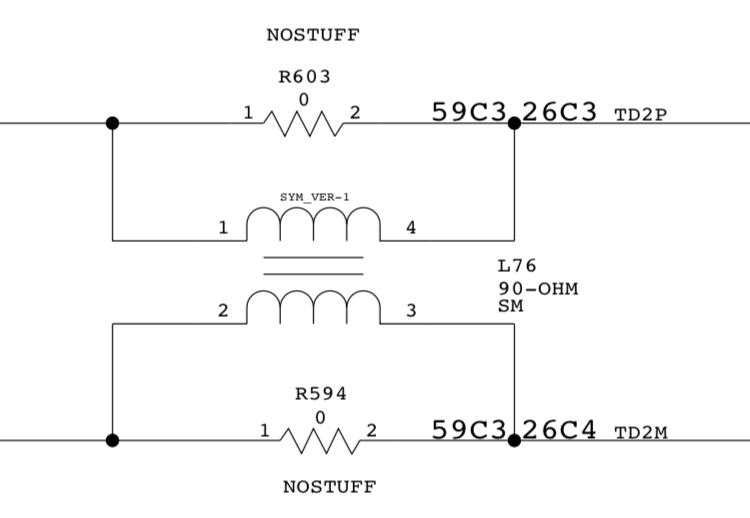

According to the 820-1501-A schematics, this connector (J12) is indeed for the TMDS link to the internal display. That common-mode choke (L76) is labeled as having 90Ω impedance, so the trick is choosing one with the proper frequency response to match its friends on the logic board.
Interestingly the schematic shows an alternate configuration wherein 0Ω resistors are used rather than the common-mode chokes, possibly for development purposes.

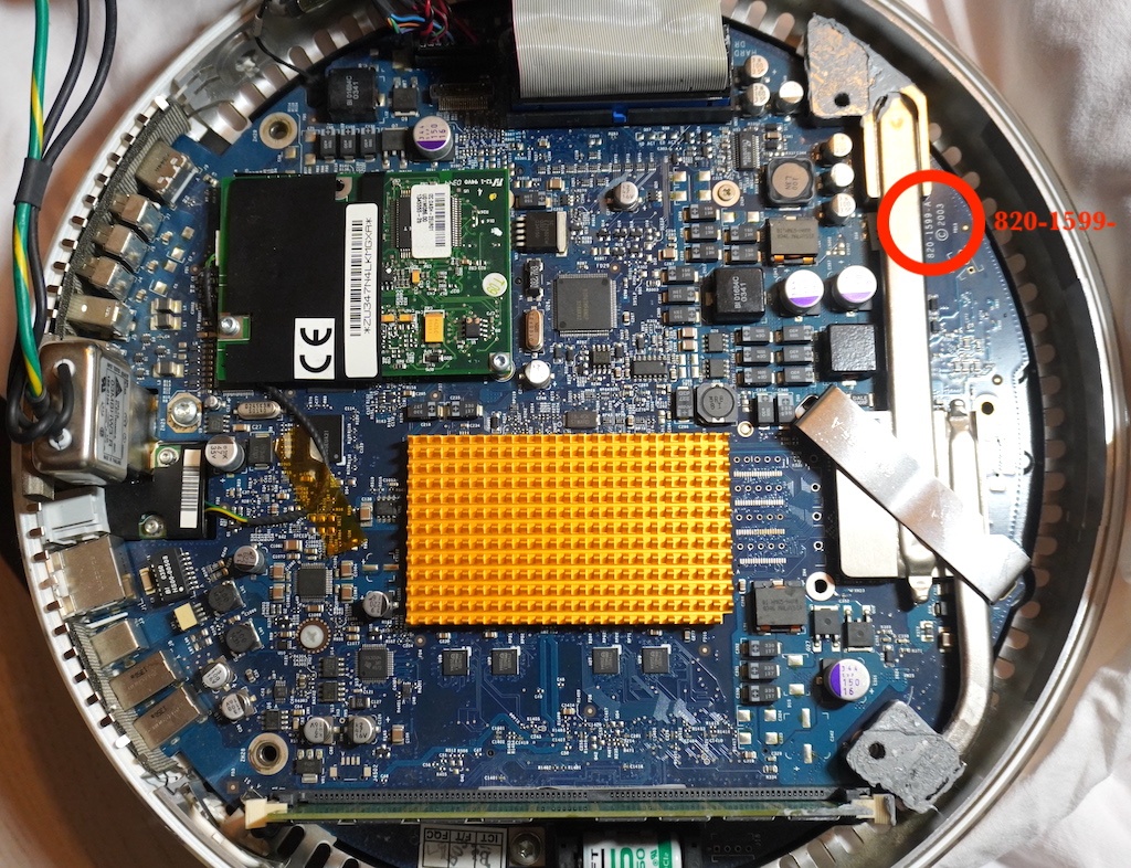

I confirm that the iMac G4 1.25GHz logicboard p/no. is 820 1599-A
@Needlerooser: Your 820-1501-A schematics would appear to refer to the G4 1.0GHz model but is nonetheless interesting especially the info on the common-mode choke (L76). These four components appear to be common accross both logicboards.
A search has turned up the following schematic, sheet one of which gives mention of my 820 1599-A logicboard.
https://www.electronica-pt.com/esqu...k,953b20147a6a6ecaa57ef587d1cfe148/no_html,1/

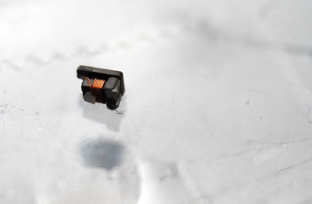

Had a rummage about in my 'spares' room and located another G4 1.25GHz iMac purchased long since and forgotten about. It booted but to a screen with garbled artifacts. Unsure of the problem, I delved inside and took a few photos but couldn't identify any obvious defects. I'll show this board in a follow-up post.
Reactions: Needleroozer

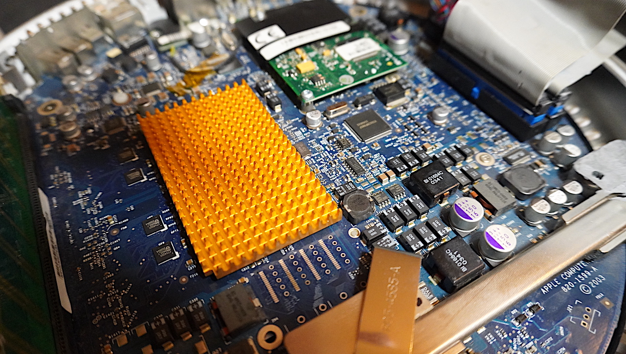

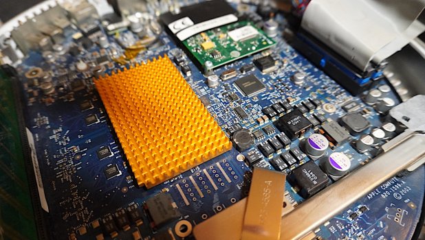

Here are a few photos of the other iMac G4 1.25GHz logicboard 820 1599-A in my posession. I cannot see any obvious signs of capacitor bulging or leakage - that's just about how far my experience goes in terms of logicboard inspection for on-screen graphic artifacts.
@philgxxd: Please let me know if you think you may be able to procure these L76 and L74 components to perform a repair. As we're both in Europe I could also send the 2nd logic board for trouble-shooting and (hopefully) eventual repair. I would of course pay for any parts and reasonable cost of repairs and return postage.
I'm having problems to find a replacement without knowing more specs of the component.
I would like to continue to discuss the matter a little more with you guys before anything else. Maybe @Needleroozer can give more insight and guide us to a suitable replacement.
As a last resort you could of course take the donors from the "garbled screen" logicboard.

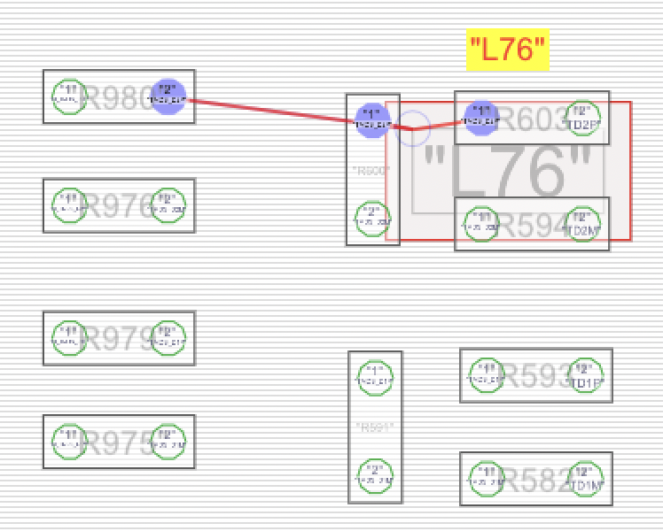

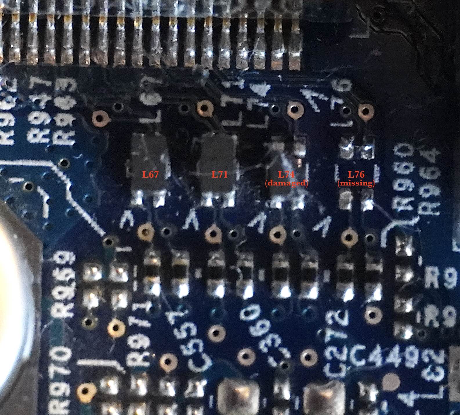

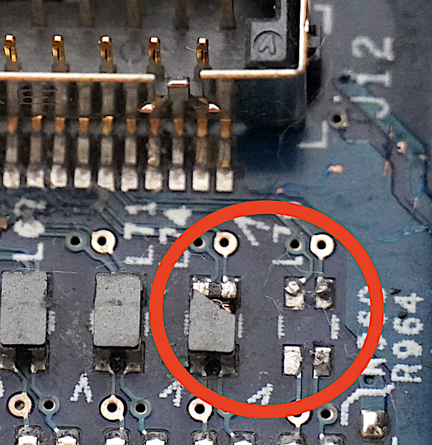

It took a bit of finagling, but I managed to find a boardview for the 820-1599-A PCB which you can open in OpenBoardView (compressed and attached as a .zip because the forum wouldn't let me upload a .bvr). Unfortunately, neither the schematic nor the boardview give us much to go off of in terms of the actual component name, but the footprint is that of an 0805 (2012 metric) component.
@Needleroozer
Would it be sufficient to measure the inductance to find a suitable replacement?
Common-mode chokes are typically specced for a singular impedance at a given frequency. 100MHz is typical, but to know for sure you'd want to do a frequency sweep from 0 to at least 100MHz so that you could compare the impedance-versus-frequency plot against commercial options...
After running parametric searches on Digikey and Mouser (90 Ohms at 100MHz, 0805/2012 package), there aren't too many results for whatever reason, so you may wind up being able to differentiate based on the DC resistance of the chokes on the PCB. These range from 0.2 Ohms to 4 Ohms, however, so you would either need very good multimeter leads or a four-wire resistance measurement setup to characterize that accurately.
If I had to choose one, I'd probably go with these due to their low DC resistance and relatively flat impedance with respect to frequency:
Another interesting finding is that those unpopulated zero-Ohm resistors (R603, R594, etc) have footprints on the bottom of the board directly underneath these common-mode chokes.
So if you have some zero-Ohm 0402s, you could pull the chokes off and install eight 0402s down on the bottom of the board instead. The chokes are there for signal conditioning rather than ESD protection, and this is all inside the iMac anyway, so I think it's probably fine to swap them out for jumpers.
Alternatively, if you have any dead iMac G5 motherboards, they seem to have the same 90-Ohm chokes on their internal TMDS connector, so you could harvest spares from there as well (I checked this on an 820-1540 schematic, but I'm pretty confident they'll all be the same).
Is bridging with solder blobs or fine wires not an option as this would be very easy to do for @CooperBox ?
Reactions: CooperBox
Totally an option as long as he removes the common-mode chokes first, yep. Little pieces of wire would be easier in my opinion since a 0402 footprint is a little big to bridge with surface tension.

As mentioned above, both 17in 1.25GHz G4 iMac's in my possession have logicboards p/n. 820 1599-A.

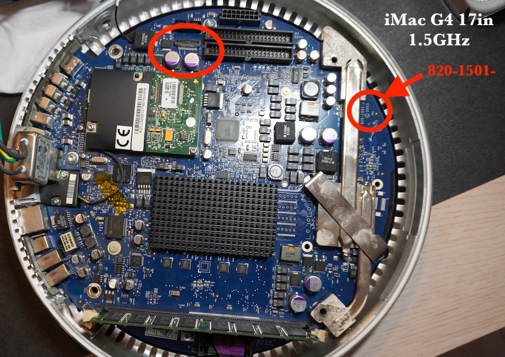

Now just to confuse the issue, I forgot that I had a 3rd iMac G4 1.25GHz stored away (fully functional) which today I opened up and was surprised to find the logicboard p/n. 820-1501-A. This being the same p/n that needleroozer showed the schematics for in post #5 above.
Thinking that particular board was special to the 1.0 GHz 17in model, I re-assembled the base and booted the iMac to confirm exactly if this was a 1.0 GHz 17in or 1.25 GHz 17in model. The system report confirmed it as the latter. Photos of the board follow:

The highlighted circle shows a different configuration to the 820 1599-A board

You’ll note that the 4 common-mode chokes appear to be absent on this 820-1501-A configured board. Is this related to the use of 0Ω resistors alternative schematic configuration referred to by needleroozer?
There’s a good chance that they’re simply on the other side of the logic board.
