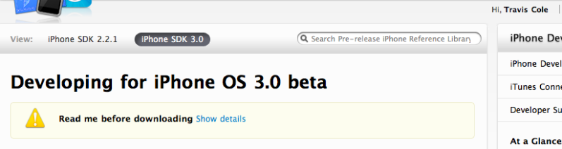

It IS registered, my software worked up until last night when i tried a restore because it would not show up in iTunes, I did not downgrade, I restored from 3.0b to 3.0b
Proof:
Real Name in top right of Pic
