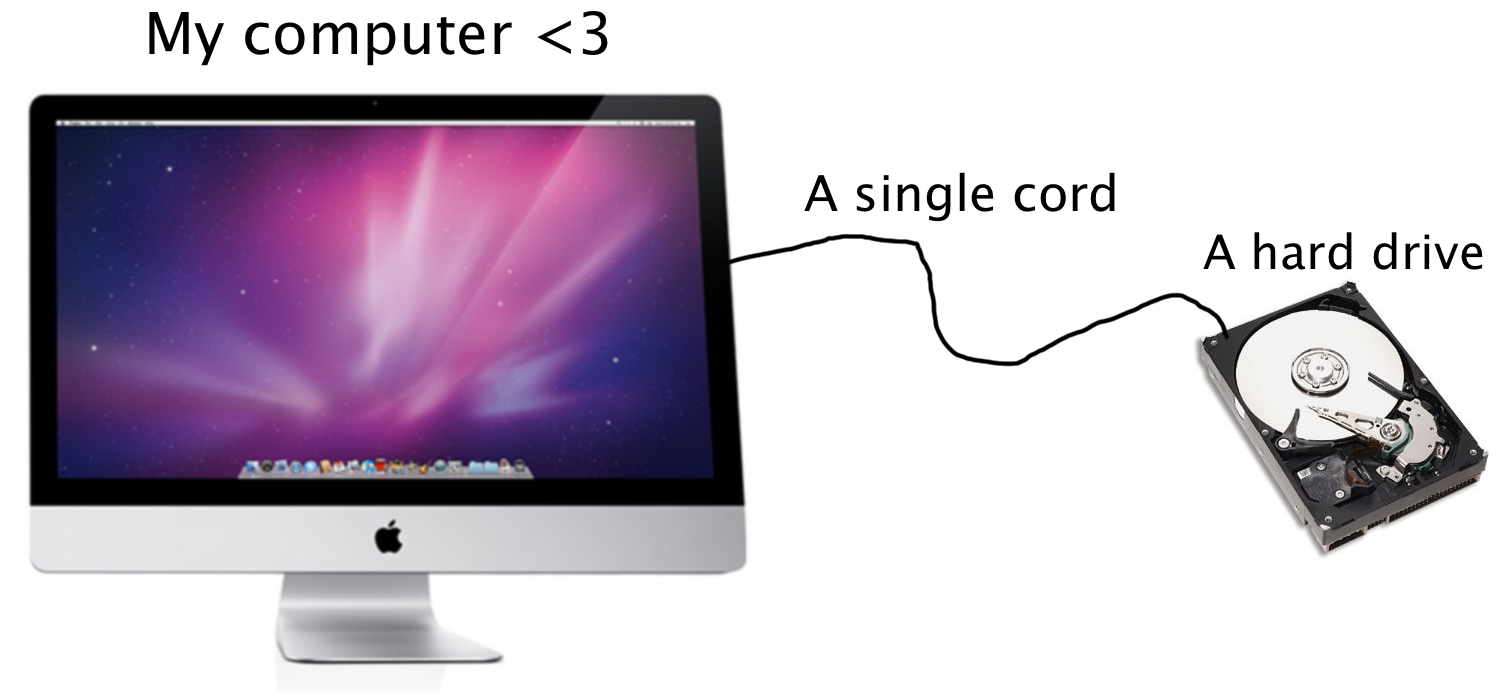

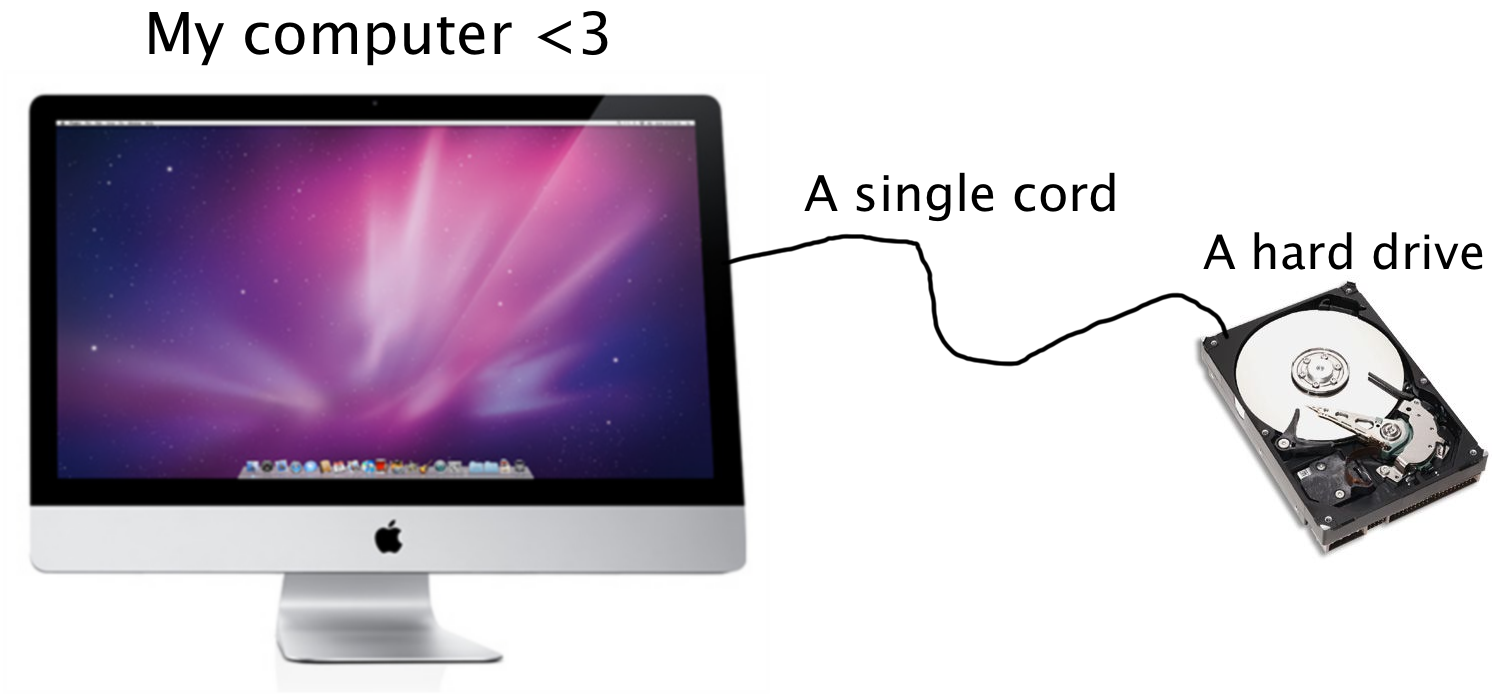

I want to make my own external hard drive! 😎
If you do not know what I mean, here is a picture:
Obviously this will be very hard (but also fun) because I am very cheap and do not have the money to purchase a very simple solution to my problem.

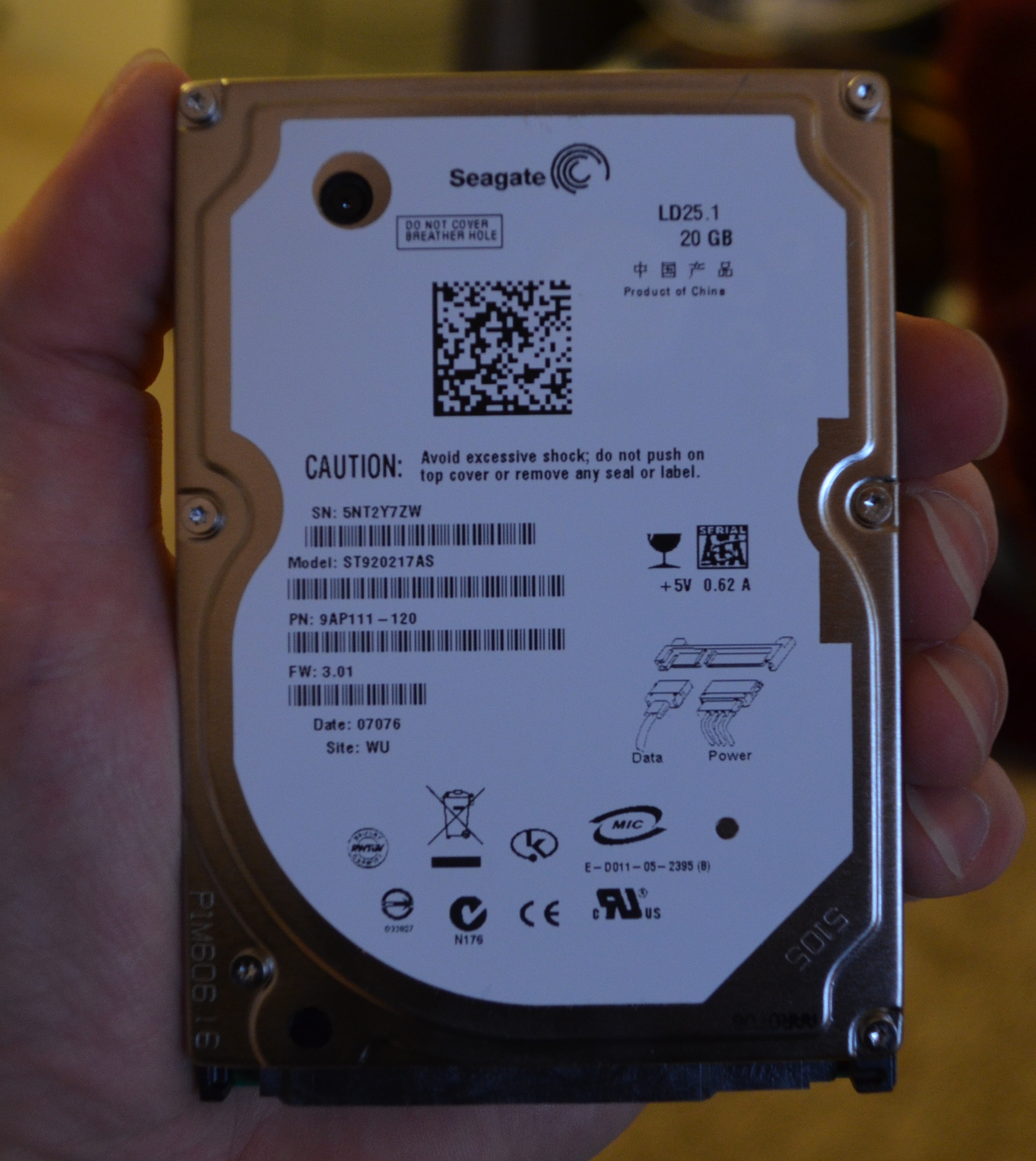

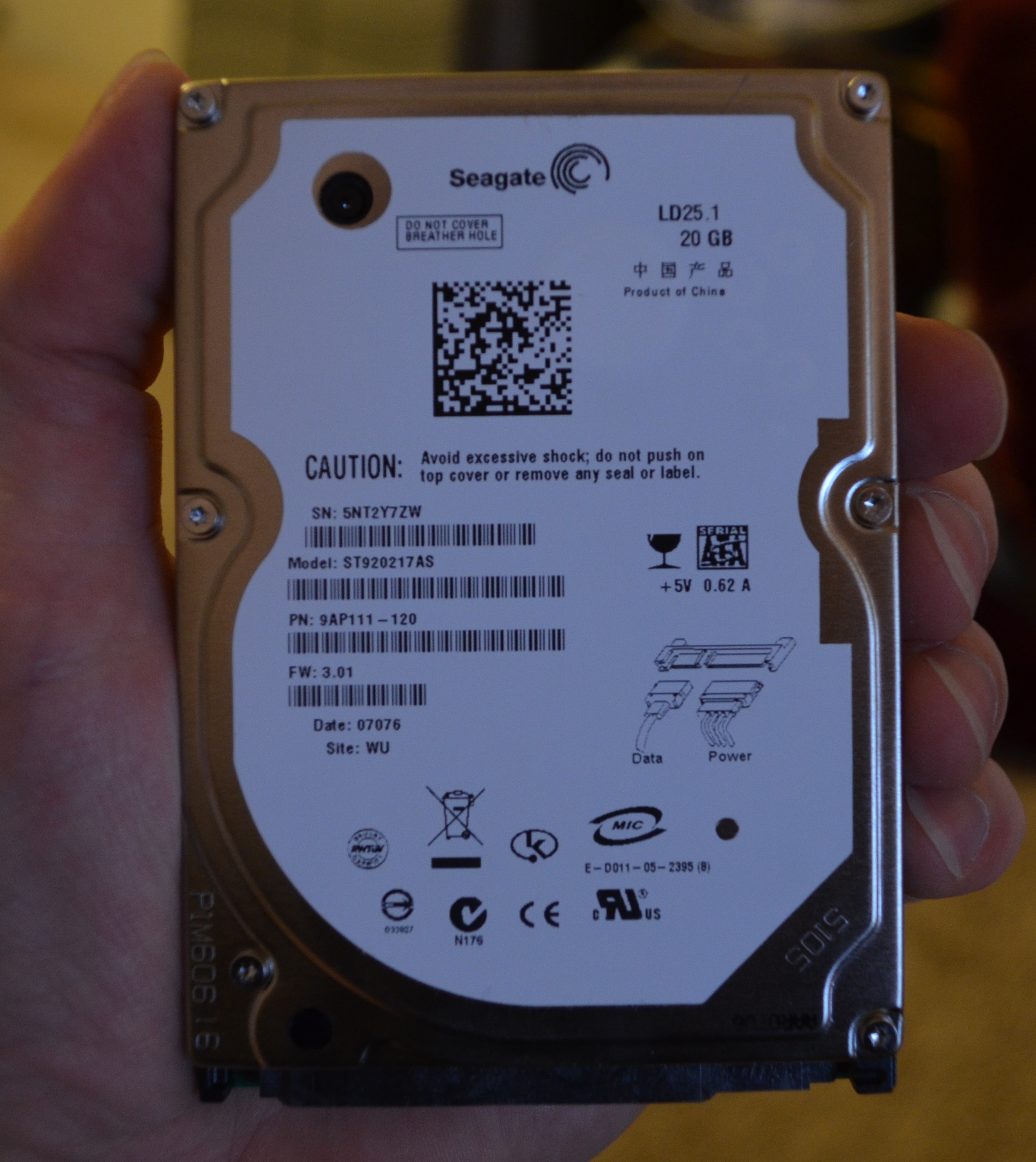

So, I've salvaged two hard drives from some old hardware... a 2.5" 20 GB HDD from an Xbox 360...

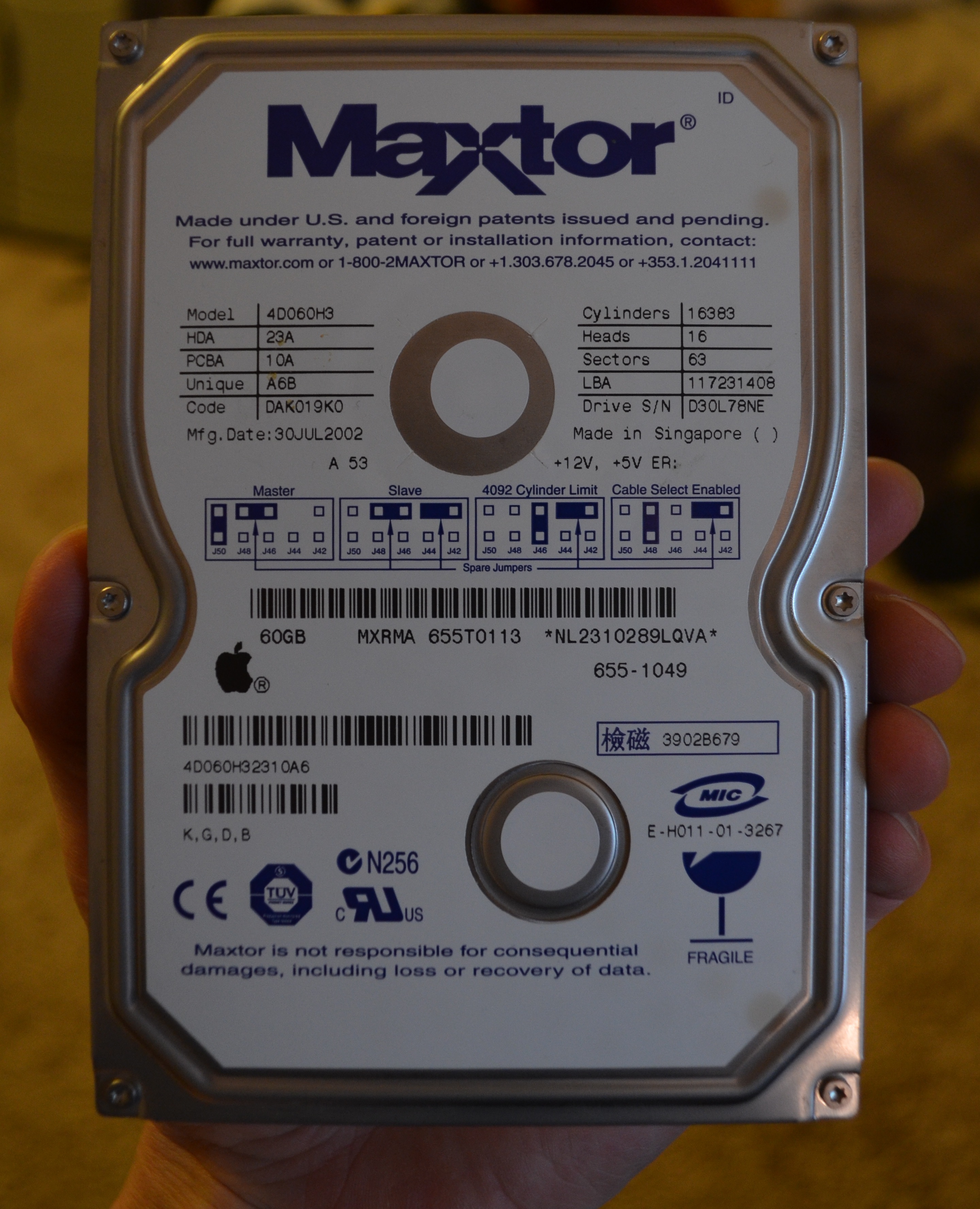

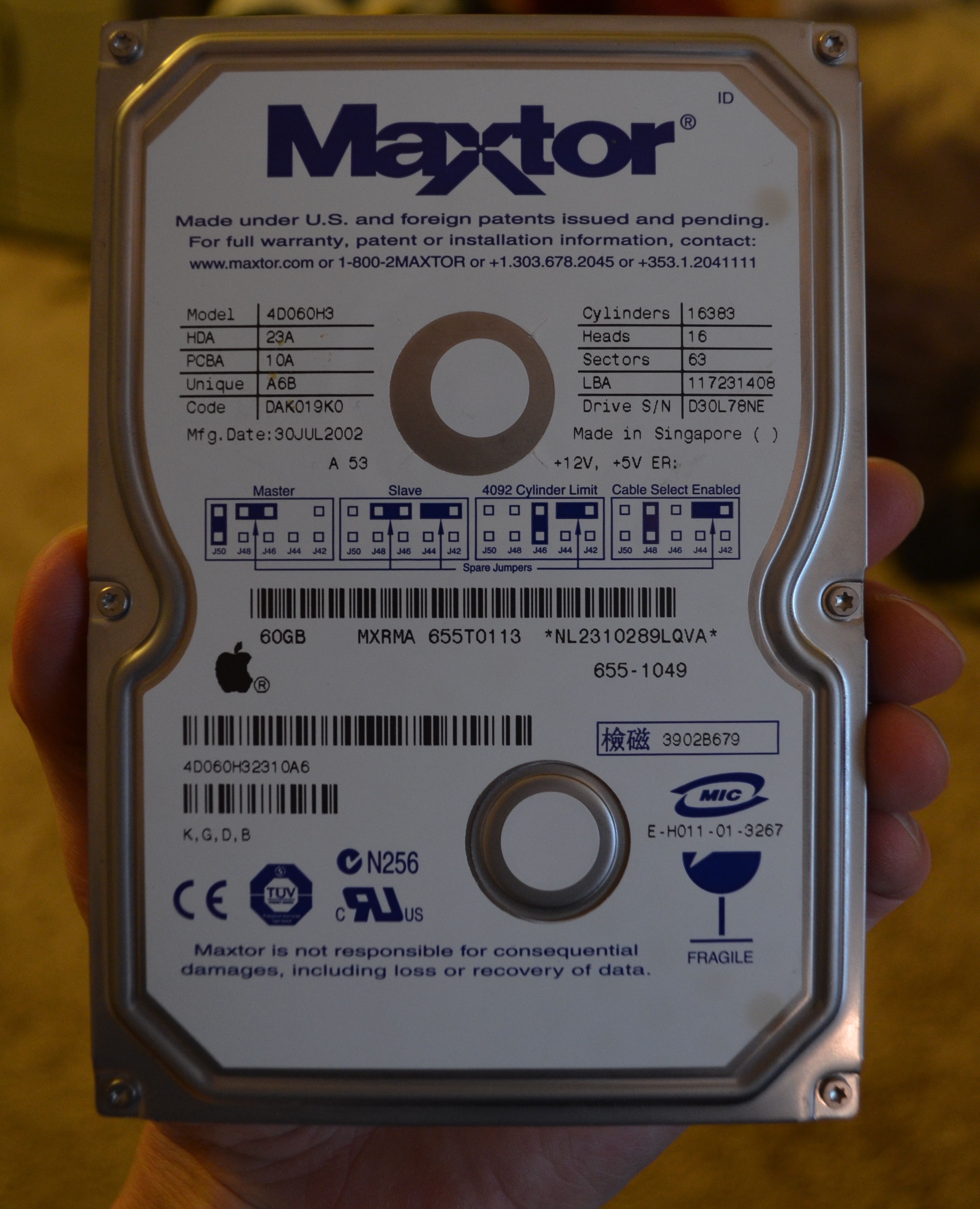

...and a (significantly more hefty) 3.5" 60 GB HDD salvaged from an old no-longer-functioning eMac...
For clarity's sake, I will refer to these drives hereafter as the Xbox HDD, and the eMac HDD.

1) How do I turn these HDDs in to external HDDs? That is, do they need to be wiped, formatted, or whatever before they can be used, and how do I do that?

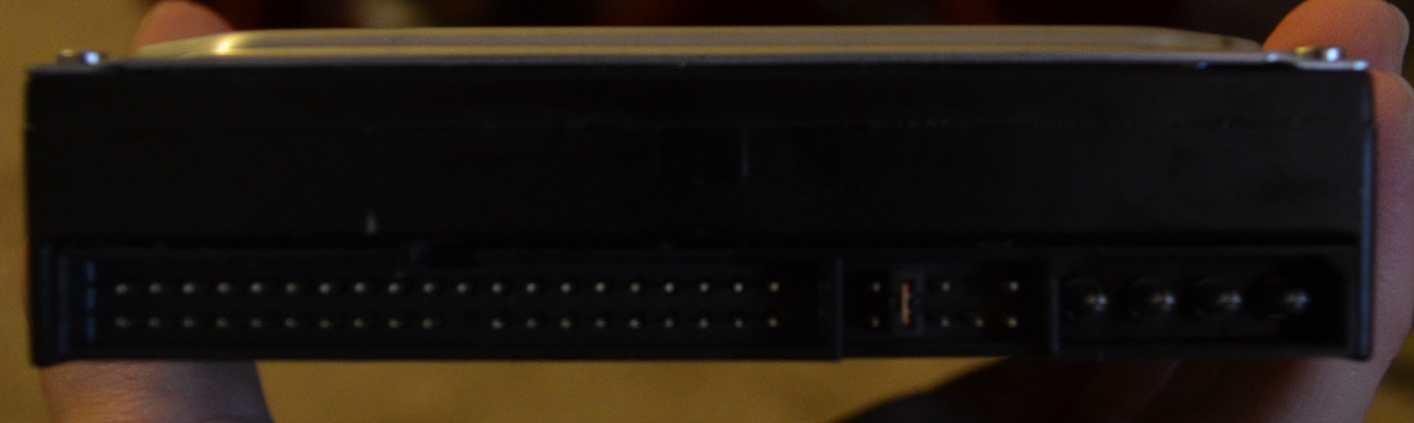

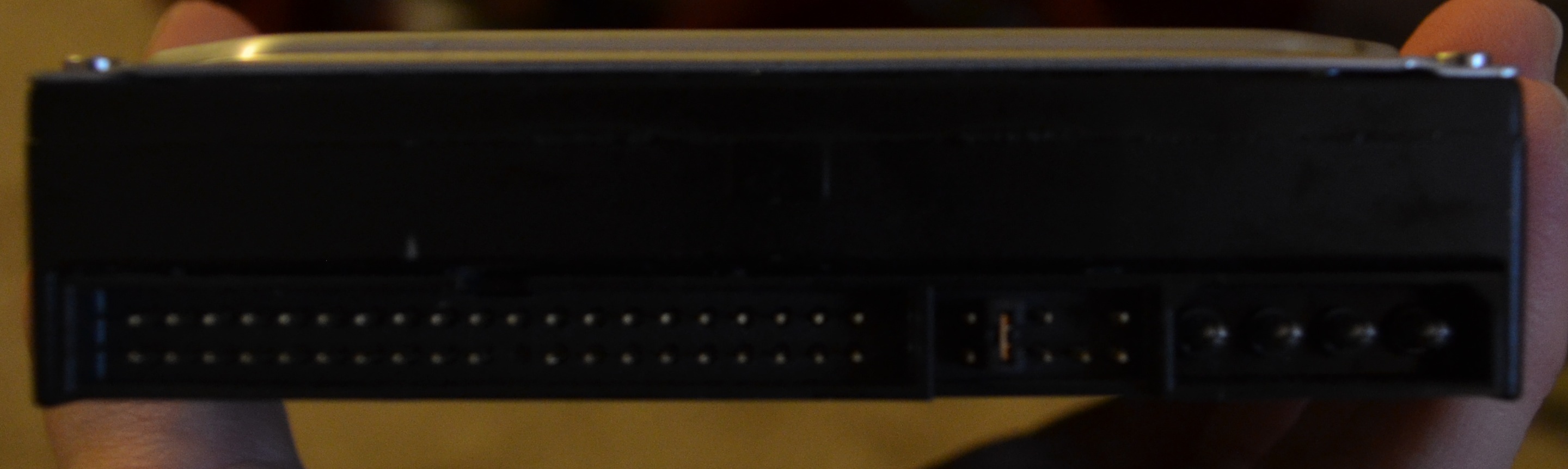

2) How do I connect either of these things to my computer for any purpose? A preferable connection to the computer would be USB 2.0 or whatever's most practical. The Xbox HDD appears to be equipped with "Serial ATA" ports for power and data, but the eMac HDD has ports I really can't identify but have pictured here:

The other answers have given you good ideas, but I don't think any single reply has considered all the issues you have.
  1. One of your hard drives is 3.5", and the other is 2.5". Therefore, if you want a single solution for both, you'll have to make sure your dock or enclosure is compatible with both sizes.
  2. One of your hard drives has a SATA connection. The one you don't recognize is the retroactively named PATA, originally called ATA, and frequently called IDE (an old Western Digital term). Again, if you want a single solution for both, you'll have to find one compatible with both interfaces.
But to answer your question in general, in order to use them externally, you'll need either an enclosure or a dock. While a dock is probably cheaper, an enclosure will give you more or less something like external HDs that you're used to. I assume they're also a bit more rugged and more suitable for long-term use than a dock (which personally I'd only use on a temporary basis; I don't have any data to back up these claims, but I don't think I'd be comfortable just leaving an exposed HD sitting out plugged into one of these).
You also mention a single cord. For that, you'll need to be sure to find an enclosure (or dock) that is completely USB powered rather than requiring an external power supply. Those are a bit harder to find, especially for 3.5" drives. To get everything you're looking for with both drives, however, you'll probably need two separate enclosures since you're unlikely to find all of these features rolled into one--and, of course, you'll also need two if you want to use them both at the same time. 😀
I'd recommend looking around for docks or enclosures (like I said, I'd prefer the second for long-term use) within your price range that fit your specifications (bus powered only, compatible with the desired size and interface, etc.) on Amazon, NewEgg, or wherever you prefer to shop.
