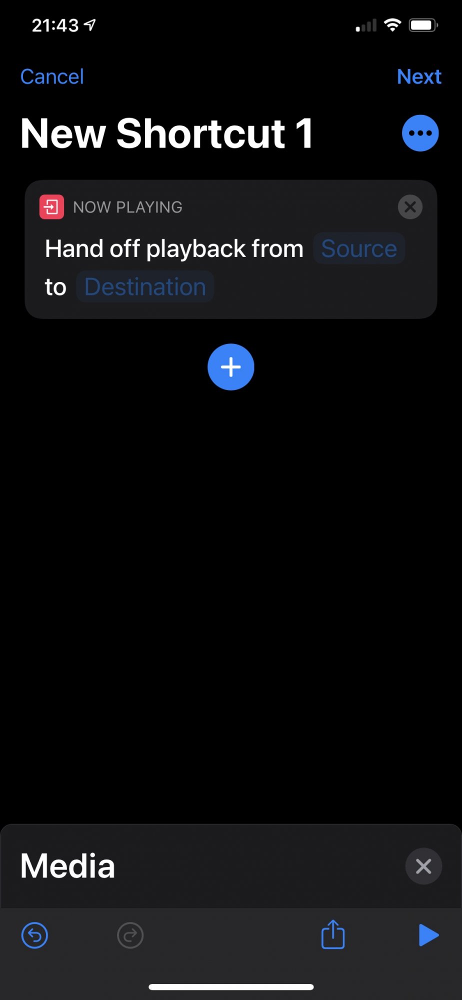

Go to the media section in Shortcuts and use “Handoff playback from”
The select the source from AppleTV to HomePod

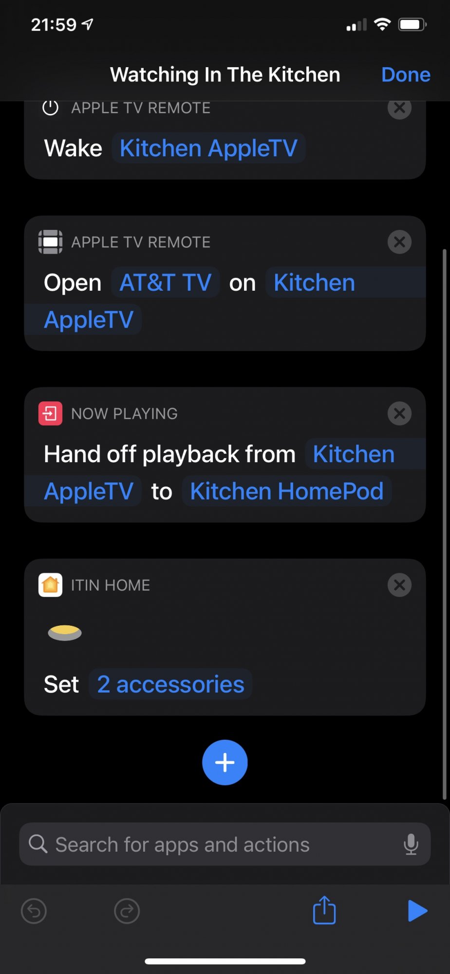

This is a quick scratch Shortcut but something like this. I added some stuff like opening the remote, opening AT&T Now on the ATV, etc...

Hmm, I tested it a few times before I posted and it works fine on my end. Do you have the AppleTV playing music before you initiated the shortcut? You have to have the ATV app running the app you want first (AT&T TV in my case) in the Shortcut flow. I’ll play around with it some more on my end using different scenarios and flows.

No worries and damn, sorry to hear that. Something is causing a conflict with the Shortcut action. Wish there was something else I can recommend trying but it’s working on my end. I’ve been using this type of Shortcut for a while now to do exactly what you need for a movie scene. I even have an action to set the HomePod to a certain volume level.
