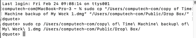

Hello bogdanw,
The codes are looking promising.
But they need some adjustment.
Using the first code Terminal responds with:
dquote>
Using the second code Terminal gives the same response:
dquote>
Please see the attached screenshot, where both codes have been used.
Sorry, I must have copy-pasted with formatting
Code:
sudo cp "/Users/computech-com/copy of Time Machine backup of My Work 1.dmg" "/Users/computech-com/Public/Drop Box"
Code:
cp /Users/computech-com/copy\ of\ Time\ Machine\ backup\ of\ My\ Work\ 1.dmg /Users/computech-com/Public/Drop\ Box

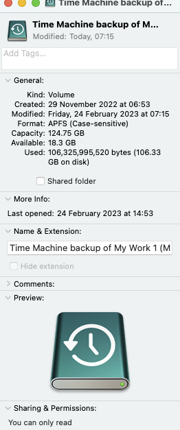

Hello bogdanw,
I have tried drag&drop in Finder, but it sems that Time Machine backups are Read Only. See attachment.
I also tried copying to a Sparse Image, but the Read Only Sharing & Permissions prevented that.

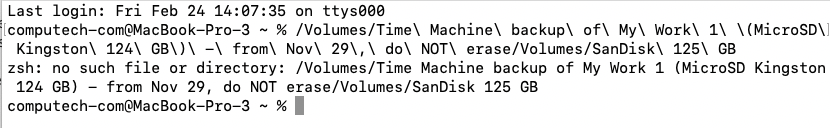

Anyway, I have now tried what I should have been doing. I used the code you provided, and modified it to make the copy.
The code I used is:
/Volumes/Time\ Machine\ backup\ of\ My\ Work\ 1\ \(MicroSD\ Kingston\ 124\ GB\)\ -\ from\ Nov\ 29\,\ do\ NOT\ erase/Volumes/SanDisk\ 125\ GB
No matter what I tried I always get this Terminal response:
zsh: no such file or directory: /Volumes/Time Machine backup of My Work 1 (MicroSD Kingston 124 GB) - from Nov 29, do NOT erase/Volumes/SanDisk 125 GB
computech-com@MacBook-Pro-3 ~ %
It is saying: MacBook-Pro-3, because I have three MacBook's all open at the same time. So each one has been alloted a suffix 1, 2 or 3.
Any idea why the code is not working?
