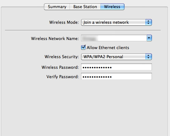

Your Airport Express should be able to do this, and you should not have to create a WDS. You should be able to simply Join a network and then share the ethernet.
If you old Airport Express (g) can't see the newer (n) one, take a look at what kind of network you have set your (n) to transmit. Is it N only? 5ghz instead of 2.4ghz? Your older (g) won't be able to see or connect to an N 5ghz network.
I've attached a screenshot of how mine (hooked up to a ps3) is set up.

My wireless g airport express does not have the allow Ethernet clients checkbox.
It's possible that the OP might have an AE that works with your method, maybe not.
