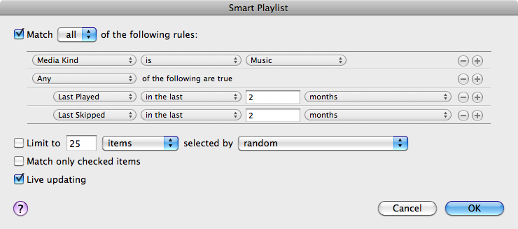

Open your "Edit Smart Playlist" window, take a screen shot and post it.
Here it is. Should it be match any maybe? Match all makes way more sense though...
Edit: yeah, match any didn't work at all. It just got everything that wasn't music and a ton of other stuff added to the playlist.

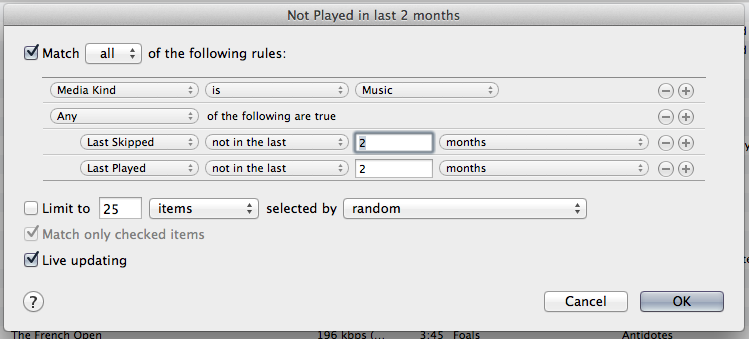

It should be like this:

Thanks although that still didn't fix it. Now the songs stay in the playlist even if they're played through until the end or skipped...
I've attached a screenshot incase there's one thing I just can't see that I'm missing.
I think if I "match all" it's only including songs that have both been not skipped and not played. Therefore they won't disappear from the playlist unless I've both played and skipped them.
If I "match any" I think it's also pulling everything because even though it's matching one criteria it doesn't have to match the other one.
There has to be something I'm missing because there has to be a way to just not include anything that's been played or skipped recently.

Change "is not in the last" to "is in the last"
