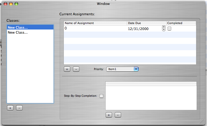

Alrighty guys, thanks a bunch for your help! I took your advice and read up on Core Data, and it's definitely what I was looking for. It's very easy to learn, but I'm having a problem with some bindings in a new (and much more complex) app I'm now working on. I'll keep it short, so...
I have this Core Data app that has two entities, Class and Assignment. The TableView on the left is bound to the title property of Class, and works just fine. What doesn't work is the top/right TableView, which I want to update when you change the selected class. How exactly should I do this? I've tried a bunch of combinations and nothing seems to work. Either I can't edit the name, or all the classes have identical assignments, etc. I guess when the selection of Class changes, the Assignment entities for the selected Class entity should show up.

Alright, I see what you're saying with the arrays, it's kind of like the RaiseMan example in the book. Your method doesn't use Core Data though, is this correct? It appears to be a couple arrays that simple grab content from one another. While I'm sure this method works fine, I was hoping to build a database app like the one in the screenie completely atop a Core Data foundation.
I'll scour the web a bit to see if there're any solutions, but thanks a lot for your help, I'll keep it in mind incase I don't find anything. 🙂

Ya, I searched around a bit and found an amazingly detailed, simple, step-by-step tutorial from Apple. Every step is a video, so if there's part of it you're stuck on you can just watch that one part. Helped me figure it out!
Link
