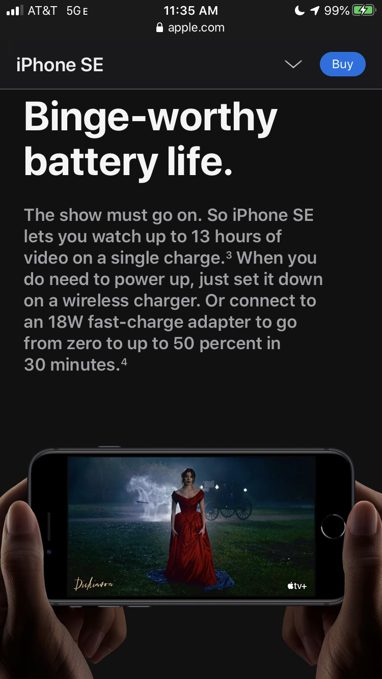

Doesn’t the iPhone SE support 18W charging? Just going off Apple’s website I believe it does, but does it Top Off at 12W? I legitimately don’t know and was under the impression that it supports 18W charging.
No one's done any comprehensive tests yet but I've seen mention of 13W power draw from the wall. Charging the iPhone XR and 11 with 18W USB PD usually draws ~19.6W from the wall, not 13W.
The thing is with a small 1821 mAh battery, you don't really need 18W to get to 50% in 30 minutes which I'm guessing is Apple's definition of fast charging.

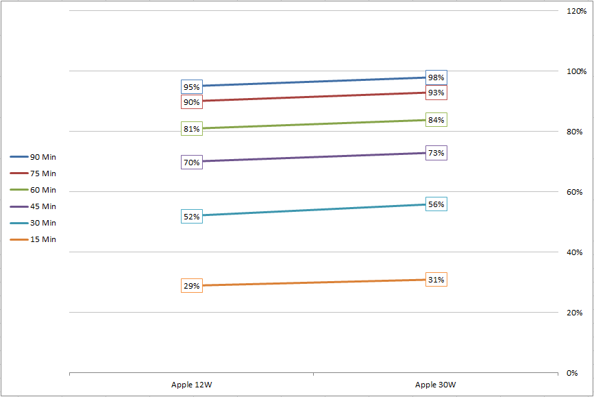

Results for initial testing with Apple 12W charger (included with iPad) and Apple 30W USB-C PD charger.
I still need to do 5W and the Anker. Draining the battery takes longer than expected. With GeekBench 4 battery test, no dimming, 100% screen brightness, it takes over 3 hours to fully drain the battery. First time, I allowed the screen to dim and it took over 4 hours 20 minutes to drain.
Based on these initial results, I don't think it's worth buying a USB-C PD adapter and a proprietary USB-C to Lightning Cable just for the iPhone SE2.
If it was charger only, I'd say go for it but you need both adapter and cable. Lightning is a proprietary standard and even iPads have started to move away from it so not particularly reusable unless you have other devices that can benefit (e.g. iPhone XR or newer, iPad Pro 12.9 1st & 2nd gen, iPad Pro 10.5, iPad Air 3). On iPads, the 18-30W charging makes a huge difference since those tend to have ginormous batteries.

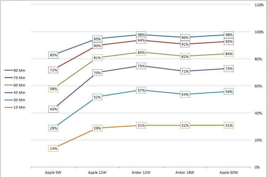

Complete set of tests. I think the differences between 12W and 18W charging just falls within the margin of error here.

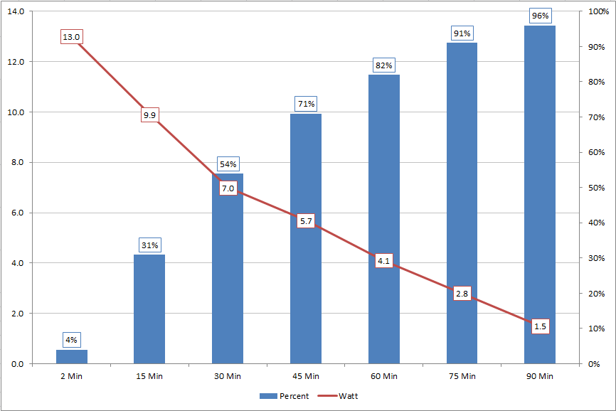

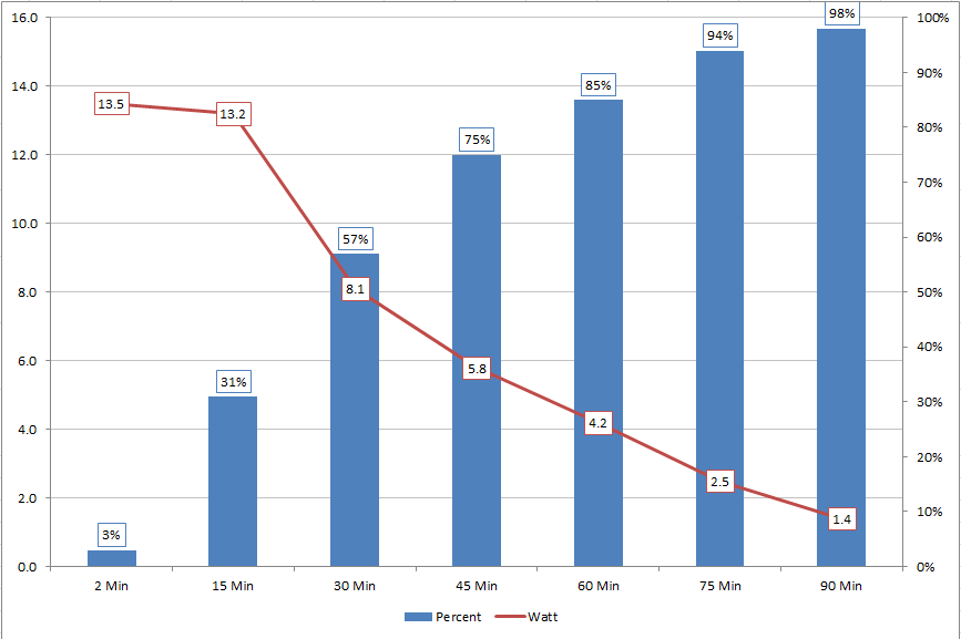

I remembered to use the Kill-A-Watt for the Anker PowerPort PD2 (last two tests) so I have power draw measurements from the wall for Anker 12W and 18W. I find it interesting that the USB PD protocol dropped off more quickly compared to the Apple 2.4A.
Anker 12W
USB-A to Lightning
Anker 18W
USB-C to Lightning
