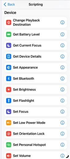

Unfortunately, there is no way to toggle the “Hey Siri” feature on and off using either Shortcuts or Automations. Below is the complete list of device commands currently available in Shortcuts:
If there were such a command, you would trigger it by using the “When connecting to Bluetooth” automation trigger.
