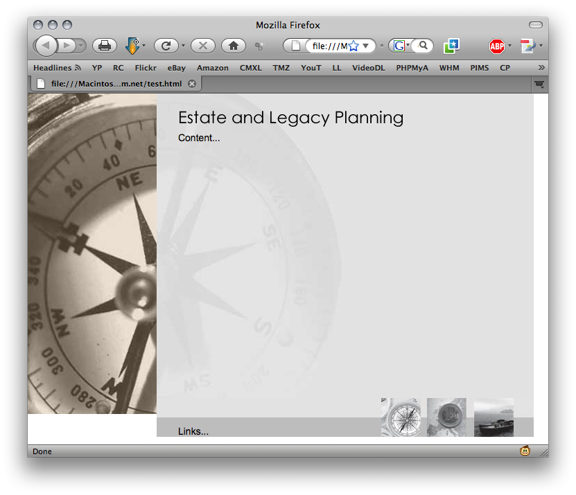

Best to show you an actual example of div's and CSS. I took a few minutes to create a test page that mirrors your compass layout below the headers, using your actual images...
Create a file called styles.css containing:

Then create an test.html as follows:

Use the above example to see how CSS and div's work together such as how wrappers are used, float works, bottom alignment for the footer, background images and styling the <p> tag so it aligns content properly for your site. The whole point is all styling is completely separate from content, just edit the stylesheet, and notice how little HTML was actually used.
Note:
Apply this to your existing code, replacing the tabular layout below your header, if you like the way it looks. Tweak as you see fit, this is obviously using your actual images on your web server which is why I used the full URL for all background-images. On the production version remove all instances of "http://fusedm.com/" in your stylesheet and use relative paths instead. This layout was only tested in FFox, I wrote it quickly, pardon any mistakes - it's just a starting point for you, not a "final".
Enjoy.
-jim
Here's a pic of the above code in action...

As I noted, that's just example code to get you started if you opt to switch to div/css and not use tables and cells for layout. If so, create your header/nav bar stuff in the same way I created the footer, with a wrapper around each major element and div's inside that hold actual content, including JQuery stuff. Then to center the entire page, put a div wrapper around everything and lookup on Google how to center an entire page (hint: it's NOT "text-alignment: center", nor is it "<div align='center' id='main_wrapper'>" for example). Just use sensibly named id's for all your div's and put all the CSS in the single stylesheet. I coded the example to encourage you to re-write your site, but only if you have the time and the desire.
If you like what I did but can't rewrite the entire site, merge yours and mine via:
1) Backup your existing HTML - you'll need it later
1) use the stylesheet and add the "link" tag which calls the stylesheet into the head section of your HTML
2) In the table you created, in the cell below the header/nav bar stuff, replace your code with mine (i.e. whatever I put between the "body" tags)
3) Copy from the backup HTML all your content, footer links, etc. and put all that inside the appropriate div's - I named them sensibly for you to figure it out
