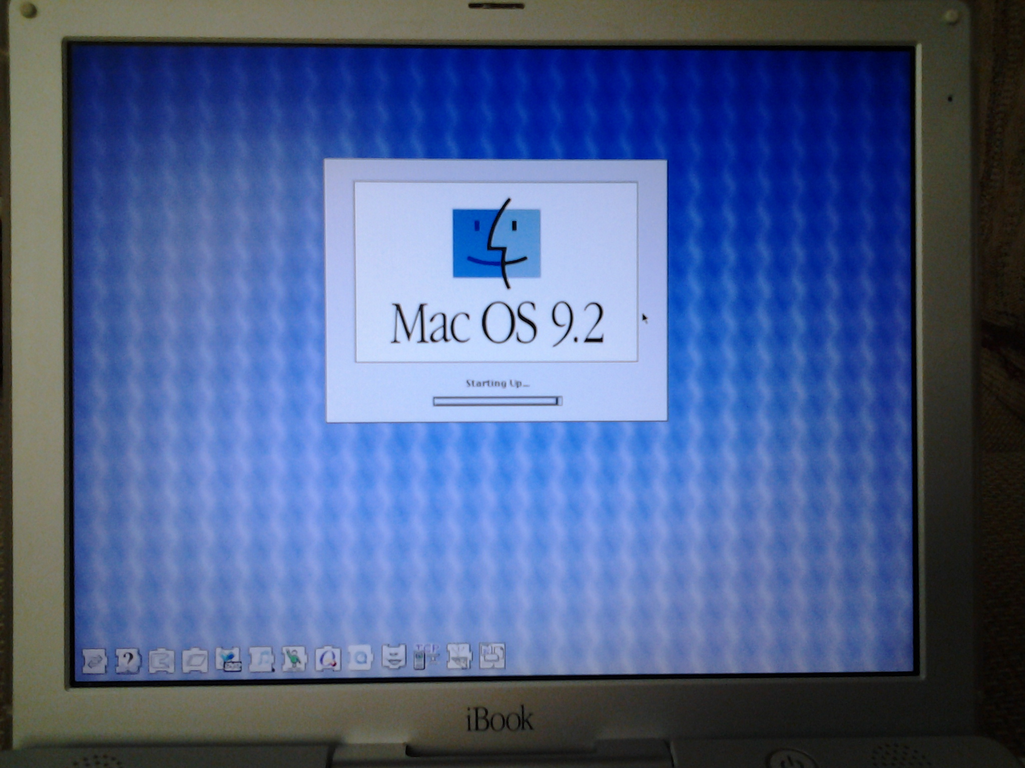

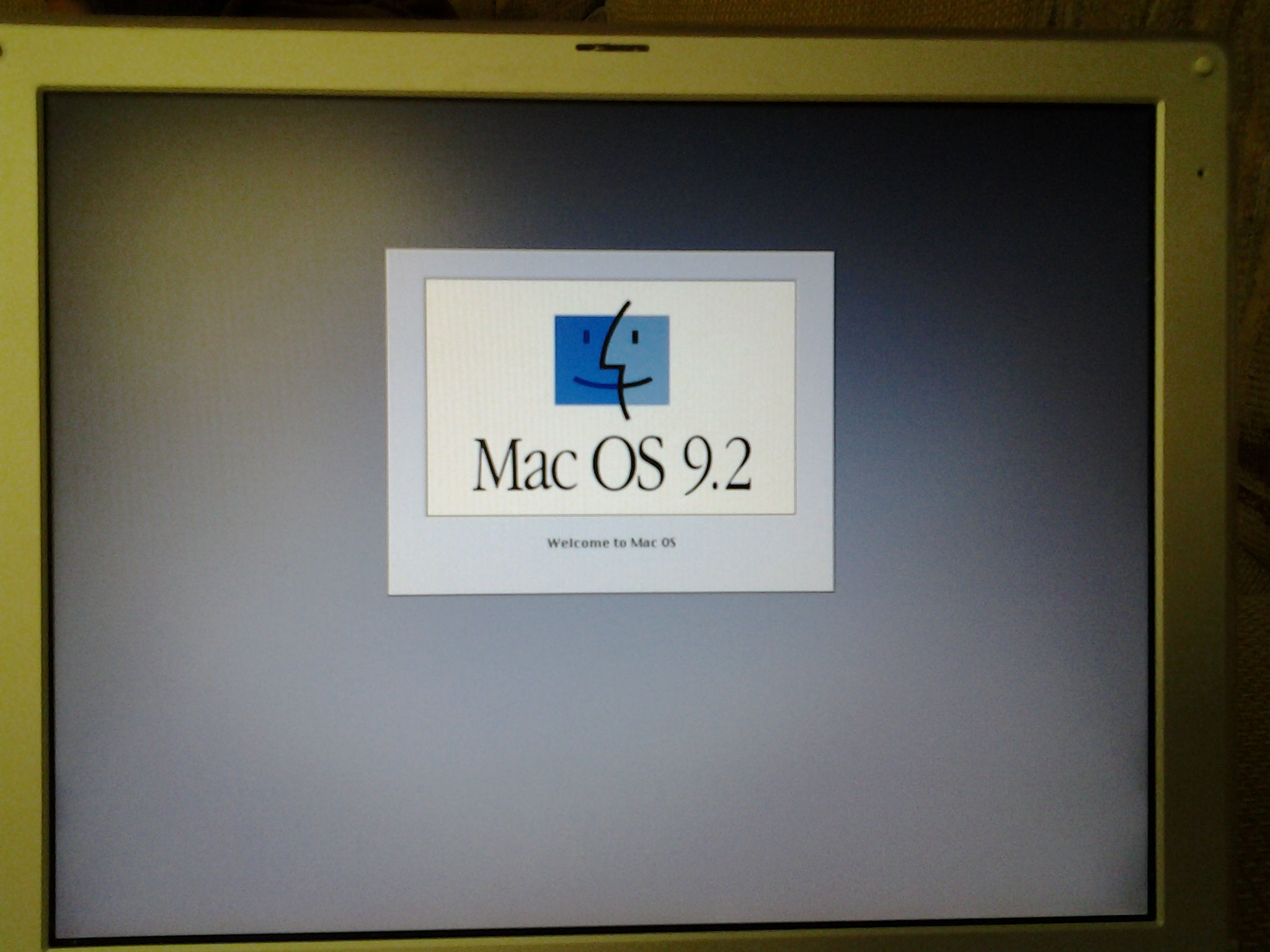

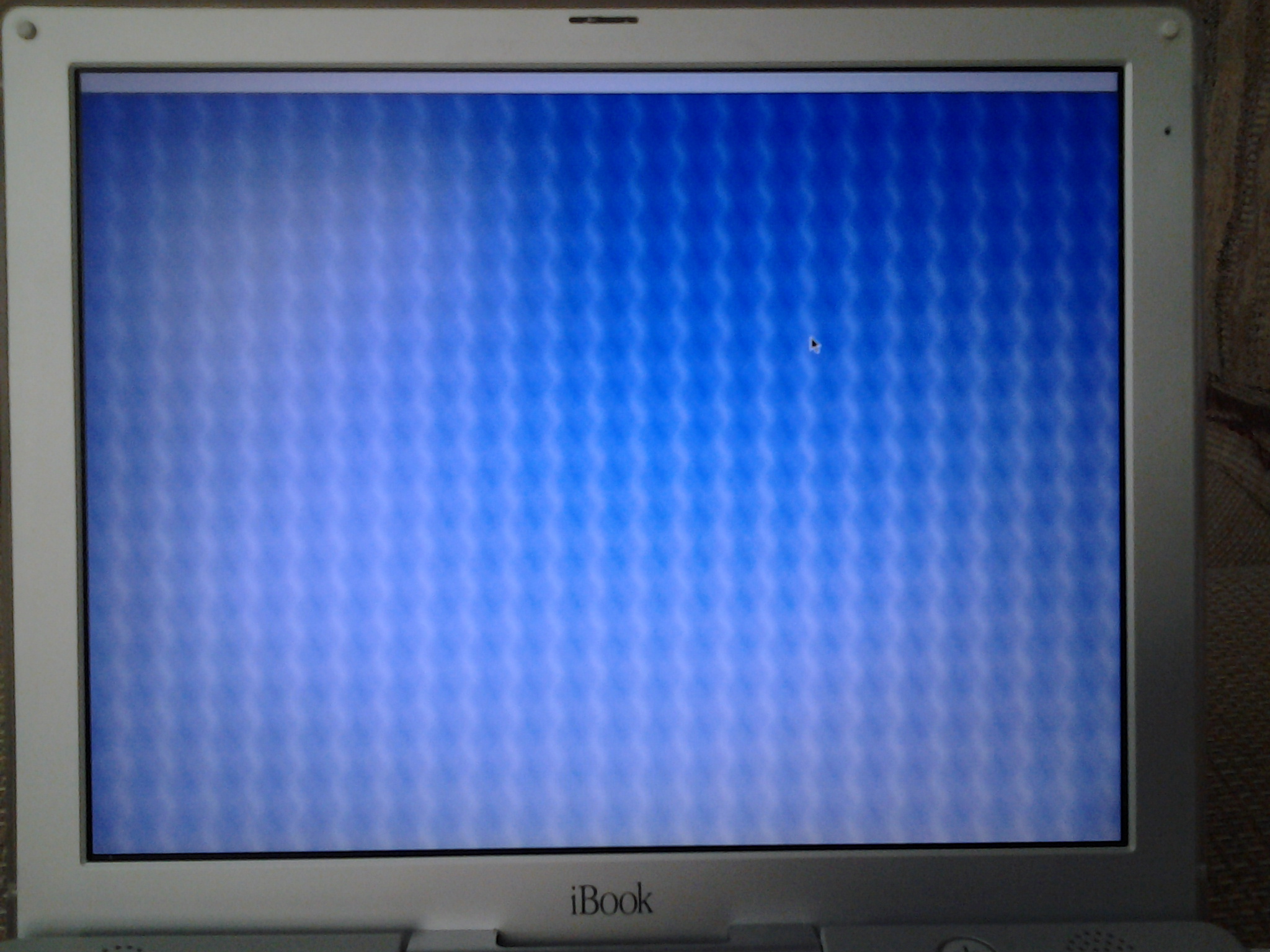

I just picked up a ibook a1005, 20gig hd, 600mhz, 512 mem, with OS 9.2.2 and a OSx disk. This is my first apple notebook, so i havent a clue what im doing.
Here is my problem:

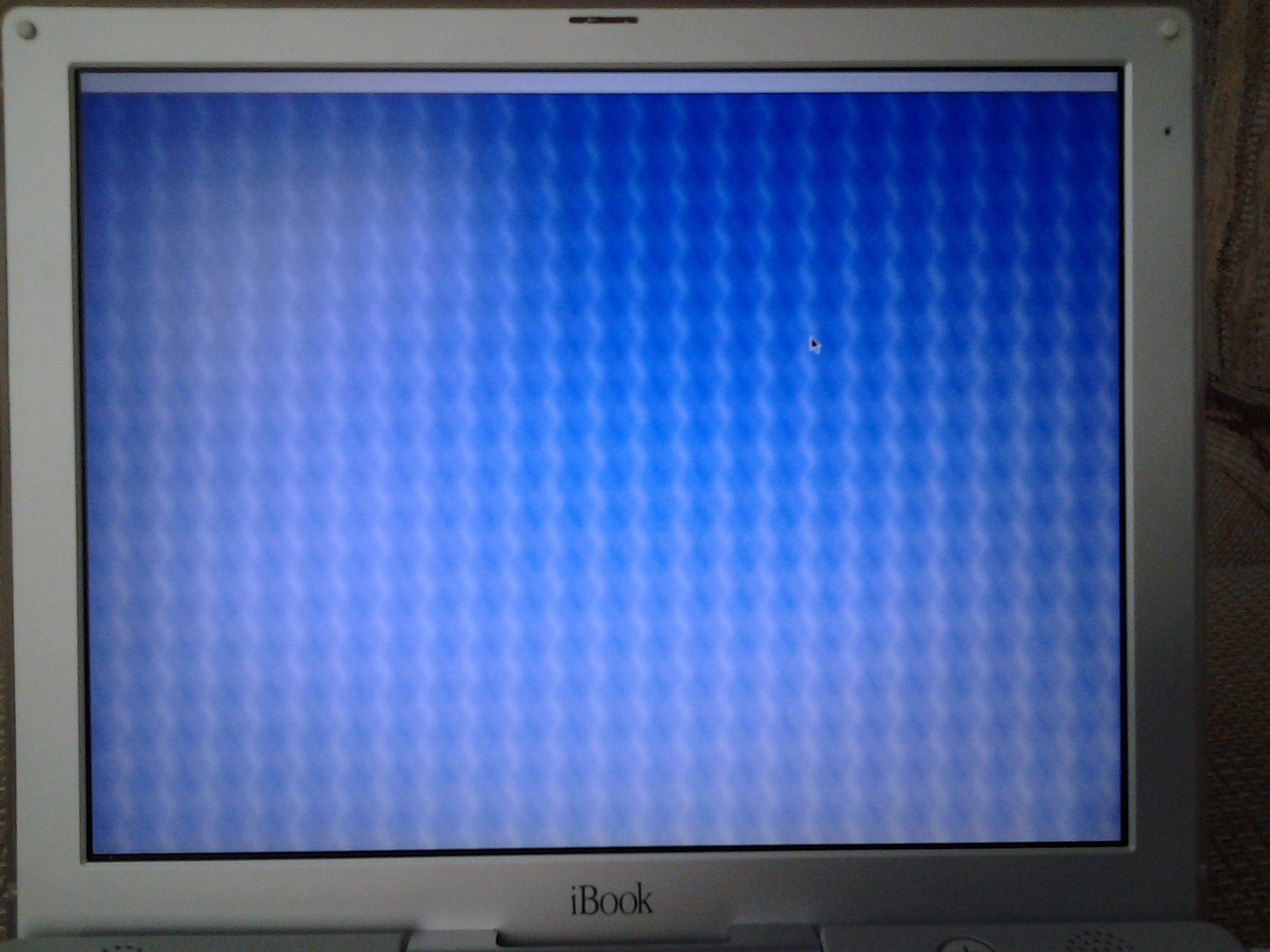

-it will boot up to splash screen, and i see MacOS 9.2.2, then goes to the landing page or desktop. its just a blue background, with wavey lines from top to bottom. from there i cant get anywere. no log on screen or anything. it powers on and off, shortcuts commands work. I have the OSx disk, ver 10.0.1, and one iMac software restore 1 of 4 disks.

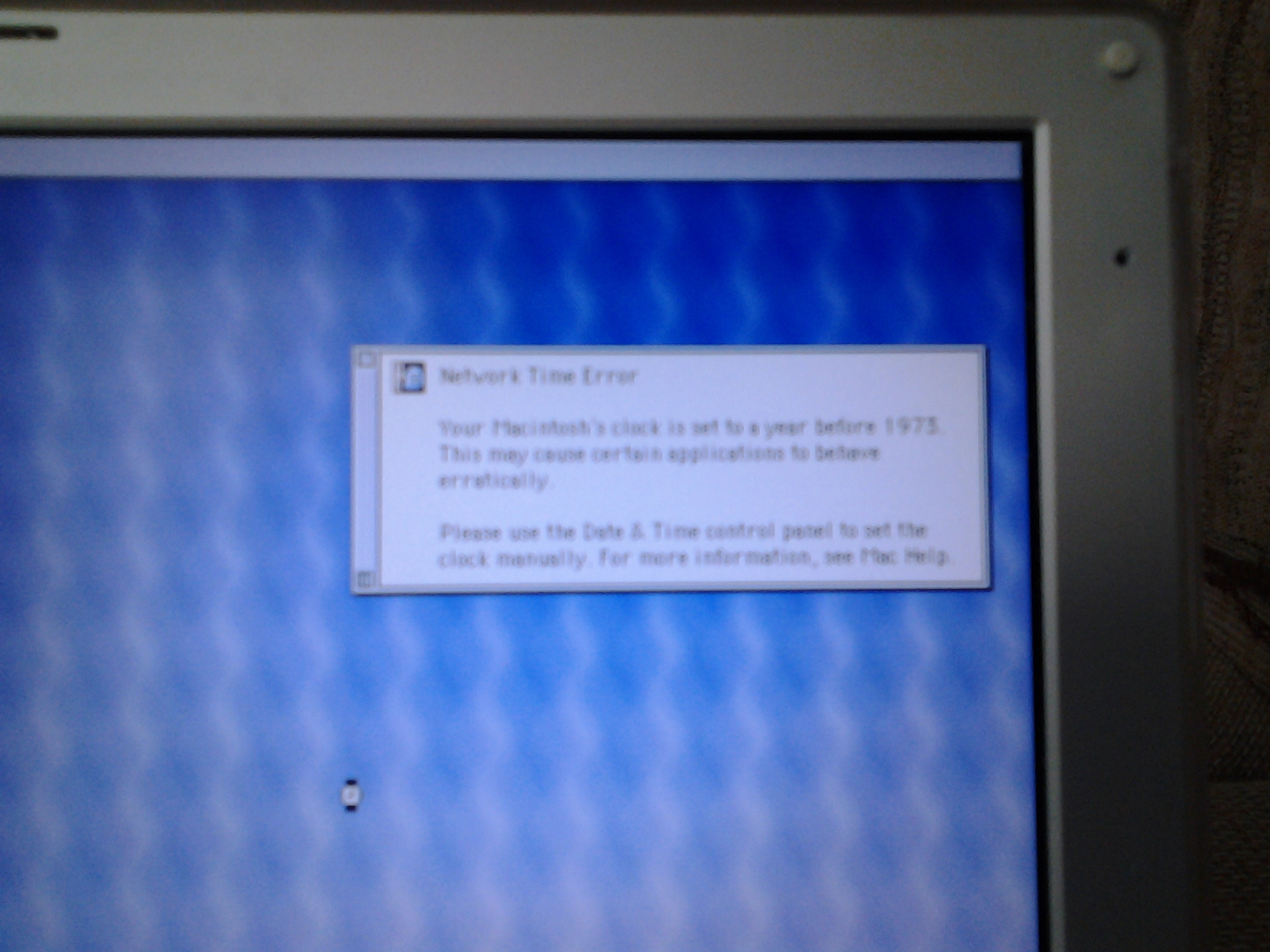

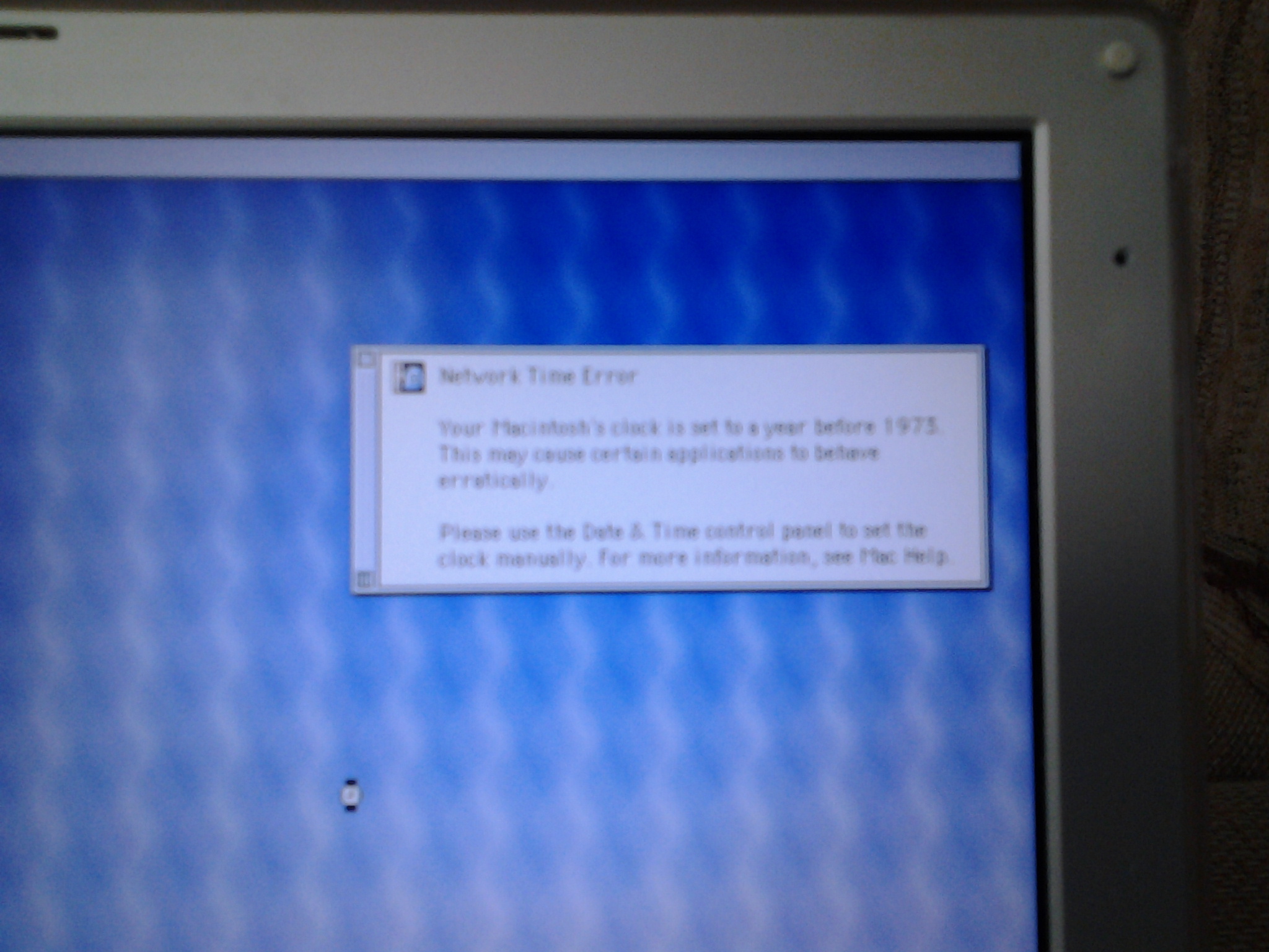

i keep getting a message saying my clock and date is set to 1973 ? is there a way to pull up a command line to correct this error, format drive, and re-install OS ?
Could i just install OSx, without 9.2.2 ?
Tnx.
I hate to pour water on your iBook's problems, but it's nearly eleven years old. It has a G3 PowerPC processor, which is the least powerful among G3s, G4s, and G5s.
From what you describe, there can be any among a number of problems, including the PRAM battery, the logic board, the iBook's main battery, cable connections, and more.
I don't have the time right now to go through a troubleshooting check list with you, but I'm sure there will be others happy to do so.
This correction is getting a bit worn, but iBooks do not have a PRAM battery. If you want the clock to stay and not get that dialog at boot, replace the main battery. Have you tried starting it up with extensions off (press shift at the chime until you see the Finder face).
iBook's don't carry pram batteries.
Nice to see it sticks to some people.

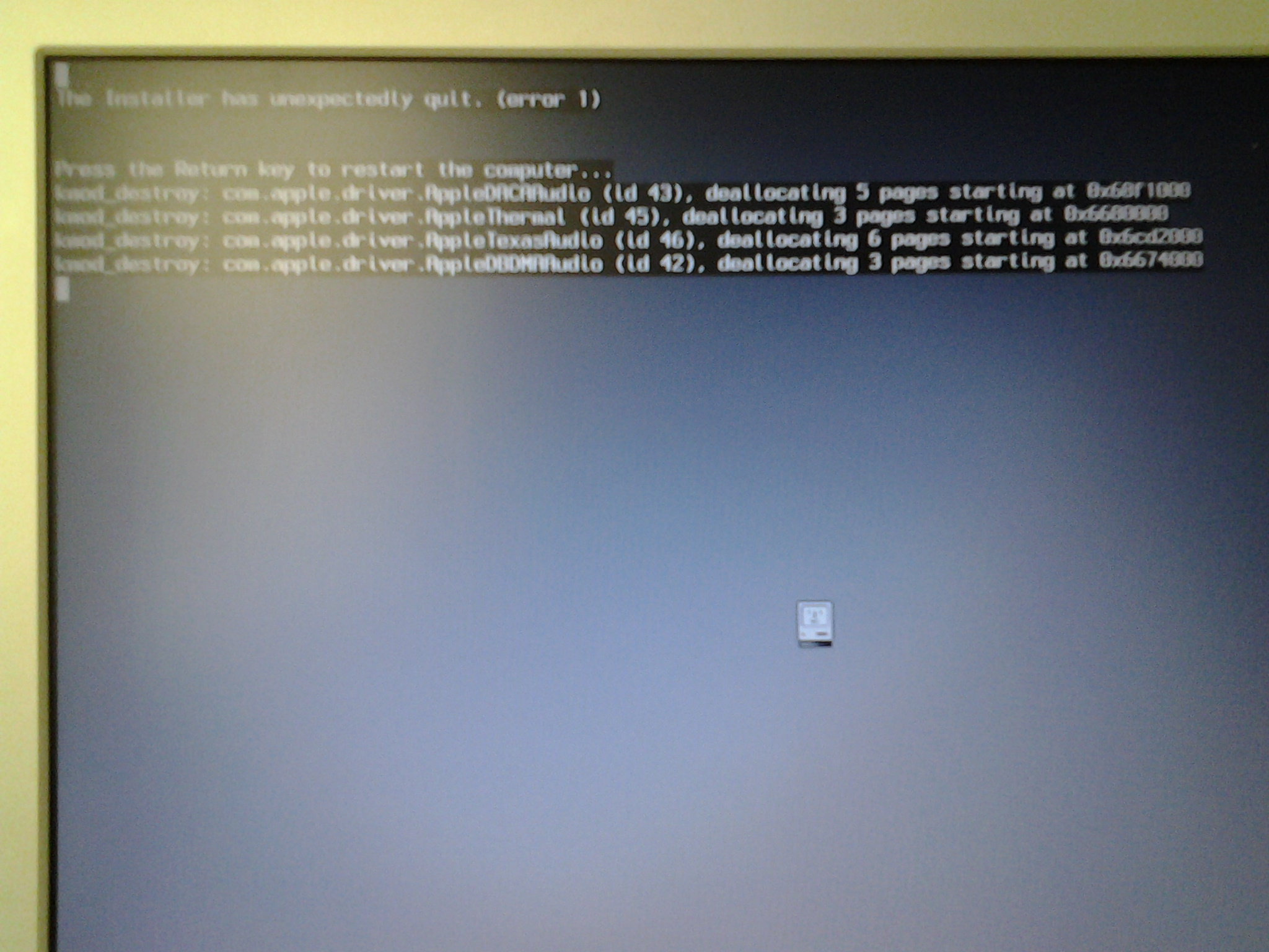

I tried to install OSx, im getting an "error 1" , then it deletes a few files ?

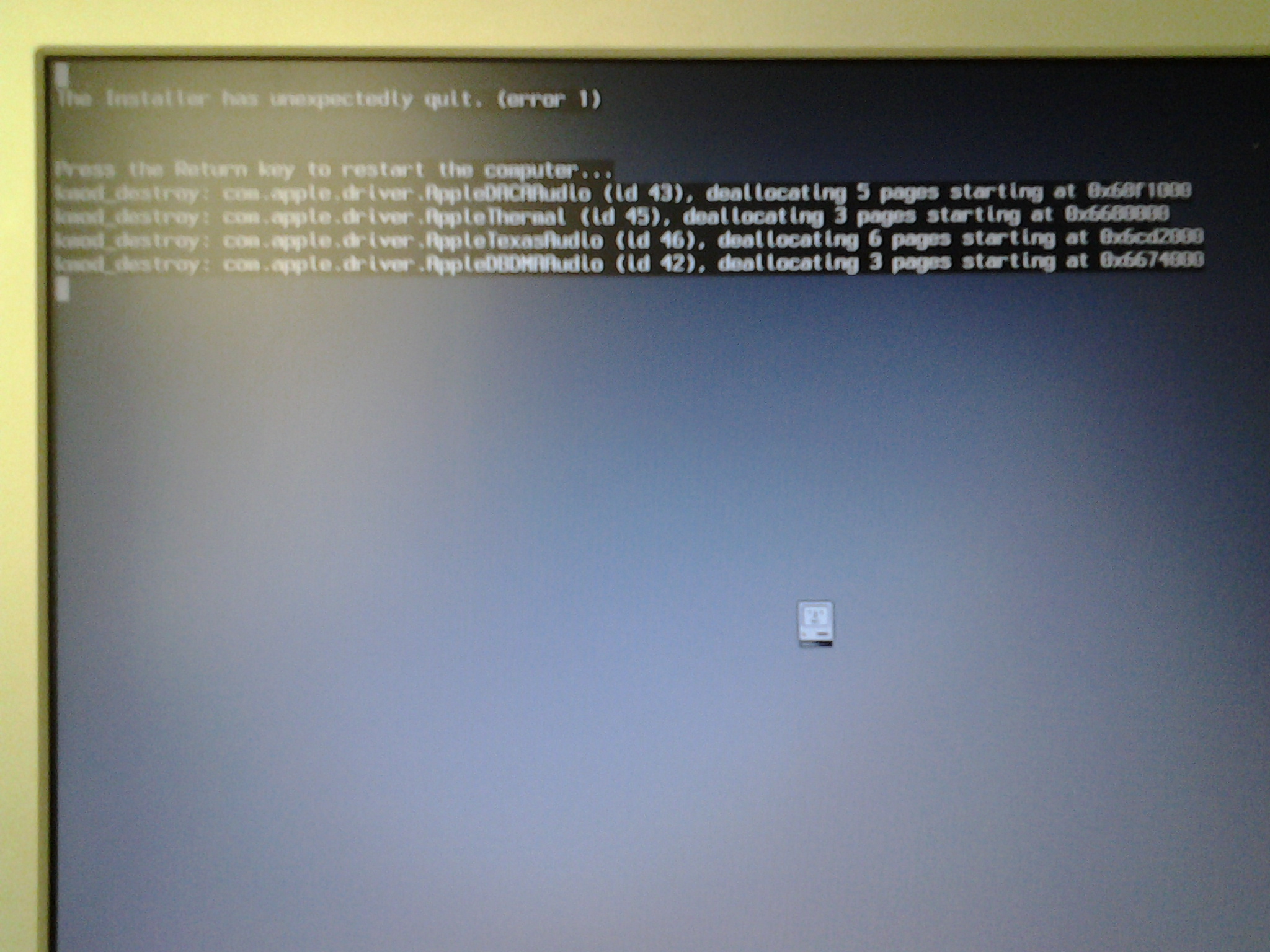

I just tried to install it again. this is the error message i get after a few seconds:
"The installer has unexpectedly quit. (error 1) "
then it goes threw-
kmod_destroy: com.apple.driver.AppleDACAudio (id 45), deallocating 5 pages starting at 0x68f1000.....
and few more of those as follows, then just sits there waiting for any key to be hit, for restart. ???
then it goes threw-
Have you ereased the drive? Many times that is all that it takes.
OK guys. The way I interpreted the first post goes something like this.
The OP booted to the desktop in OS9. The OP was expecting to be presented with some sort of login box as is common with OS X and Windows. But OS9 boots straight to the desktop, unless you install a specific control panel.
The wavy lines from top to bottom I interpret to be one of those wackjob wallpapers that came bundled with OS9. At this point the OP had an operable Mac running OS9.
The OP does not mention he saw a hard disk on the desktop so possibly it wasn't completely booting. But the fact that the OP was getting a Date/Time warning says the control panels were functioning. Shortcuts worked, so I'm led to believe he could at least navigate the OS. Maybe not.
OP, sorry to inform you but OS9 is not Windows. There never was a command line. Trying to find one would have been fruitless.
Next the OP says he has an OS X disk and it's suggested he install OS X. Did anyone catch the fact that it's OS X 10.0.1?!
So, that get's installed and there's an error. OP, the flashing question mark means that the Mac can no longer find a valid system folder to boot from.
I really think you probably want to find a copy of OS X 10.3, or 10.4, which is generations beyond that pathetic version 10.0.1 you have right now. For one thing, it will probably install correctly.

OK. Learning curve time. 😀
If I cover something you already know, bear with me. You have a PowerPC based Mac, which is different than the Intel based Macs Apple started making in 2006. Any format of your hard drive you are going to want it to be formatted as HFS+ (Journaled). That's for OS X.
You can format the hard drive. But you need to boot from the CD/DVD to do so. Put the disk in the drive, and hold down the OPTN key when you reboot. Select the CD drive and click the arrow button. The OS X installer will come up. In the Utility menu will be Disk Utility. Use that to format the drive then go back to the installer and install OS X.

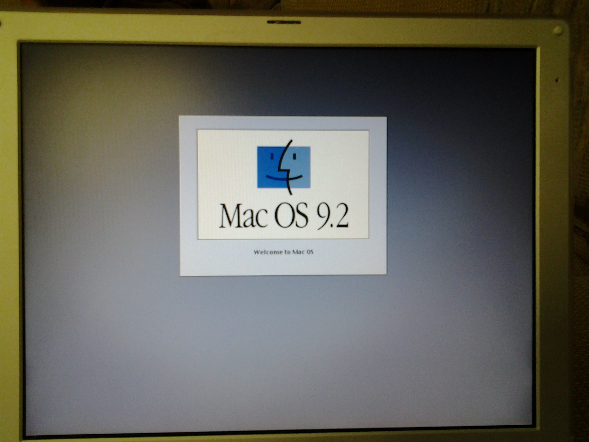

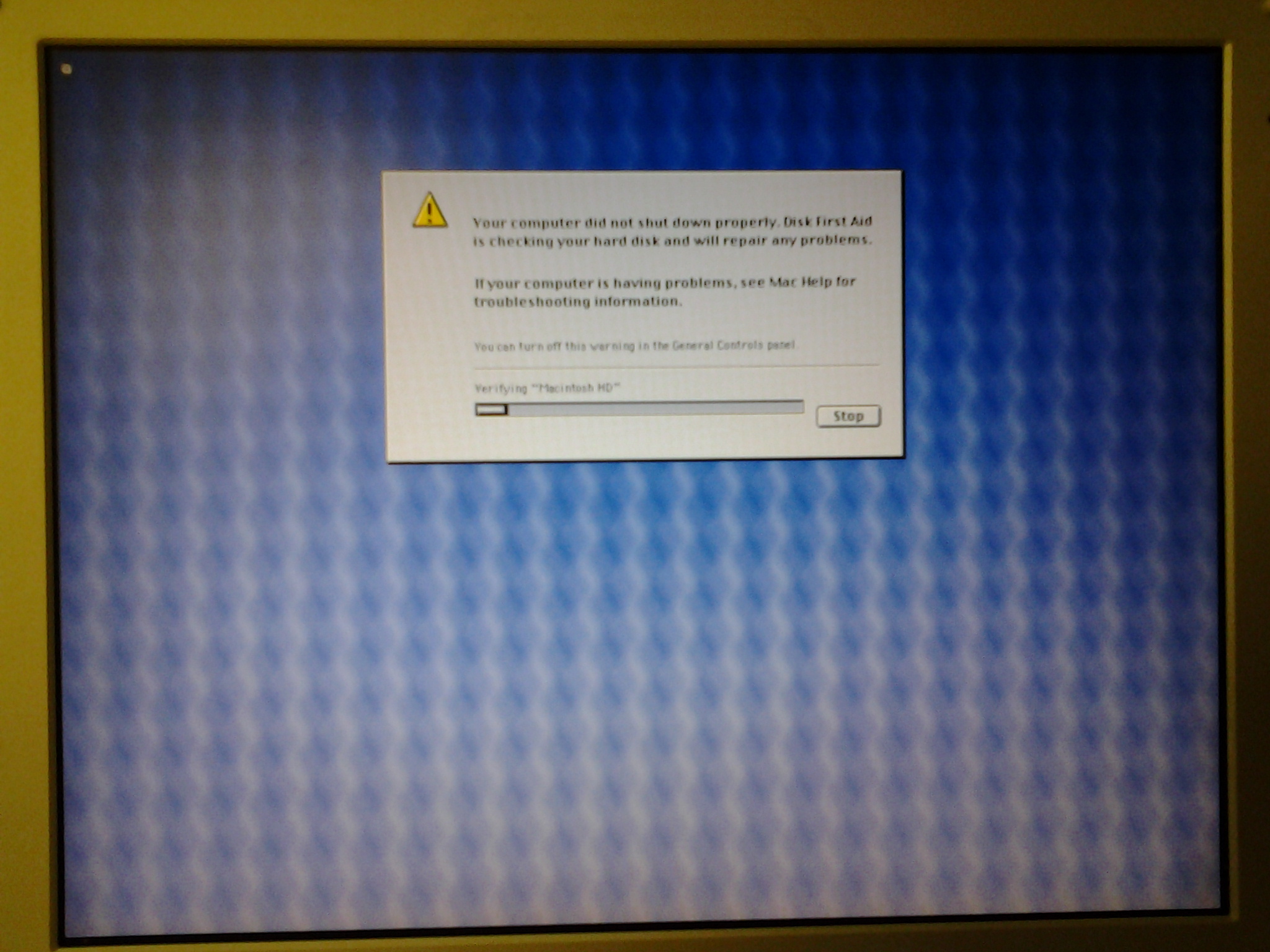

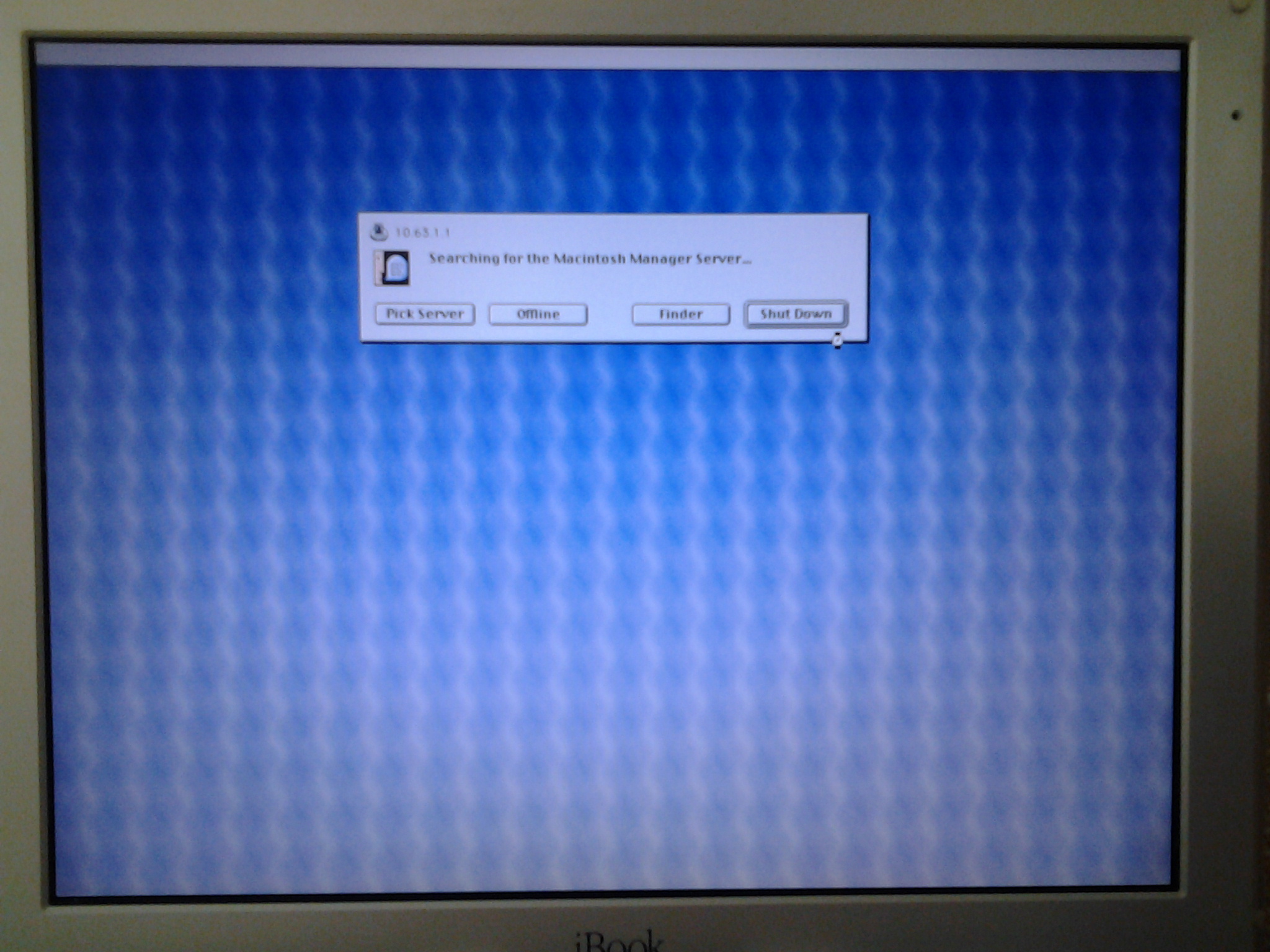

ok, i tried to run the disk with option pressed, and this is the results i got:
after a few mins of what looked like it might be loading, i got error message again in 2nd pic.

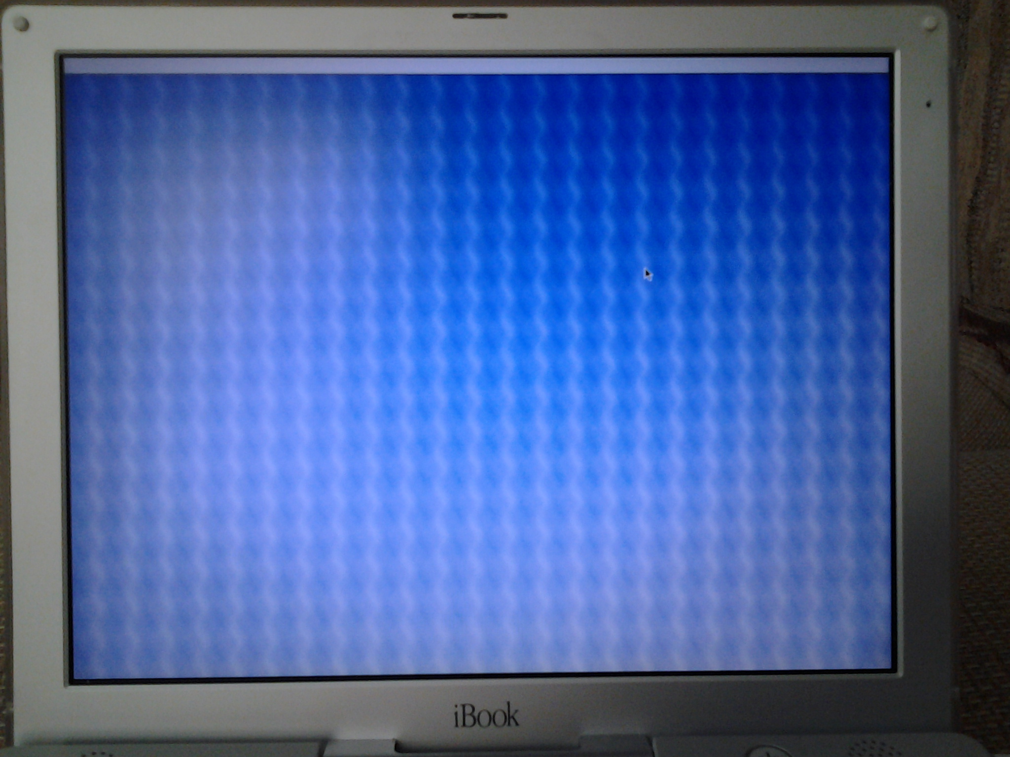

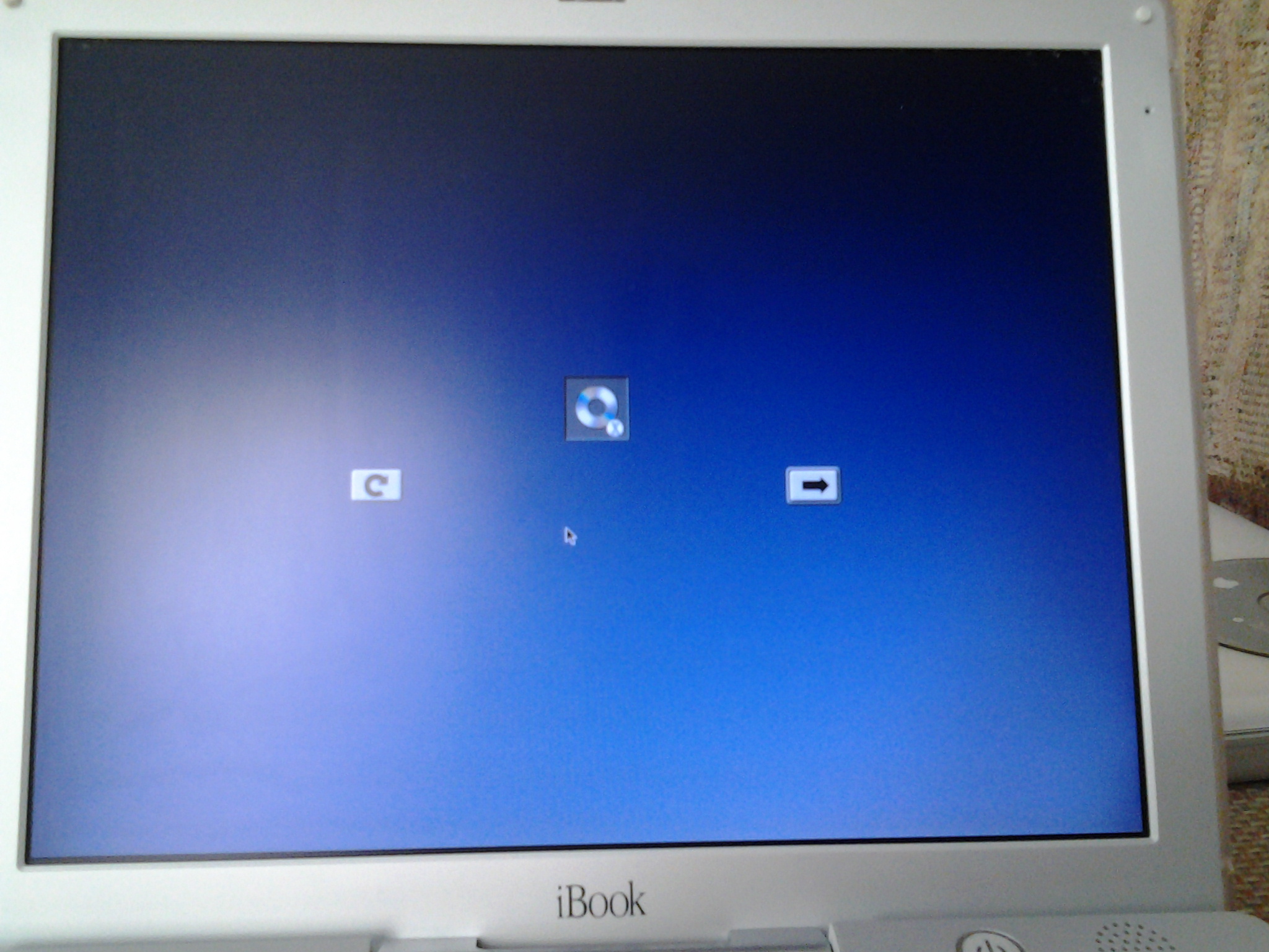

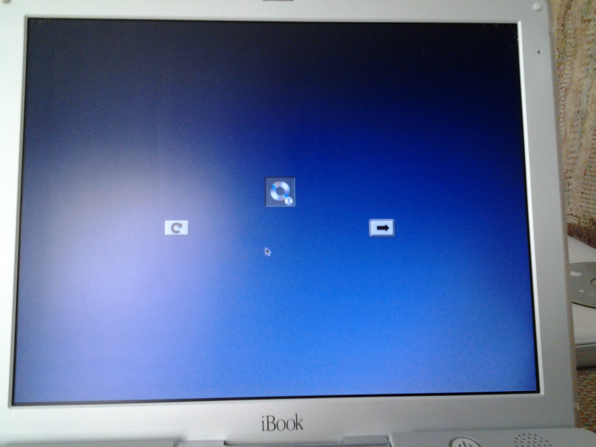

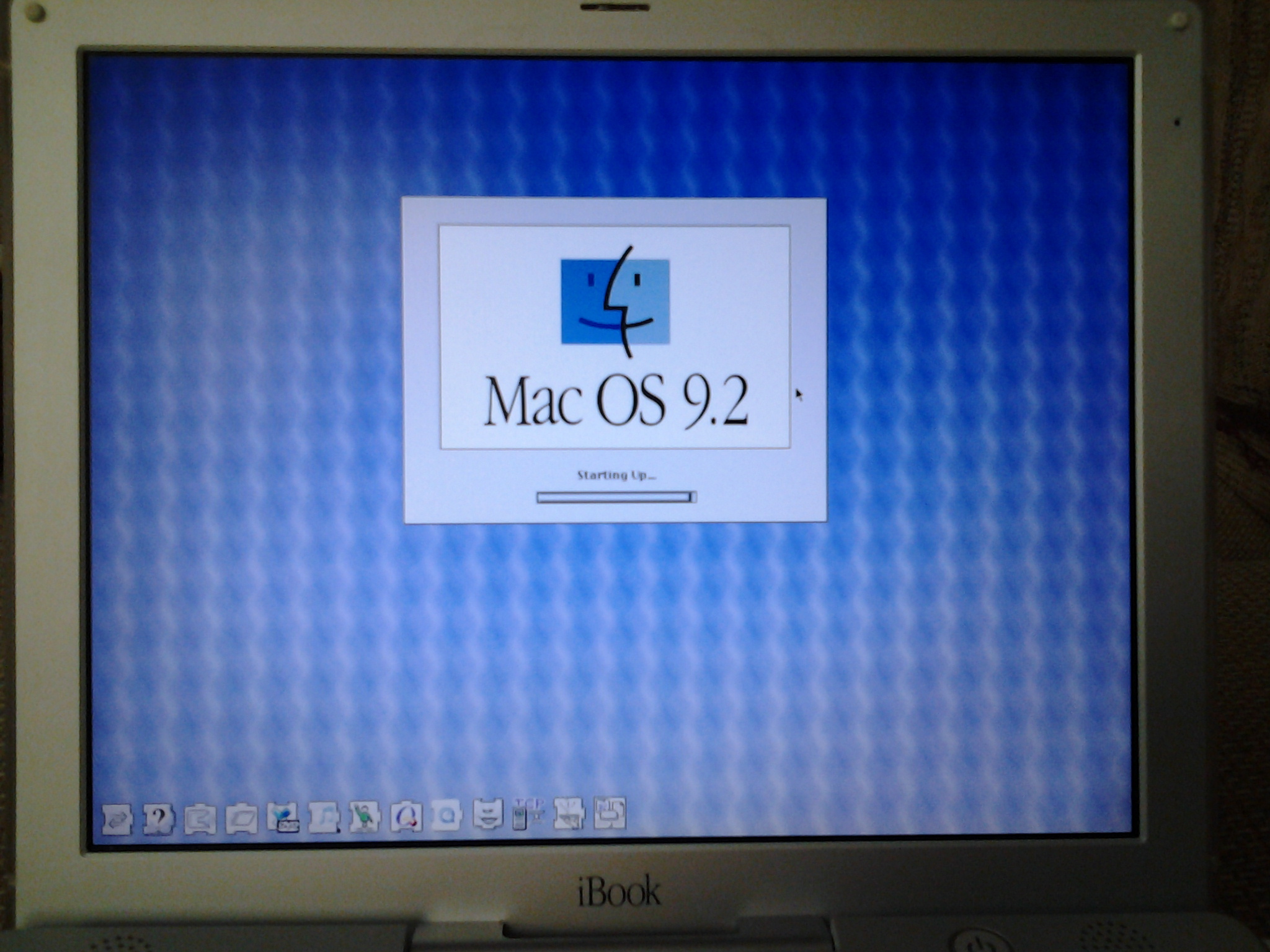

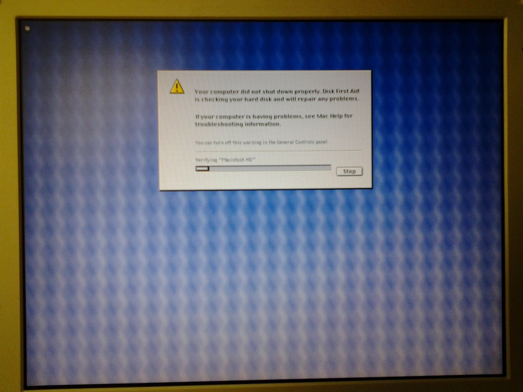

this is what i get when i try to just boot up. please see pics in order of events.
sorry for multi posts, but all the pics wouldnt fit into 1 post.

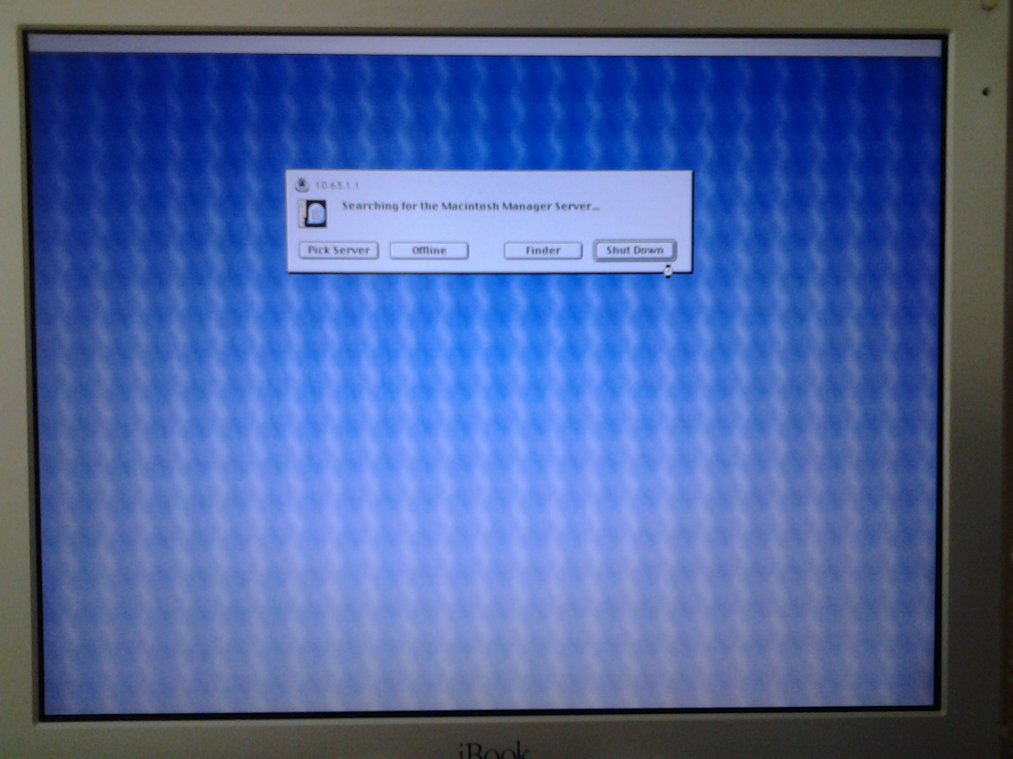

* after a few mins of sitting at the first screen (pic 1) i get this pop-up message, and then it just locks up. i have to hold the power button down to restart it.

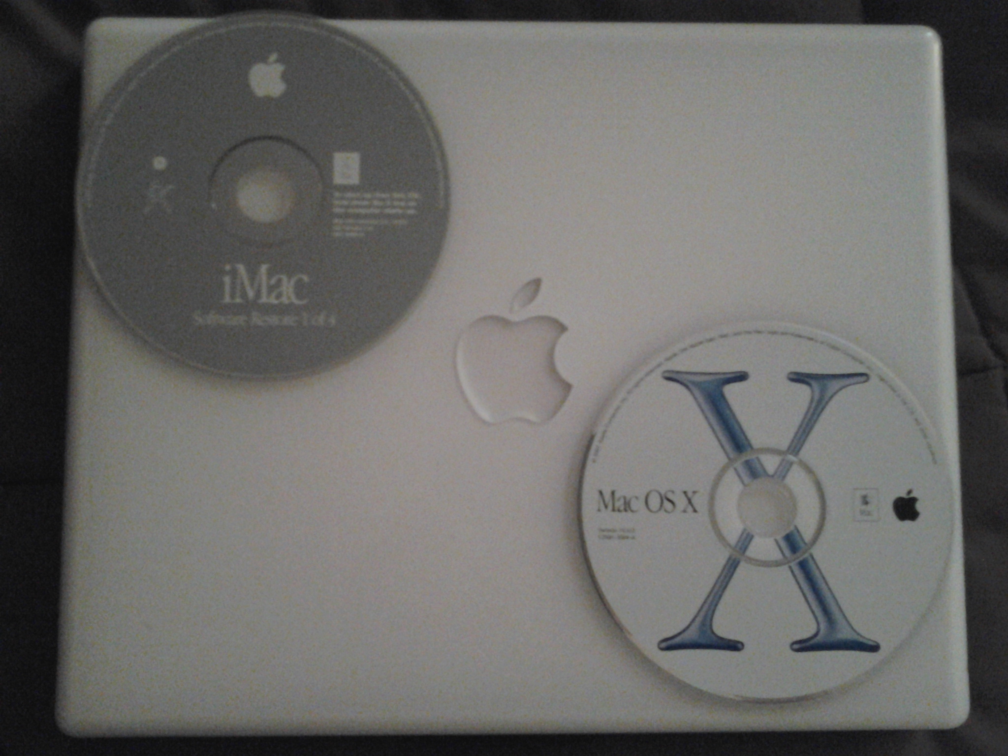

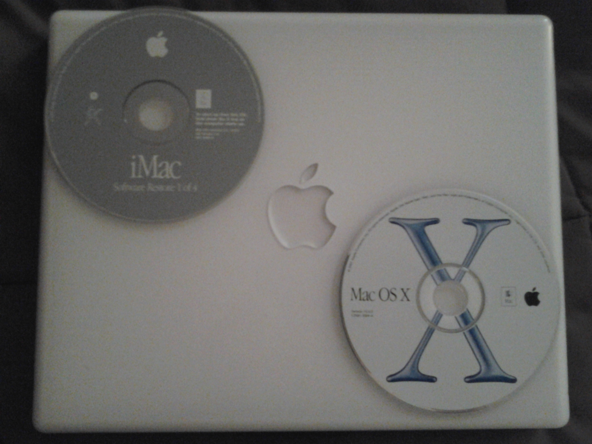

here is a pic of my disks i have to work with.
Well, that means OS9 is booting. It's loading a Control Panel or Extension that references something online it looks like.
Taking OS X out of the mix. Reboot and hold down SHIFT while the Mac is booting. You want the OS9 screen to say "Safe" or "No Extensions" or something like that. That will let you get to the desktop and won't load any of the startup items.
You can then go in and remove the Control Panel or System Extension that is causing the hang.
EDIT: That gray disk you show is specific to the iMac, not your iBook. I can't really help with the OS X disk or why it's Kernal Panicking (the code lines you are getting).
EDIT 2: Assuming for the moment that you could get OS X to install. You have such an old version that your iBook is just not going to be able to run anything. I really would suggest trying to find a copy of Tiger.
Eric is right. I would second that you have the wrong install disk for your iBook. Get 10.4 retail disk.

Ok, with alot of trial and error, i was able to get it to load to log-in screen, and was able to log in as guest with no issues. on boot up, i was able to hold space bar, and able to turn of all Extensions in manager, this did the trick.
*heres the kicker.....theres an admin password ( I dont have).
I tried to re-boot with "Apple+S" but it still loaded to log-in splash. If i go into "Open Firewire" can i create a ROOT or Admin account/password there to gain control over all accounts left behind ? when the person i bought this from sold it, they left all the accounts behind ( like 200 of em) wtf.
-re-cap, So i can log in now as guest, but dont see option to create admin account? Am I missing something?
