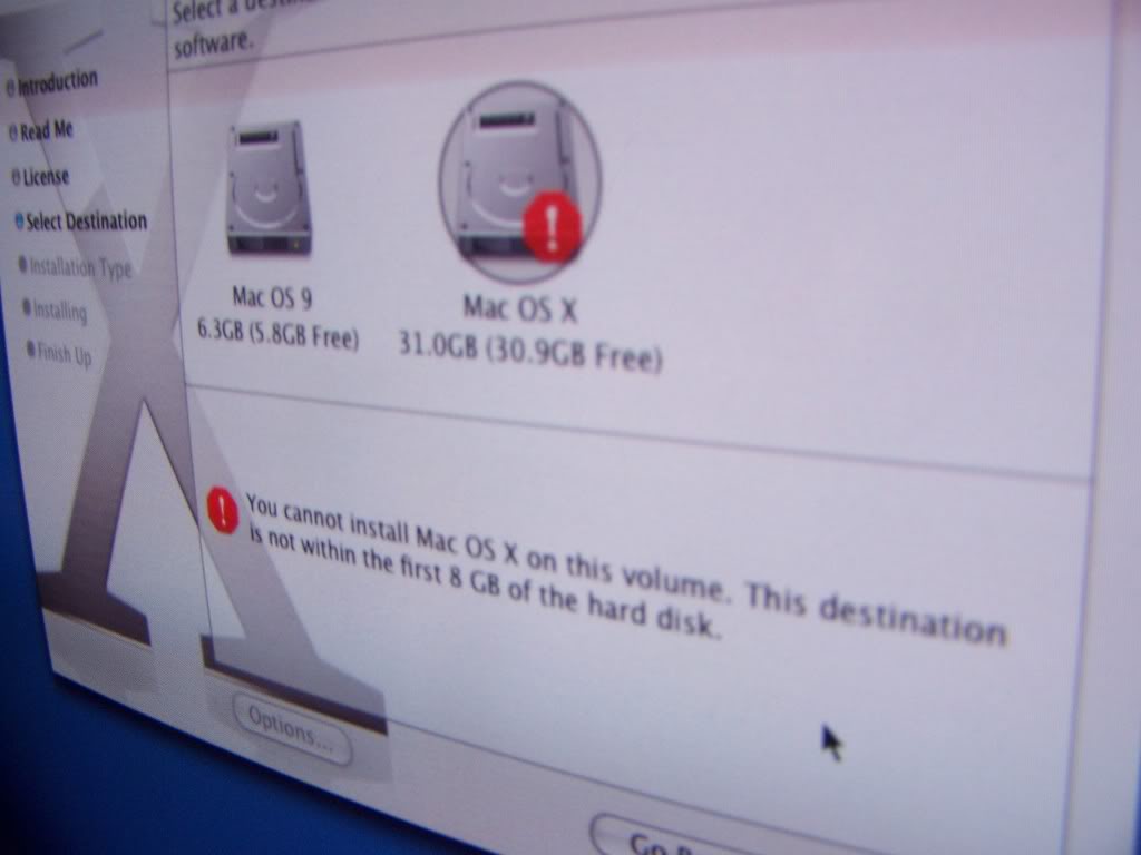

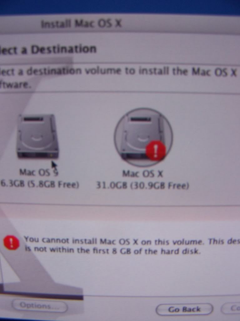

ok, ran into a few problems, but all i have sorted except this.
*install new hard drive, everything fine
*partitioned, first 6500mb, second around 30000mb (changed setting to partition with zeros or something and partitioned using os 8 (couldnt find borrowed os 9 disc)
*upgraded to mac os 9 when disc was found :p
*THEN went to install panther on the large partition (which i named Mac OS X) but it said: "You cannot install Mac OS X on this volume. This destination is not within the first 8gb of the hard disk".
So what do i do???
If that involves repartitioning the hard drive, do i have to partition using zeros (i think that was what it was called) because that is what that dj website said to do, but it take up so much time?
It would be great if i get a reply before torrow morning as i will probably set up the partitioning tomorrow
Lyam
EDIT: i can put a picture up on request, but that would mean putting it on photobucket, although i wouldnt mind if it helps people
and
EDIT: sorry for the image size
Still need help, I would be grateful for any suggestions or advice that could help me.
Please help :confused:

hmmm, well that seems weird, now formatting new hard drive again which the large partition first. my iMac gets quite hot and i decided to clean the fan out when i purchase and install the ram. i will let you know how i get on
i had to make three partitions
mac os x 1 (7gb)
mac os x 2 (20-30gb)
mac os 9 (6.5gb)
i could find a way round that problem, i tried putting the bigger os x partition first, but it said it has to be within 8gb
:eek::confused::eek::confused:
my osx panther partition is 121.5 gb big and my os9 covers the rest of 6.5
and i did install os9 first to see if the firmware is uptodate
and after i installed panther in the first 121.5 gb and the os9 at the rest
