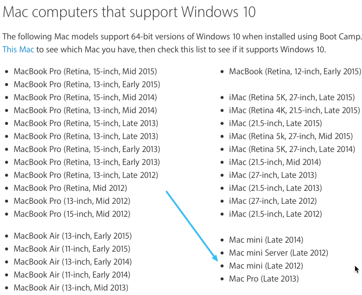

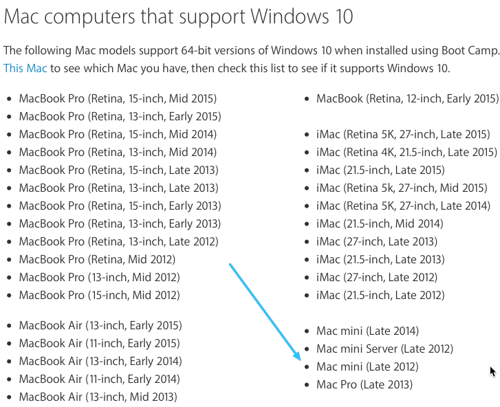

I don't believe that Mac Min is supported for windows 10.
https://support.apple.com/en-us/HT204990
