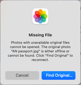

The '?' mark in the top right corner of a photo's thumbnail means that it's a missing "referenced photo" i.e. the actual photo isn't stored in the Photos app but somewhere outside, with only its thumbnail in the Photos library and a pointer to its file path in the Photos database. If you try to click open such a photo, you should see this message:
Go to Photos Preferences - General, and see if Importing - Copy items to the Photos Library is unchecked. If yes, check mark it. Then create a smart album with 2 conditions: <Photo><is><Referenced> and <Date added><is><Date> (In the latter condition, Date should be when you imported photos from LR). Presumably all items in this smart album will have the '?' mark. If so, delete them all. After this, re-import the photos from LR into Photos.

I did not have Copy items to the Photos Library checked. I believe I read an article several months ago that argued you should leave your original photos in place and not move them into Photos.
When I open the files with the ? I do not see the error message you indicated, the file opens. I wonder if this is because as long as I am opening it on the Mac and the files are accessible it is able to locate them.

Referenced files are flaky and best avoided. If you can open files with "?" notation, it may be because those broken links were created when Photos could not access those files stored outside the Photos library but now it can access them. If you find all referenced items imported from LR as explained in my previous note, and delete them, then re-importing won't duplicate these items. You may still duplicate items that are in LR and also already in iCloud - hard to say without knowing the full history.
