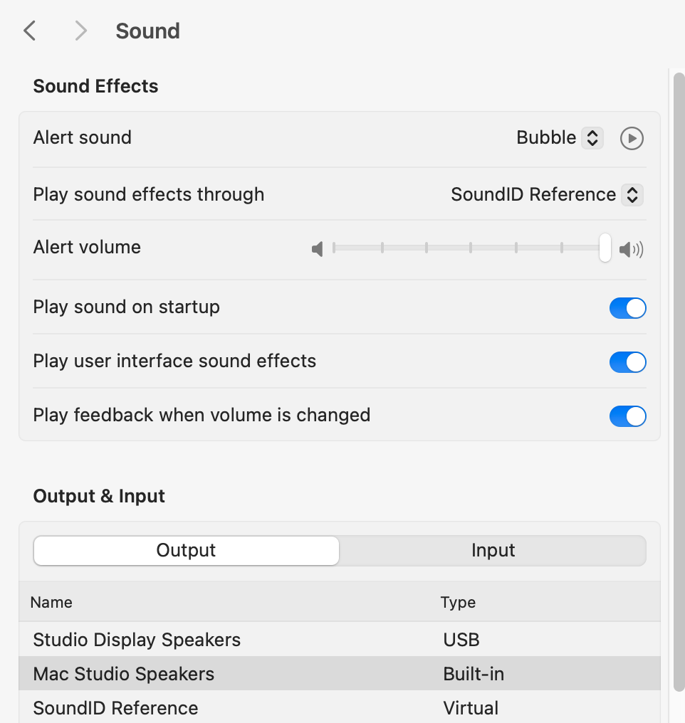

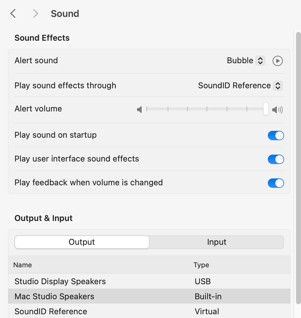

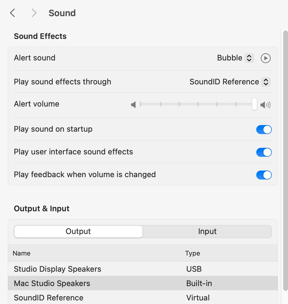

So when you change the alert sound at full volume in Sound preferences with the correct interface set you don't hear anything?
