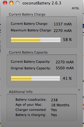

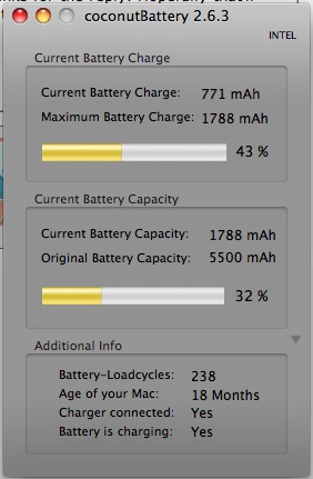

Here's a screenshot of Coconutbattery running. Going to reset the PMU also.
*EDIT* Just reset the PMU and ran the app again. Oddly enough now it shows more capacity for the battery. I won't know until later if it freezes off wall power or not.

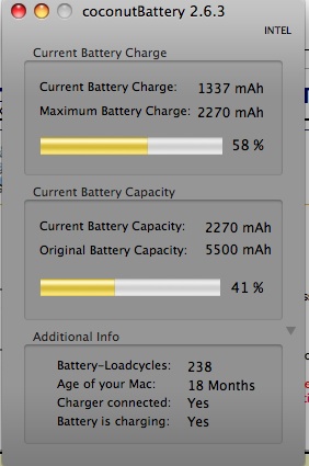

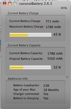

Your battery should be much healthier after 238 load cycles, apple is likely to replace it free.
