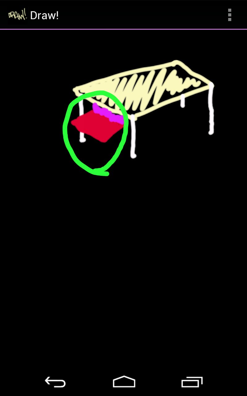

My problem: I would like to have my MacBook and my powermac with monitor etc on the desk. I can fit my powermac and everything on the desk, but after adding accessories I will not have room for my MacBook. To fix this issue I plan on having a smaller area that will be perfectly sized for my MacBook on the side of the main desk top.
I cannot for the life of me figure out how to attach it. Here is a quick sketch:
The red/pink thing is the MacBook spot and the tan is the desk. So... anyone have any ideas?
I'm still having a hard time visualizing what you are trying to achieve from this drawing.
Is it just a plywood extension off the end of the main desk? What's the pink, as opposed the red? Is there some reason the desk can't just be a little longer to accommodate? I also suggest a shelf-type thing at the back to hold stuff, maybe the monitor?
I'm just trying to figure out how the red/pink part relates to the rest of the desk before suggesting a way to attach it.
I just redid my desk which is a stock 90˚ corner desk, but I added numerous shelves and compartments to it to hold my iMac, MacBook Pro, X-Keys, Tablet, iPad/iPhone Dock, letter trays, speakers, printer, office supplies...and nothing is out of arms reach.
Make a mini-me desk at 90º to the main desk, just for the MacPro, and put it left/right under the desk.
You now have room.

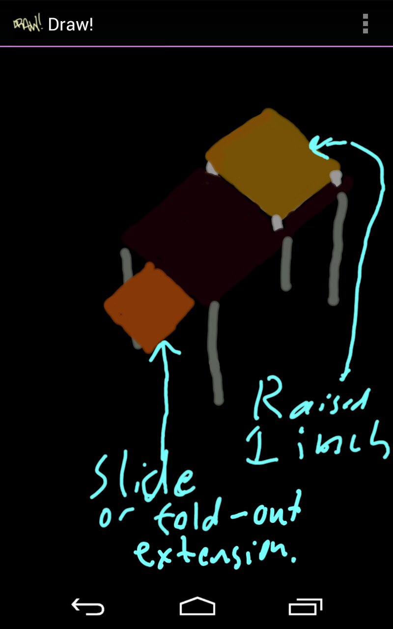

Also I need the slide out piece to go the other way. Something like this?

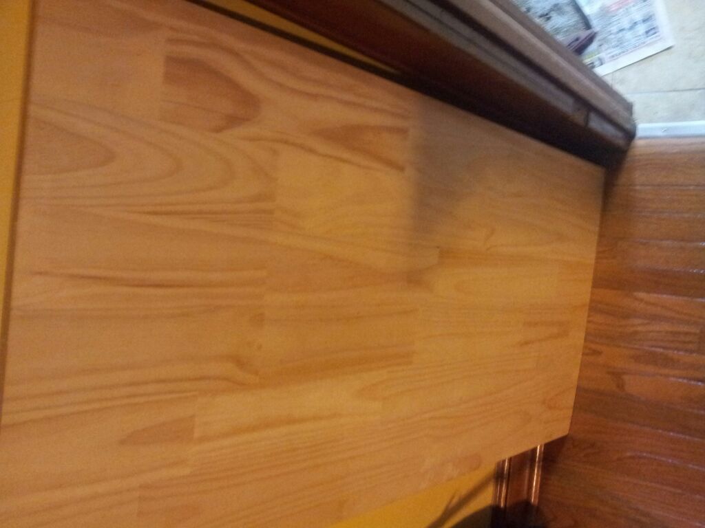

I guess it does look OK. Just not what I'm looking for. Plus I already bought the top part of my desk. Only $22 bucks at Lowes! Very solid and nice looking.
And this is my revised plan. I might use the raised part... not sure yet.

Not sure if anyone cares... but I finished staining the top
