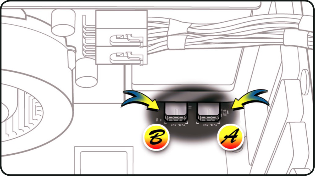

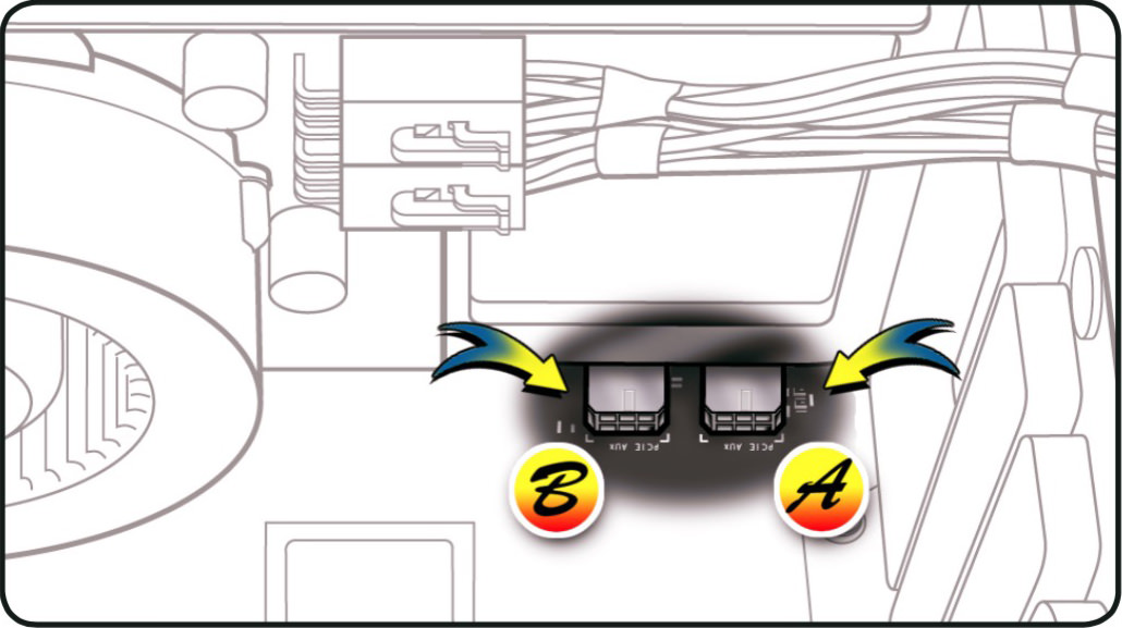

Thanks for the link to the cables. I understand where they connect to the card, but I can't find a place on the computer where they would connect. Can you give me some guidance? I have taken the 970 card out and replaced it with my old 120 card until I can get the cables. I have been looking for about 10 minutes but can't see a connection on the mobo. Can you give me directions as to where that connection would be?
Thanks
Ron
h9826790--
Thanks for the picture showing the location of the connections. Very helpful. Another question. As your graphic shows the connections on the mother board are 6 pin connectors. The connector on the card is one 8-pin connection. How do I connect an 8-pin card to a 6-pin mother board? Do them make cords that are 8 on one went and 6 on the other? Sorry to pester you guys with such basic questions, but as I said before I have never done this before and I am learning as we go.
Thanks
Ron
Buy and install the cable is easy. However, the problem is that a 8pin may draw up to 150W but the 6pin technically can only supply up to 75W.
