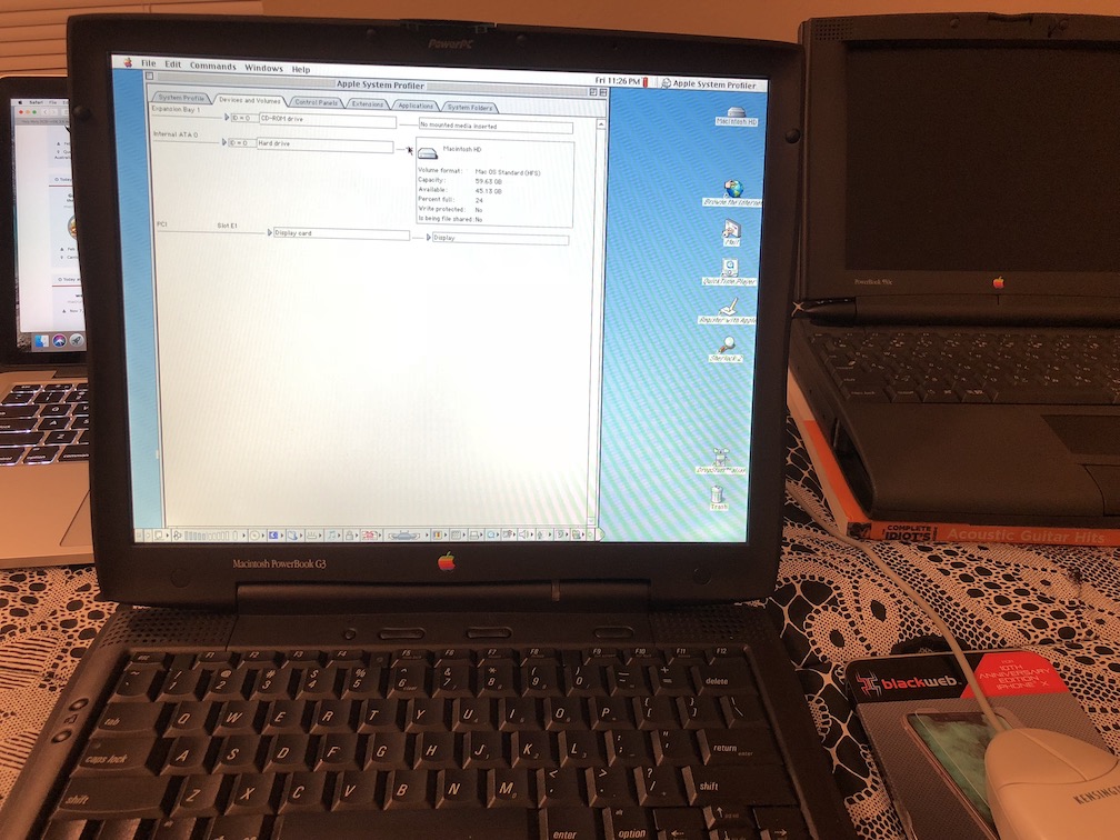

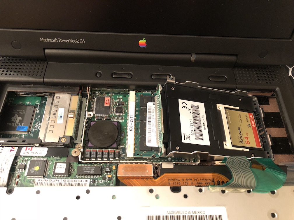

Hi Gary, I've just recently installed a 64GB CF card through a 2.5" adapter yesterday on my Wallstreet. Works pretty well, feels very snappy, too. On first install, when I boot up the system 8.5 install CD, it immediately prompted me to initialize and format the drive. I've since updated to system 9.1, and so far, it is still running well in my limited time playing with it.
