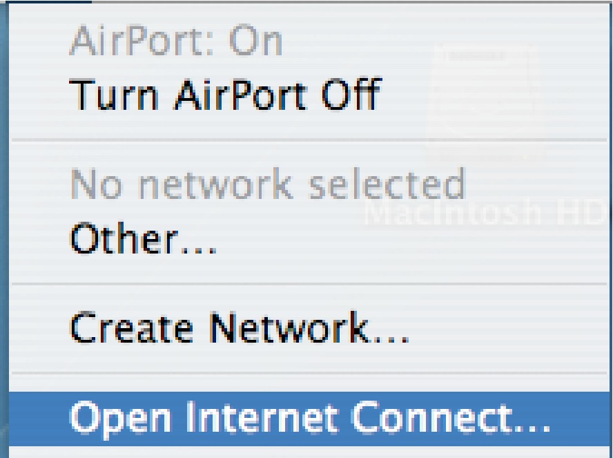

Here I'm opening AirPort and selecting Open Internet Connect:

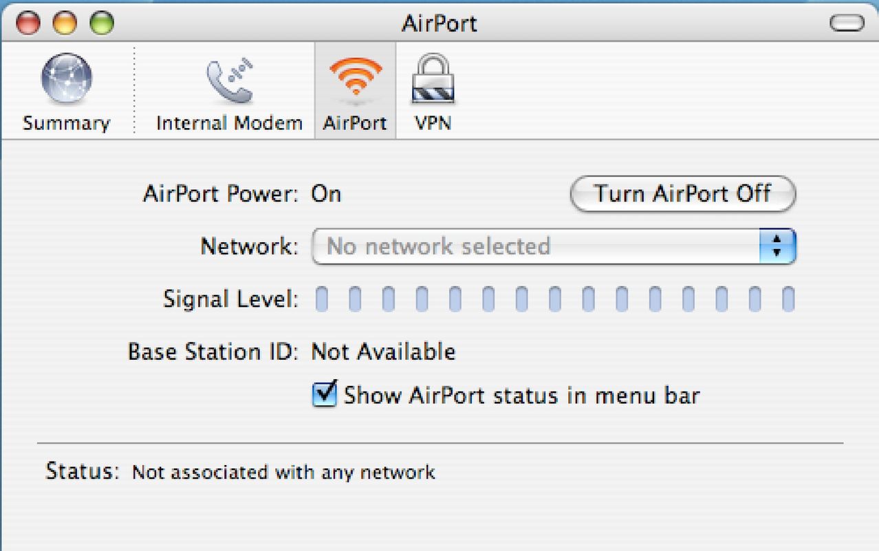

Here it's wanting me to select a network:

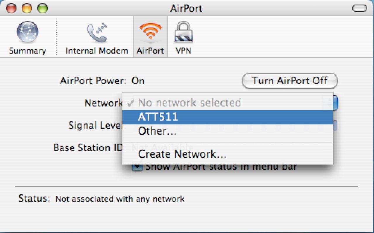

Here I've selected Network ATT511 which is my new U-verse service.

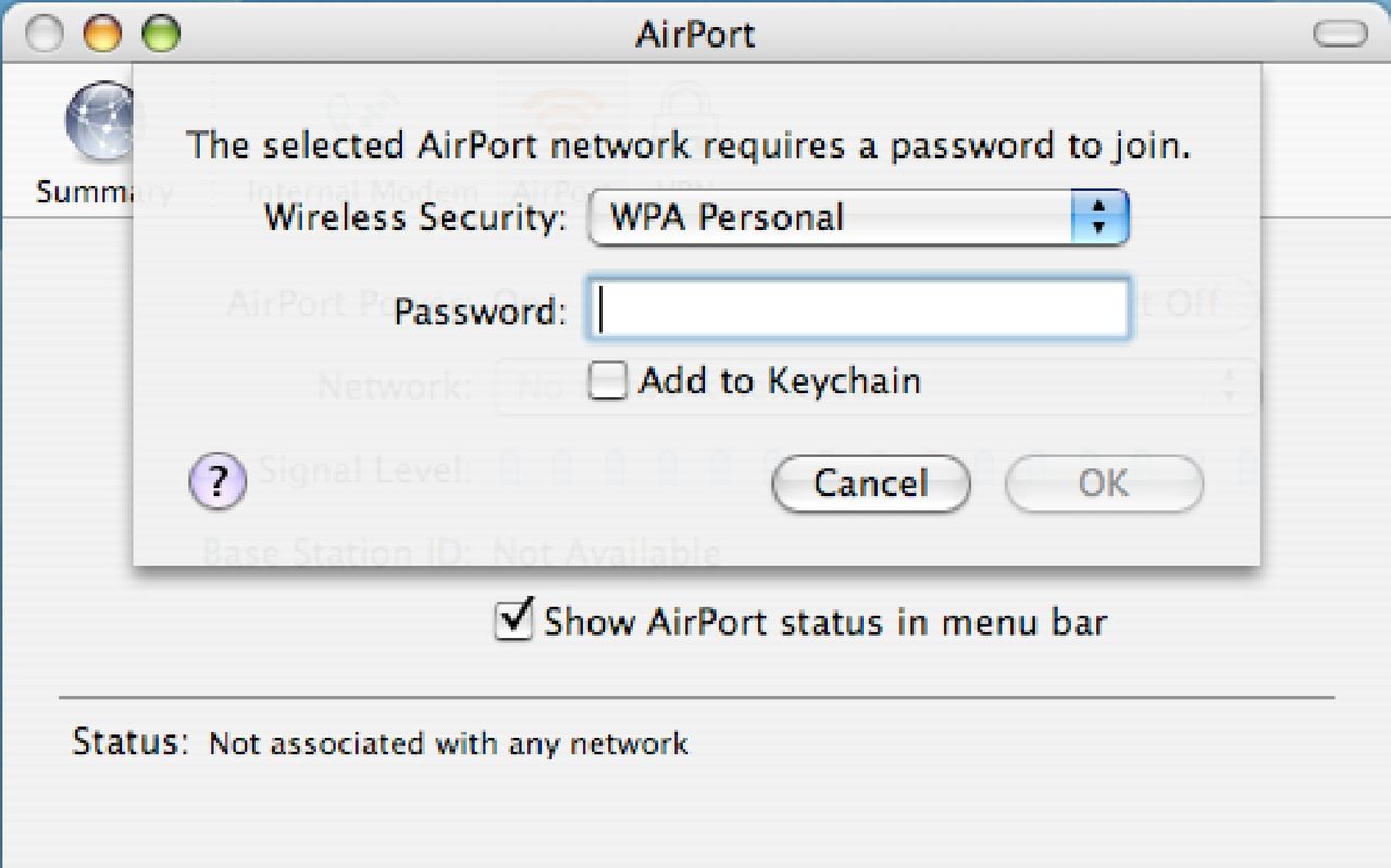

Here it's asking me to enter my U-verse Key Number which is 7837432115:

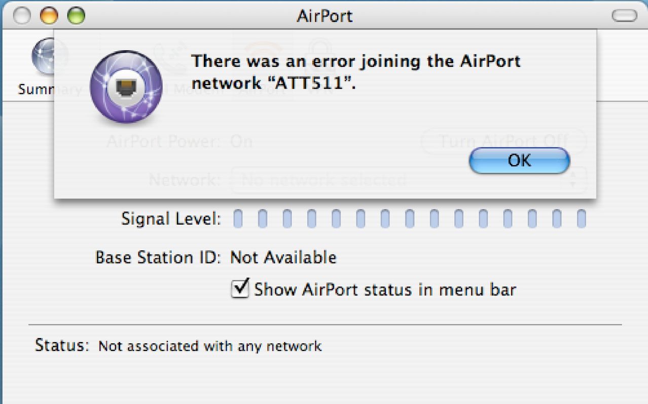

Here is after I've entered in the key number and this is the Error Message I get:
It seems as though the PowerBook sees the WiFi signal, but it's not letting me join the network. Why?
Try connecting to the network using the Airport menu item's Other option and not the Internet Connection app. Also, you can only connect to a WEP or WPA network. You cannot connect to a WPA2 network.
As Intell said, the issue may be in the fact that your router is set up using WPA2, or even WPA with an encryption other than TKIP.
With the original Airport card in your computer, you can only connect to WEP networks or WPA/TKIP networks.
If you remove the airport card, you can put an Airport Extreme Compatible PCMCIA card in the slot and connect to pretty much any current WiFi protocol. This option will cost you ~$10, and also leave you with a big bulge on the side of your computer.
Alternatively, many routers will allow you to set up an unencrypted "guest" network that's separate from your main network. I did this on my router, and have no issues connecting any WiFi equipped Mac to it(even under OS 9) without compromising security. For a while, I had a separate router(an old "flying saucer" Apple Airport Extreme) set up with WEP encrytion(which is as good as having none at all, although it does allow OS 9 computers to connect). Its proximity to my other router caused signal strength issues from both, and I felt this was less secure than the router's guest account.

Well fellas, I finally got connected. Someone on another forum informed me of a special AT&T web page that I can go to--to make changes to the settings on the modem. All this time I was wondering why there's no buttons on the modem; now I know why. This PowerBook can run on both WEP and WPA encryption settings. The frequency on the modem must be set to 802.11b.
