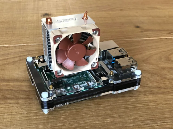

Found this on r/raspberry_pi. Someone put a Noctua heat sink and fan on their RP4. Pretty cool (pun intended).
