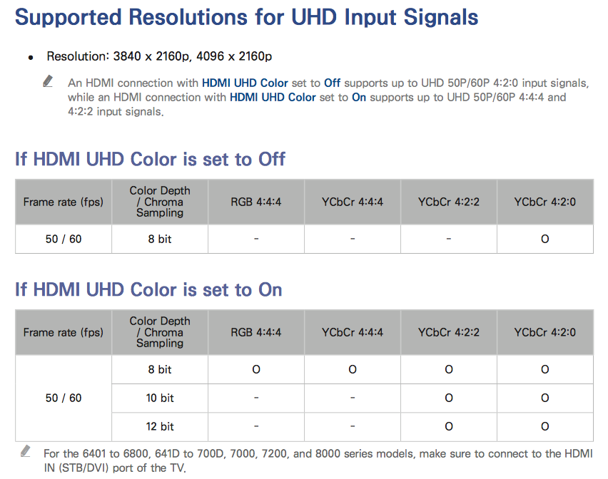

well, what I found when I downloaded and glanced at the user manual for your tv is that, with HDMI Color set to off you get 4:2:0 color, with HDMI Color set to on, you get 4:2:2 color, which is needed for HDR. Maybe check your user manual or download it yourself to find out how to change this setting. I have read others say their TV needs to be set for 4:2:2 for HDR to work.

Thank you for taking the time to give a thoughtful response. I did find the color selection for the input I am using, in this case, HDMI2 and you were right it was off. I turned on and rebooted the TV and then tried to manually select 4K on the ATV. Still no picture unfortuntley. I tried various power on sequences to no avail. The cable I am using is the one the Apple store sold me and said it would work. I bought my son the same cable and an ATV. His is working with his Samsung TV we just bought him at Costco. I have to believe because of that the cable is not the issue.
[doublepost=1506273792][/doublepost]Finally got the TV to accept 4K 50 hz SDR. The screeen kept flickering on and off for a while but the TV and ATV finally sync’d. While the TV was flickering I held the ATV remote Menu and Volume - button at the same time and the picture finally appeared and stabilized. I think turning the color on as was suggested above worked. I also got a Check cable option, did so and it passed. Thanks for all the suggestions.

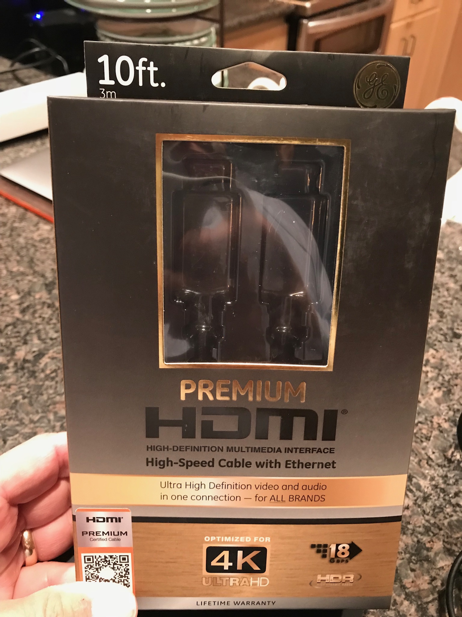

I my case it turned out to be the cable. I went to Walmart as someone suggested and bought the GE cable, 10’ for $15.00. It does have the certified label on it. Plugged it in and presto, 4K at 60hz SDR and a gorgeous picture on my TV. The 49.99 Belkin cable is going back to the Apple store for a refund.
I bought this one in 10’
https://www.walmart.com/ip/General-Electric-Ge-6-Ultra-Pro-Hdmi/121812038
Thanks again to all who helped.
