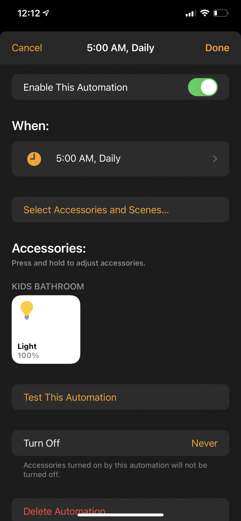

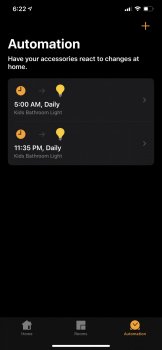

I am not sure what I am doing wrong, I would like to set up Automation, where lights would be at 15% when you turn them on between 11:45pm and 5:00am and after 5am it would be to 100%
I have these two automations and when I Test it, it works, but it does not work during the time slots.
What am I doing wrong?

You’d need to set two automation up.One for the first timing to come on and go off and the other for the second timings. Also when setup you’d need to put the slide at 25% to come on. You can see if it comes on by after setting them press the icon ‘test my automation’ on each of the two also where it says turn off set them to go off

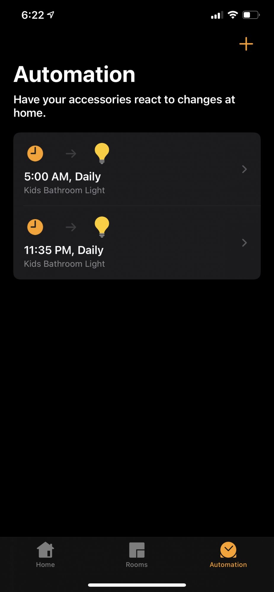

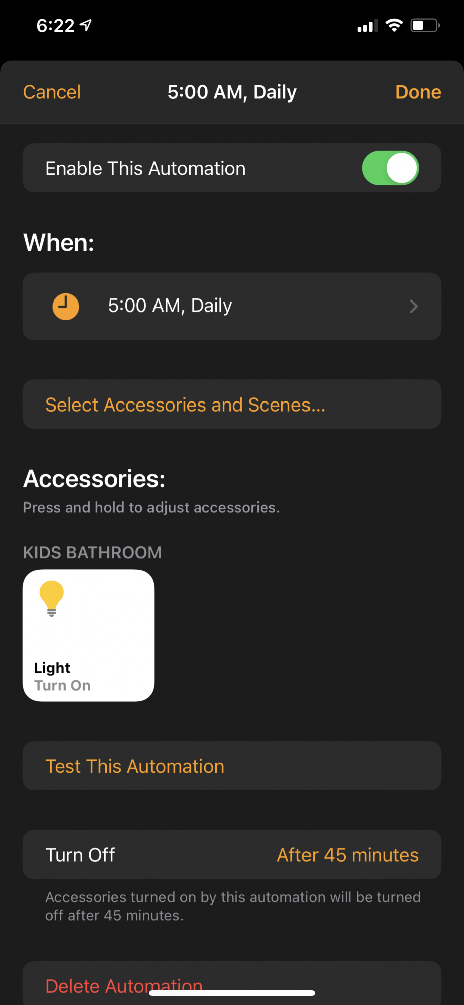

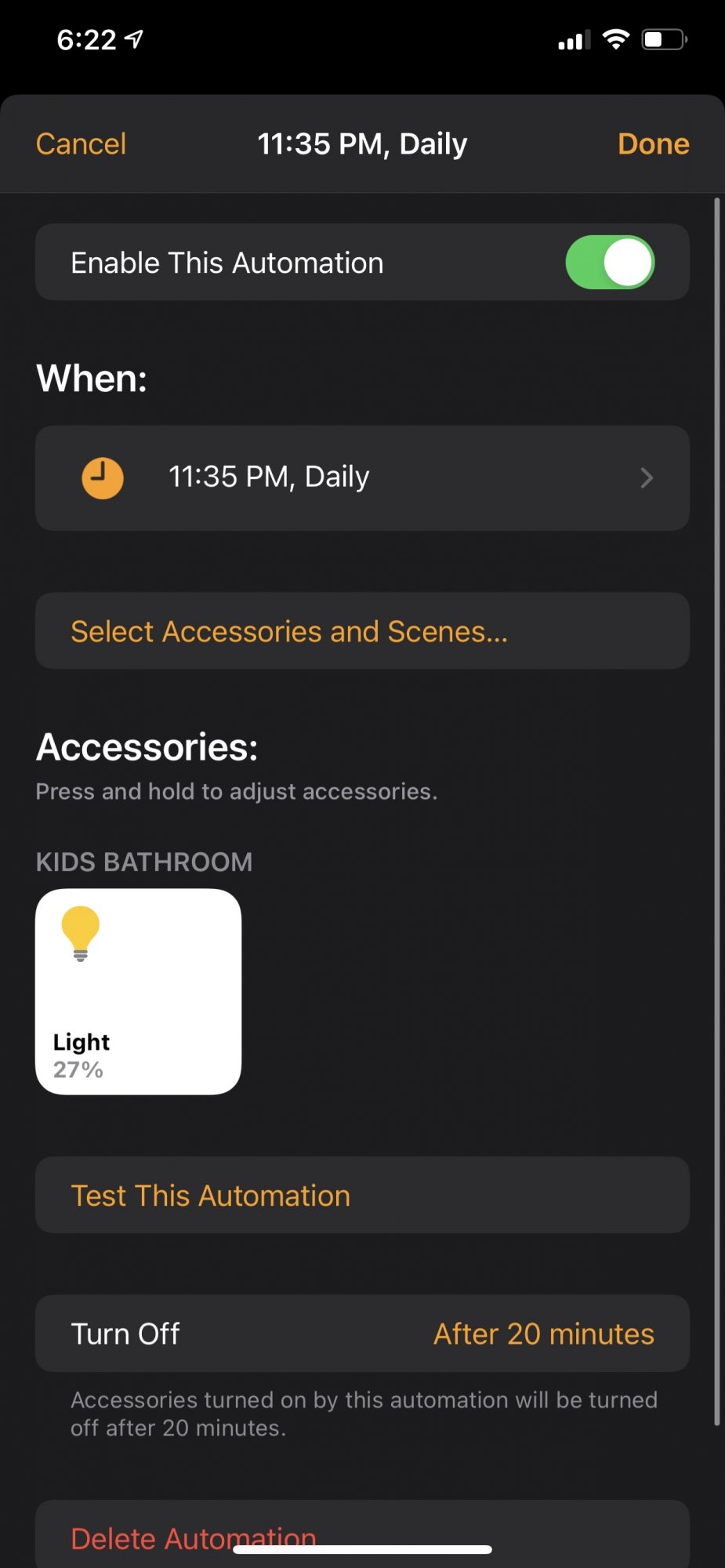

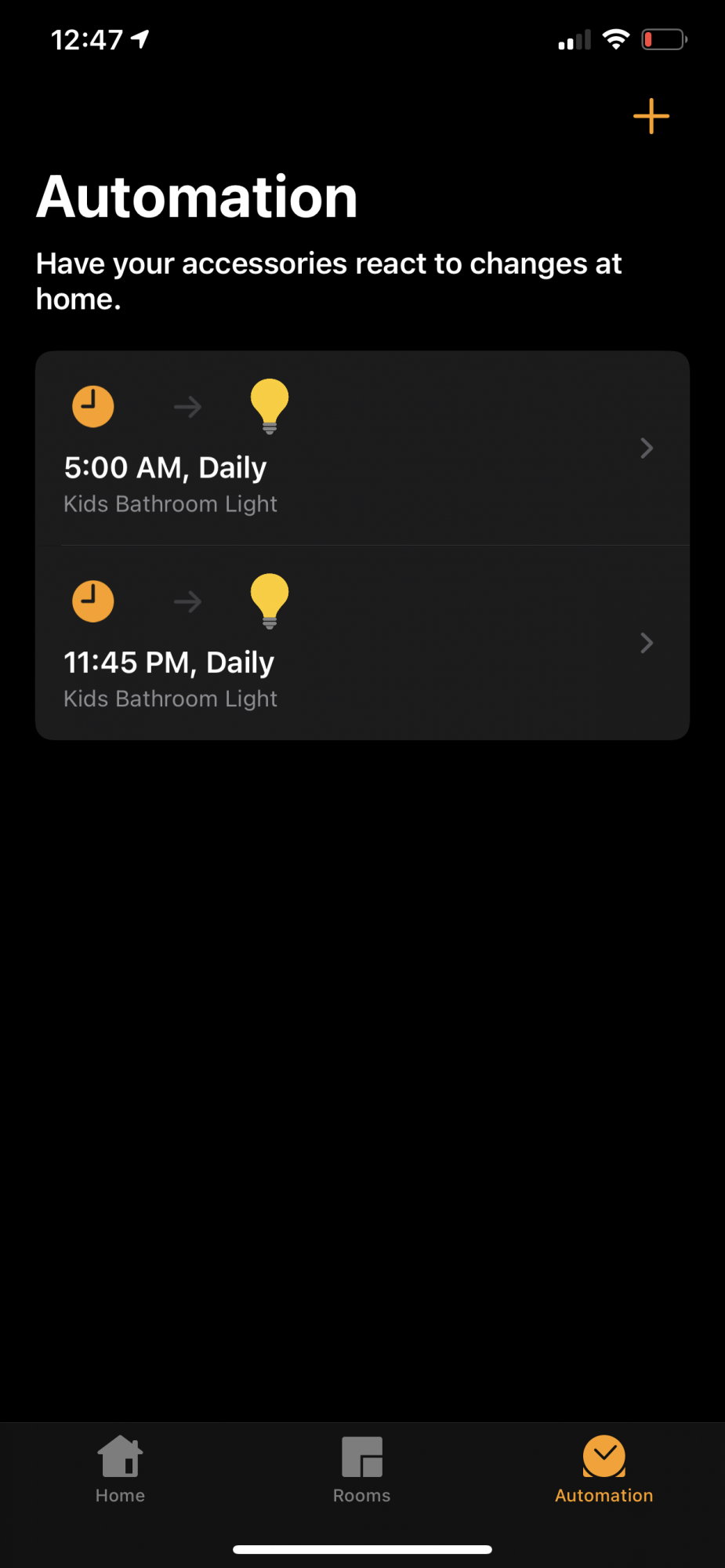

However, i am not sure how to set it up. This is my current set up (photos) and if i Test each Automation, it works (it will dimm it down to 25%).

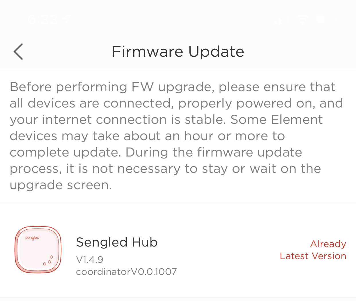

Sengled light bulbs are connected via Hub (they are not Wi-Fi) and both hub and bulbs are up to date on firmware.
