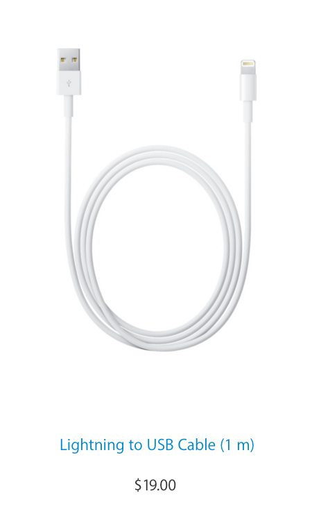

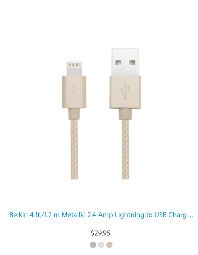

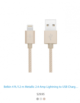

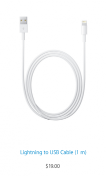

l was going to go for the bog standard cable as shown in first attachment, but the belkin cable is 2.4Amp, as opposed to the bog standard white cable, which l assume is 1.0Amp. does this mean it will charge faster with the belkin cable? If so will it require a higher output usb power plug? as the usb power plugs l have are only 1.0A output. so would the belkin cable be bottle necked with my 1.0A output USB plug? so a more powerful USB plug be required to appreciate the higher output? Are the two USB sockets in my MBPR have a 2.4A making it power compatible to the belkin cable?

There won't be a significant difference in charging between the two cables.
The big difference will be the source power - the little white cube that came with your iPhone, which would be 1.0A maximum. Using a different power source/adapter with more current available will make the difference, and enable faster charging. I don't expect that you will see any difference if you simply swap cables only.
Either the Belkin, or your original cable will offer faster charging when more power is available. Both will be limited to lower amperage if the power source cannot provide it.
Ultimately, the iPhone itself is the limiting factor, as it determines the charging rate for its own battery.
Generally speaking, if more power is available, your iPhone will usually charge more quickly. For that small amount of current, the connecting wire is not a limiting factor.
Reactions: Appletise
Neither cable or adapter will make any difference for the 5s. The included Apple adapter will charge it at the fastest possible rate.
^correct. It wasn't until the 6/6plus that the iPhones were capable of receiving more power and thus a faster charge.
