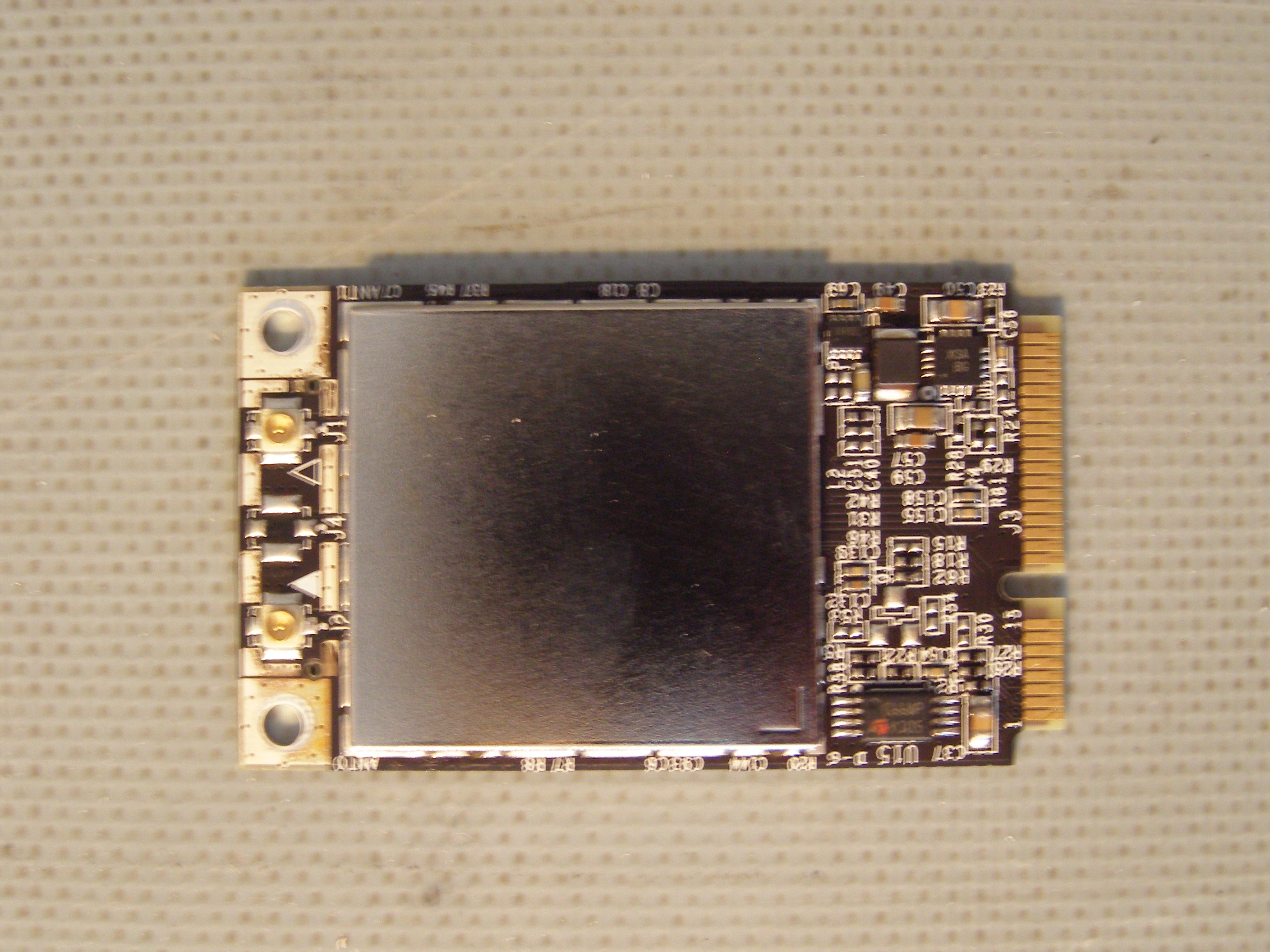

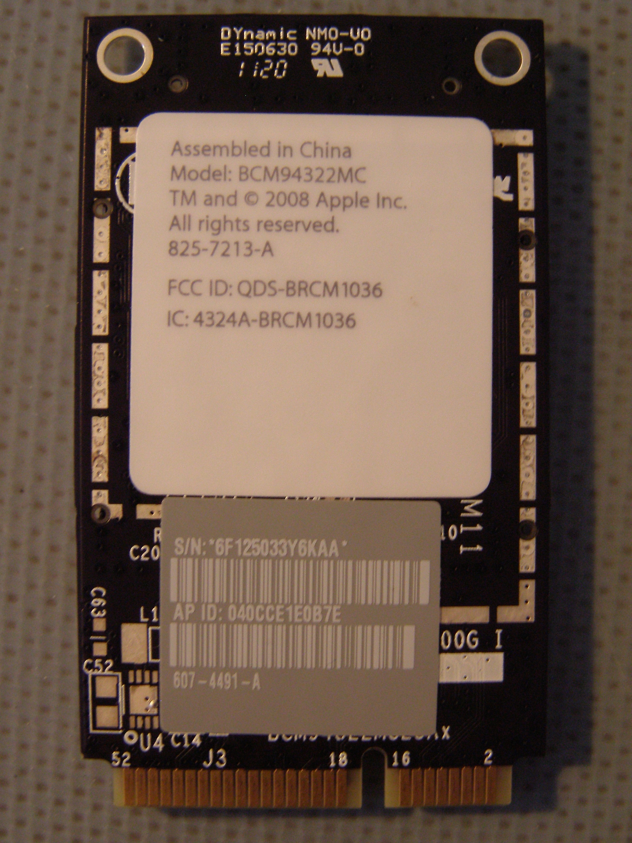

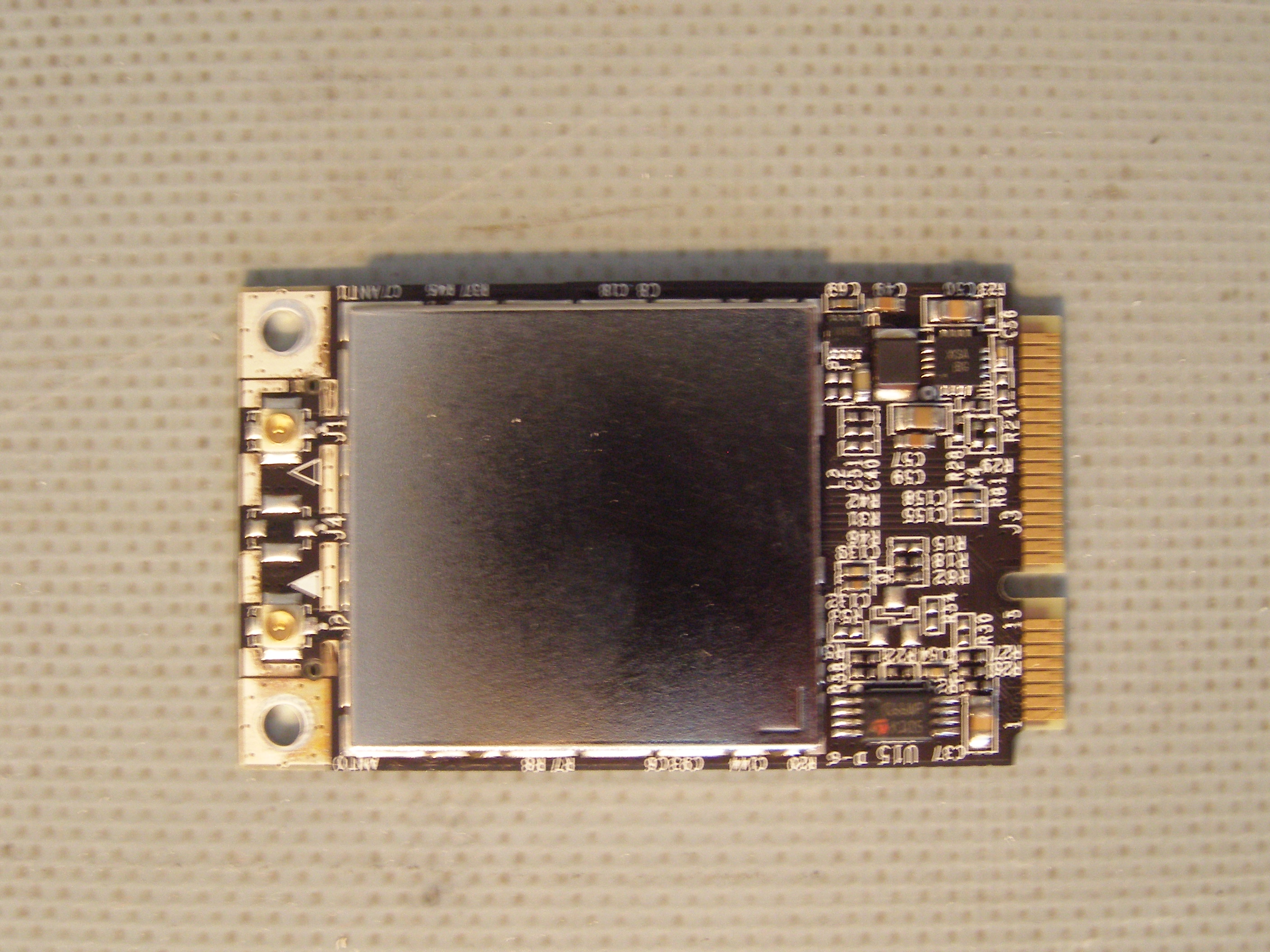

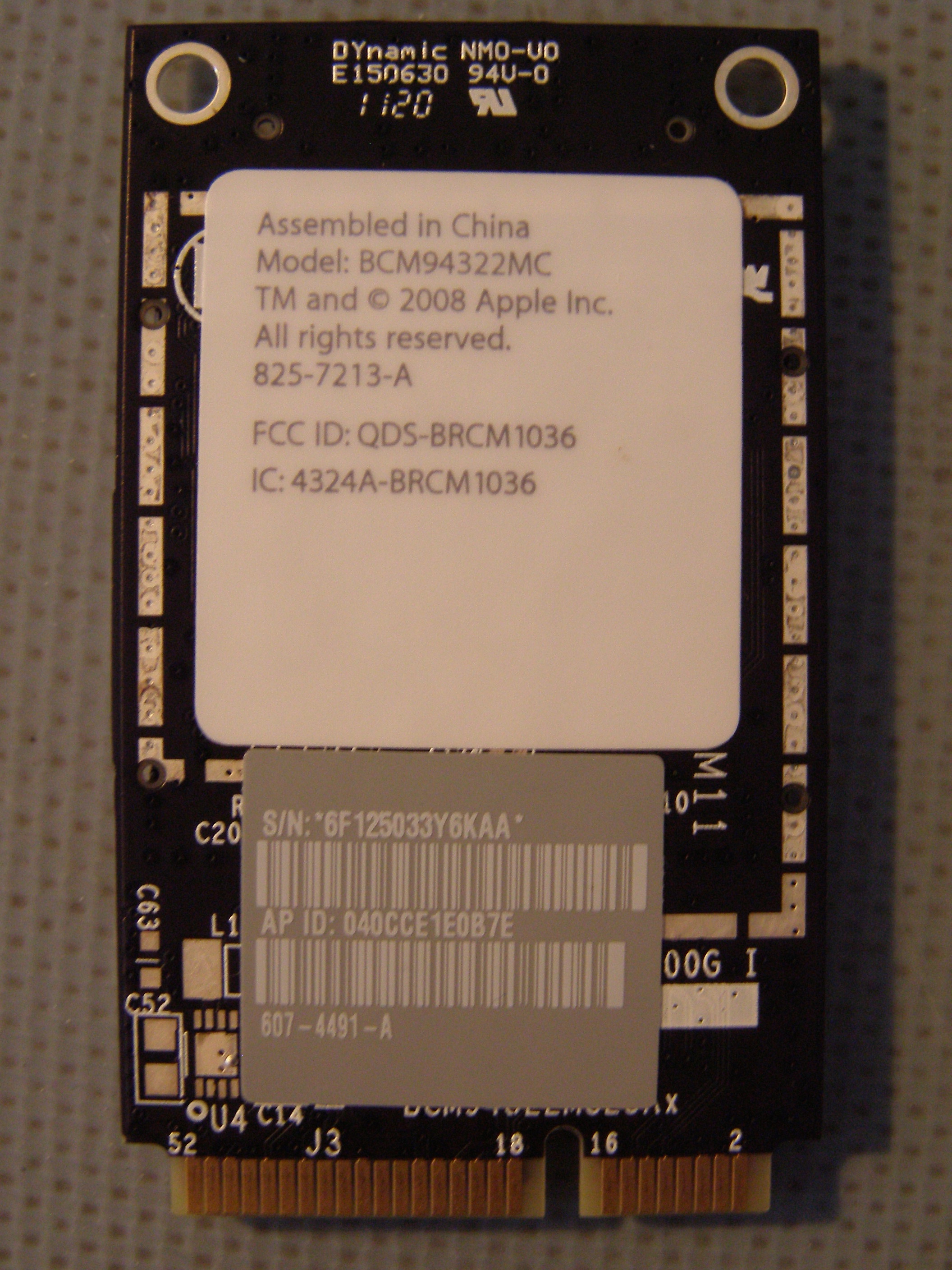

Here is a genuine , factory installed mini PCIe wireless card for the Mac Pro 5,1 (2010-12) . Accept no imitations .
APN = 825-7213-A and with an EEE = 6KA . You need both of these model numbers . EEE number is the last four alphanumeric digits of a part's serial number , minus the last digit .
With a 802.11 G wireless router and a DOCSIS 2.0 cable modem I am able to achieve 17 Mb/s downstream and 7.5 Mb/s upstream performance .
They are rare and expensive , but currently on sale at DVWarehouse for about 40 USD plus shipping .
http://www.dvwarehouse.com/661-4907...,-Mid-2010-and-Mid-2012-MB988Z/A-p-37532.html
meh, that's last gen junk.
the card i posted in my link is a modern 802.11ac wifi card from a current macbook pro. Which is great cuz it means OS X already has the kernel extensions for it.
