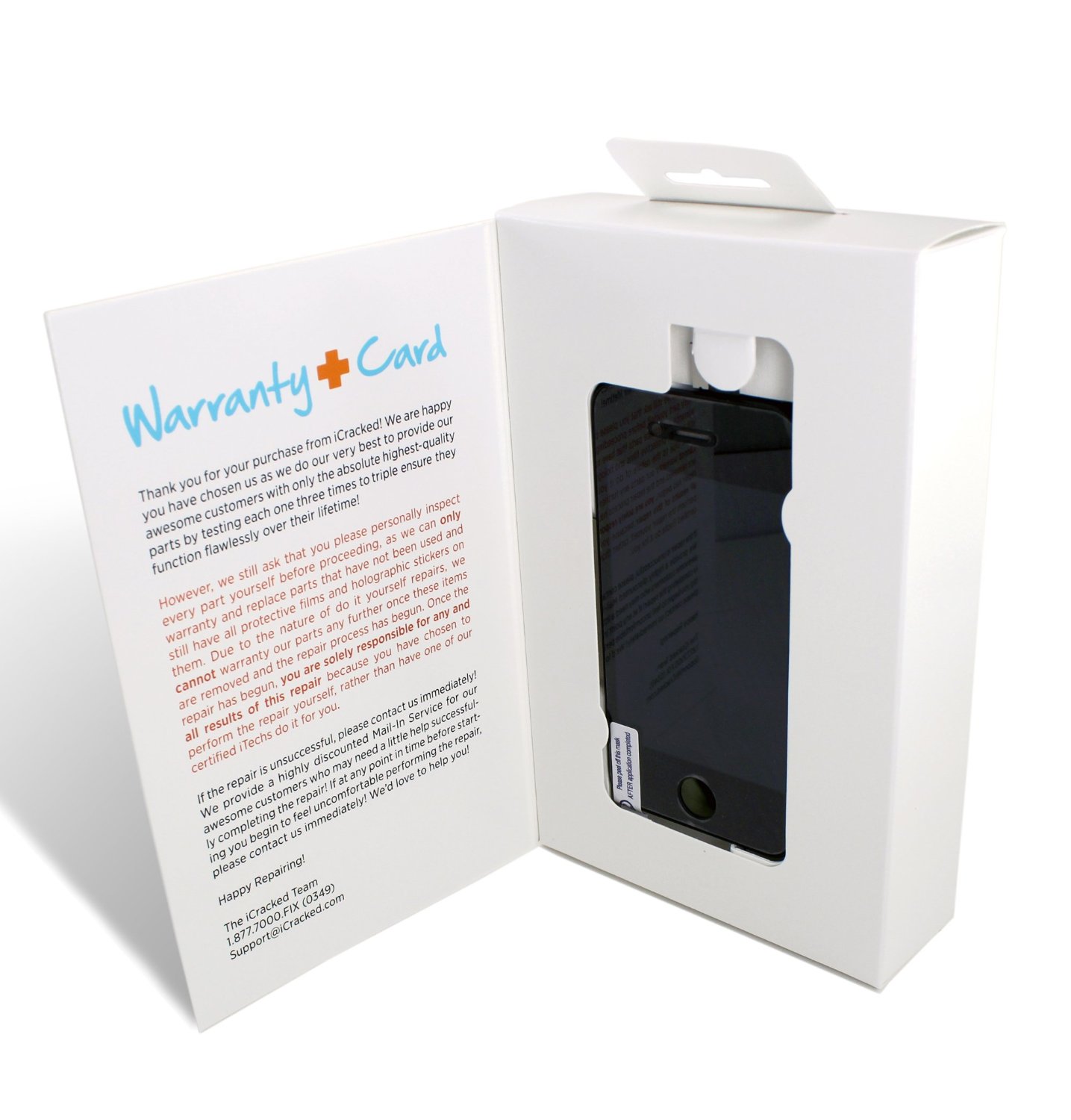

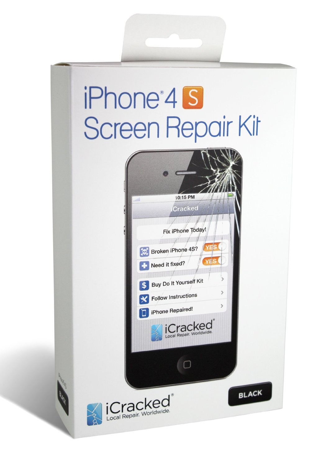

Either you take your chance with the cheap ones, get the one from iFixit or the iCracked screen replacement kit.
