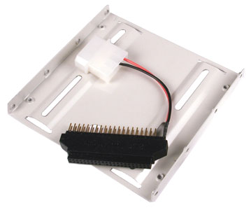

2. I have ordered a 2.5" to 3.5" frame to screw to the MPs slide out 3.5" trays. However with the Vertex SSD being shorter width, length and height wise than the standard 3.5" drives will I need a cable to make up for the shortfall?
3. I notice on the photo of the 2.5" to 3.5" frame that cut out grooves length-wise which I assume will allow me to slide and screw as close to the back plane SATA connectors as possible. But still not sure if this will connect directly in a perfect fit. If this turns out to not be the case, what cable should I get and the best length? I assume its a SATA (male) to SATA (female) cable, is there a correct specification to ask when I pop down to the local computer/electronics store? Please advise.

As far as I'm aware the only sleds that are designed to house these smaller drives in a Mac Pro are sold by MaxUpgrades. I'm not sure how these other 3rd party sleds work to be honest. >>>>http://www.maxupgrades.com/istore/index.cfm?fuseaction=product.display&product_id=180
I have two of these machined aluminum sleds from MaxUpgrades and managed to install the drives and mount them in the Mac Pro really easily as it was pretty straight forward.

thanks for the response. did you install SSDs or HDDs?
I installed 2x Intel X25-M 80GB SSD drives on two sleds and have them currently running as my main boot drive in a RAID-0 config🙂
ok. and they DIRECT connect to the SATA back plane WITHOUT cables? ie. seamless alignment and fit
Edit: Just looked on the Max site. And they have the Intel X25-M pictured so will definitely work with that drive. So should work with other 2.5" SATA SSDs
Yep. You screw the drives directly to the sled and heatsink and then slide it directly into exactly the same space as the default mac pro 3.5" sleds. It goes in great and connects directly to the backplate without cables. Seamless and perfect.
Perfect. I'm gonna order 2 straight away. Thanks again 😀
