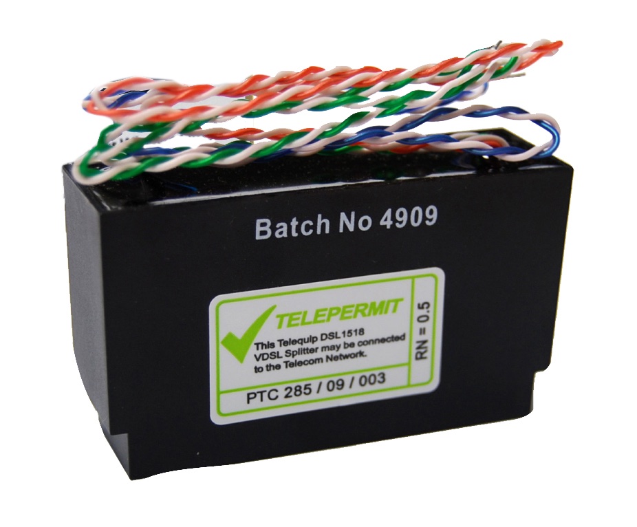

Upgrading my DSL modem. The new one only has a DSL line with no built-in splitter to go to a telephone. I have not had to use a splitter in many years. I am looking for a male in-and-male out splitter. Suggestions?
My personal opinion is "get one of these, do it properly, then never need to worry about it again". Yes, it's a bit of effort to wire it in, but if you're likely to stay on DSL for the near future then doing the job right is worth the effort.

They're "not needed" in that your ADSL will work, but it won't be optimal. The problem is not you hearing artefacts, but the modem hearing "reflections" from the cables in your house.
If you don't have a phone then you don't need a filter: you can plug the modem in as close to the demarc as possible and disconnect any other physical cables. If you have a phone then you'll want a filter wired in at the demarc.
Back in the good old days the ADSL installer would do all this for you, but these days people are expected to "self install", and they usually don't tell you any of this stuff.

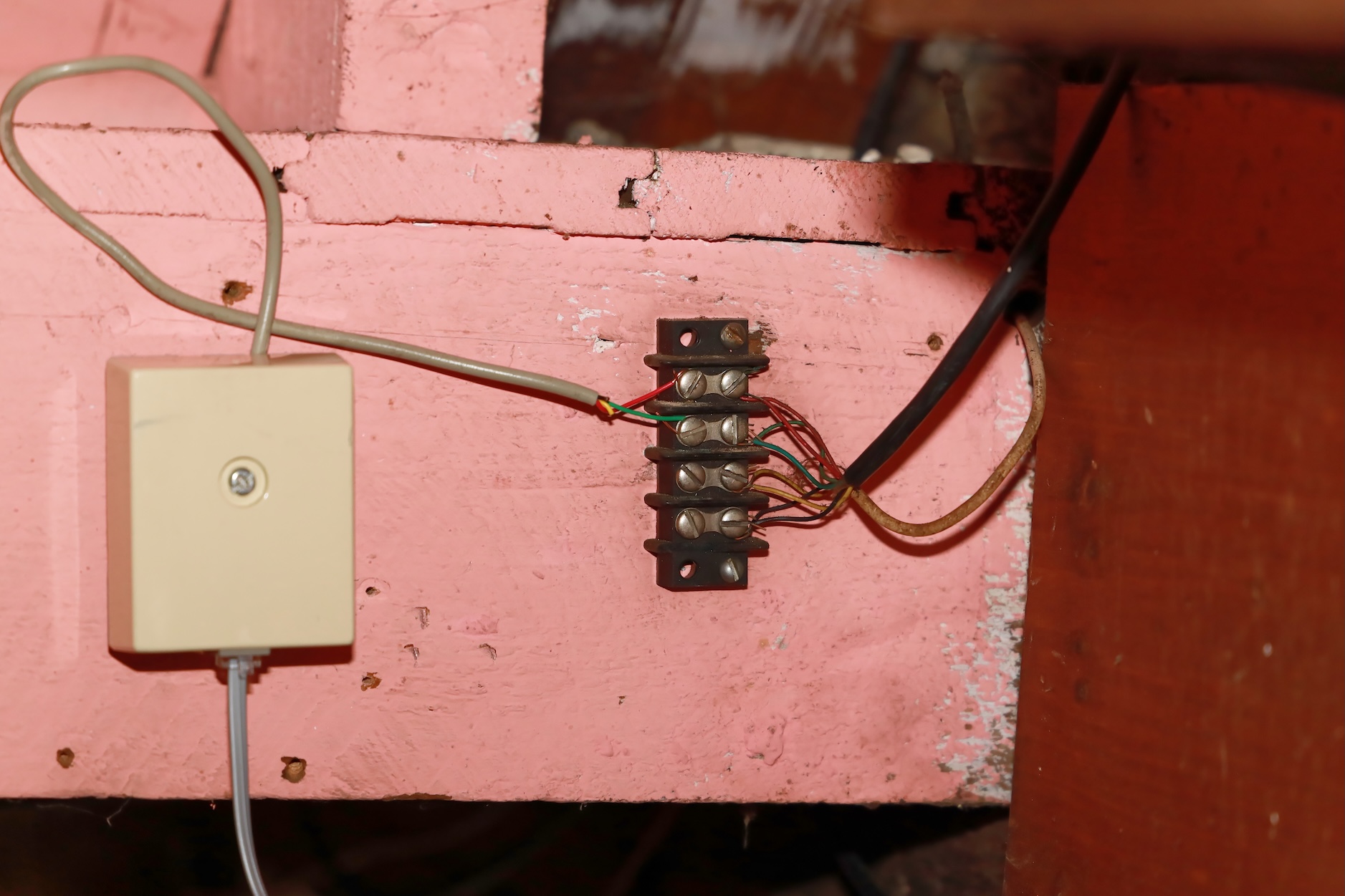

I still have "land-line" style phones in the house. However, they're no longer connected to a copper line "on the pole" outside. The phone signal comes in as VOIP, over a fiber-optic line. But it still connects to my house "the old fashioned way", through an RJ-11 connection you see at the bottom (and note my "circuit board" to the right!):
