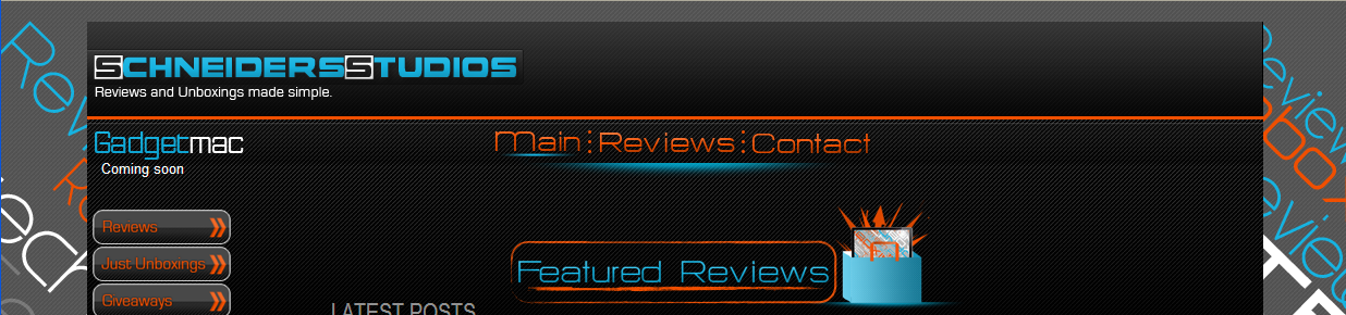

Here you GO
My background is static, however it only shows that it's correctly in place and aligned on both sides (text graphics) of the site's body on my display, on other display sizes it shows tiled a little and not in place.

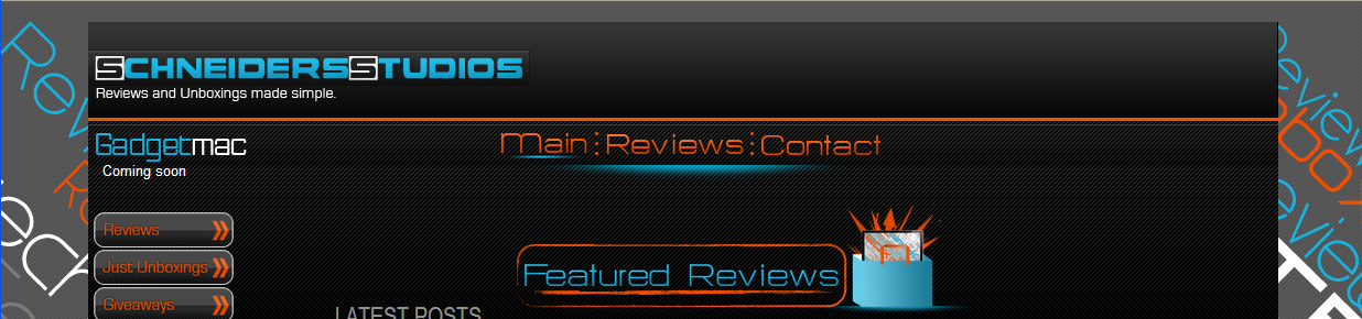

This is how it should look like:

Which browser? On Windows with Firefox, Safari, and IE8 it all looks the same, and I think it looks the way you want. I can't view the image you linked of how you want it to look because that site is blocked for me. I'll attach what I see.

Awesome that's how it should look like yeah, i guess the code part you gave me worked, thanks!
