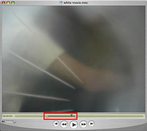

Drag the little triangles at the bottom The one on the left is the in point and the one on the right is the out point.
You dont have two little hash marks at the beginning of the clip? You should. Anyway, you can also mark the in by pressing I and out by pressing O.
