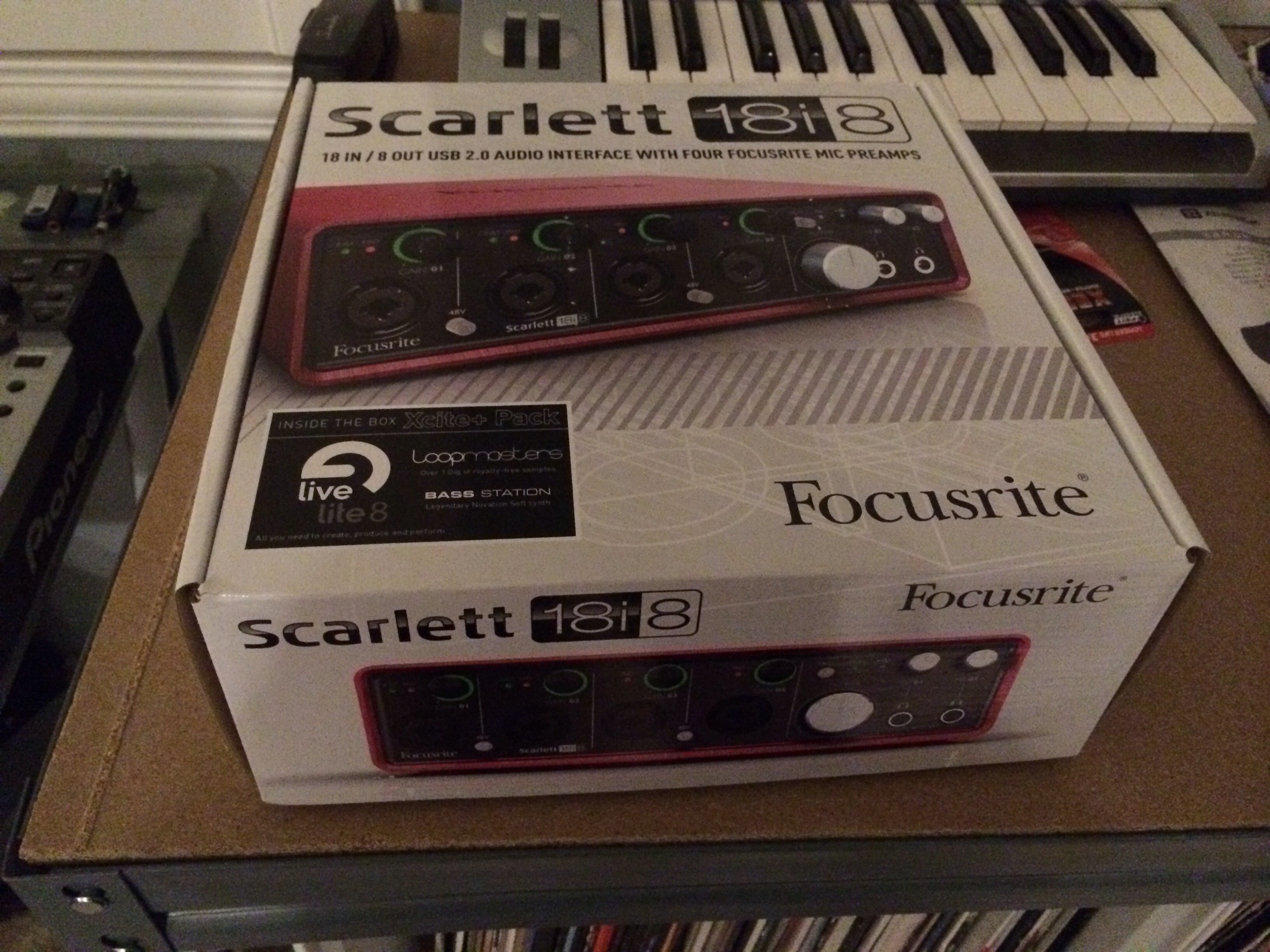

Duuuude! I just scored a New Sealed Scarlett 18i8 from Proaudiostar.com's ebay store with warranty for only $259! Not a bad find. Thanks again for the recommendation. Hopefully this and my nMP come right on the same day!
Very nice, as those things new are not cheap. How you are happy with the results, btw I just need to ask what is "MPC"?
