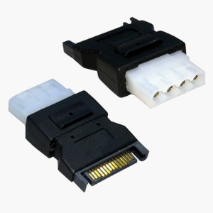

Yes it has to be connected, otherwise how would it know when to power on? 😉
From what I can tell from the pictures, the PSU requires a Molex input, so all you need is a SATA power to Molex adapter.
Something like this:

Your 2010 already has two SATA backplane connectors in the ODD bay. Considering that you've got the PSU in the lower bay, the connector is already in place, not reason to tinker with the hard drive bays. Just connect the SATA power to Molex adapter and you're done.
Edit: If you can't get a grip on a Molex adapter with only one - lets say "nose", just saw the right one off. The image of the adapter above shows two noses, which won't work out of the box.
