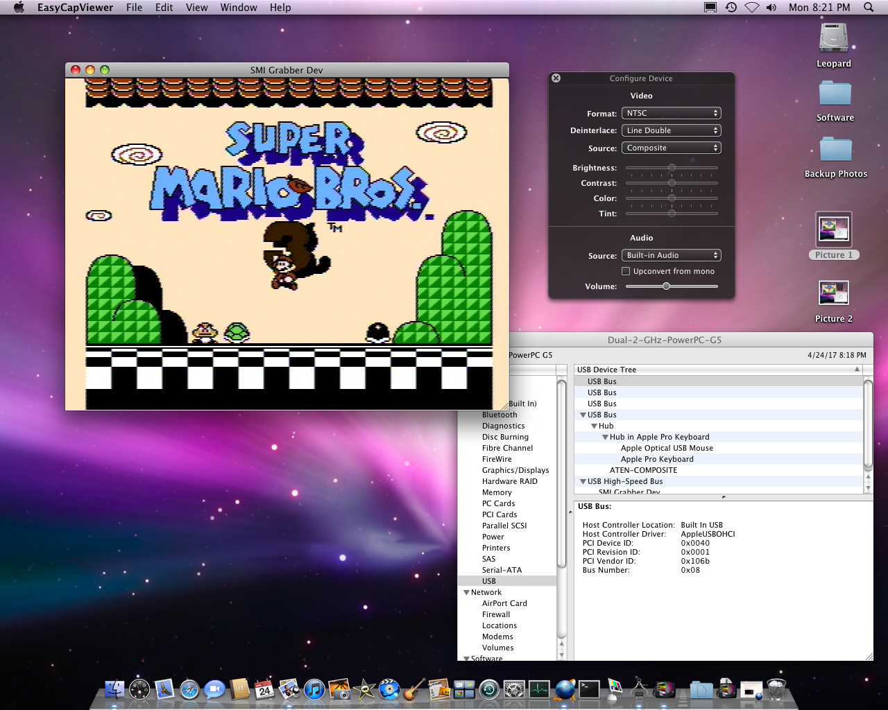

Here is the driver for easycap just in case . "https://www.bentrask.com/easycap/" . The latest version on that website does not work . You need to grab https://www.bentrask.com/easycap/EasyCapViewer-fushicai.zip I was able to get my SIIG JU-AV0012-S1 (which I already had years ago) partially working using the driver without audio .

If it was me, I would go with Diamond VC500Mac. I just happen to have the SIIG JU-AV0012-S1 so it partially working was a plus for me.

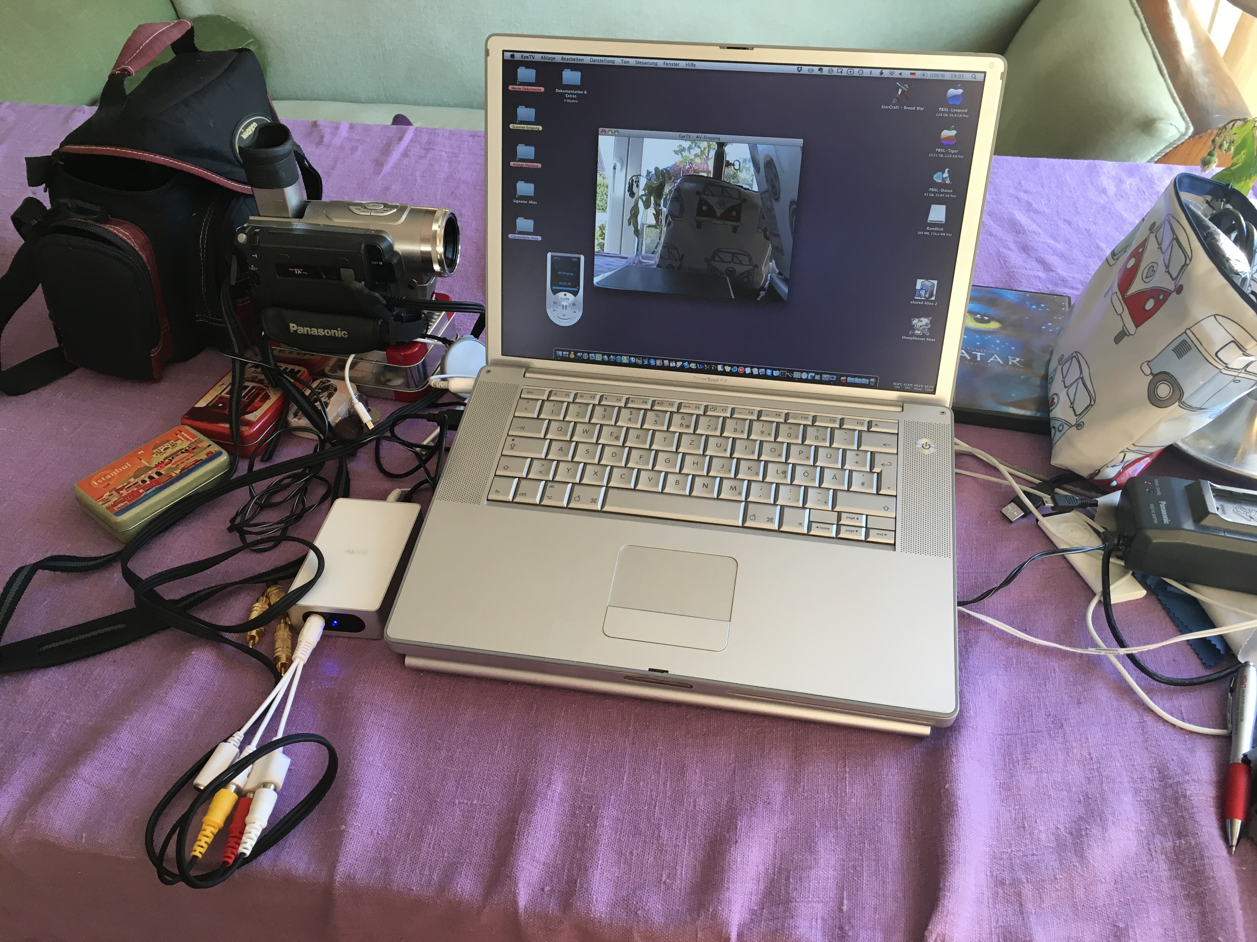

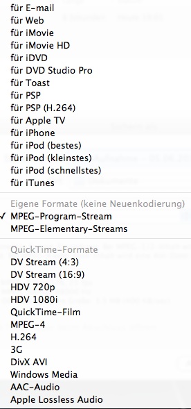

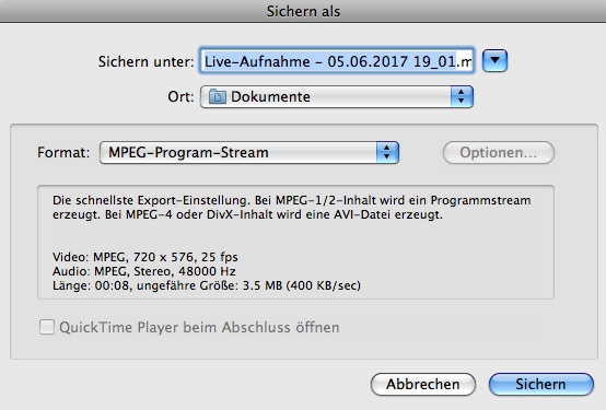

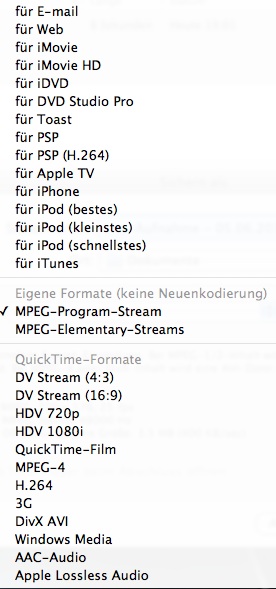

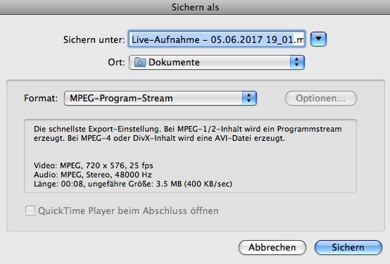

You've mentioned elgato in first place. So here's how "eyeTV250+" looks like in reality.
It came at about 20 bucks and was meant for my Video-Stream-Cheat-Project in first place.
https://forums.macrumors.com/threads/the-video-stream-cheat-project.2042289/#post-24551722
Then I started to transfer all our >15yo family DV-tapes via FW/iMovie'06/Powerbook-G4 onto an external harddrive, but a couple of early Hi8 AV-tapes were still left to be transcoded (they were shot with a camcorder of our friends) and I was lucky to find the "eyeTV250+" a very nice solution for that job. (I only need the fitting Hi8 camcorder to be borrowed from our friends again ... )
The foto shows our DV-camcorder connected to the eyeTV250+ and the PB-G4 via camcorder's AV-out, information about video-size etc and export-options...
