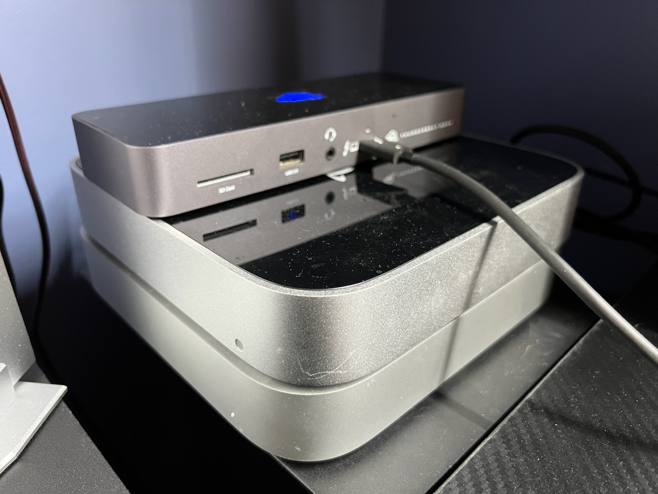

I'm not sure where to post this but I need to find the cable with one end terminating in an "L" (it actually needs to go to the right) from the front of my OWC Thunderbolt dock into the USB-C port of my M1 MacMini. As you can see if the USB-C 4 cable would angle right I could tidy up the cable, instead of it hanging off the front of my equipment stack.
So fare I have not be able to find an an "L" angled cable with Thunderbolt 4 designation.
Many thanks!

Many, many thanks again! The "L" shaped USB-C Thunderbolt cable worked great. Only other 300 more cables to re-arrange! 😉
