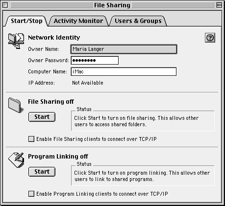

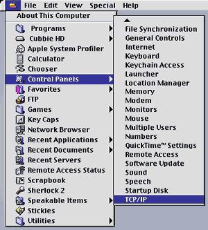

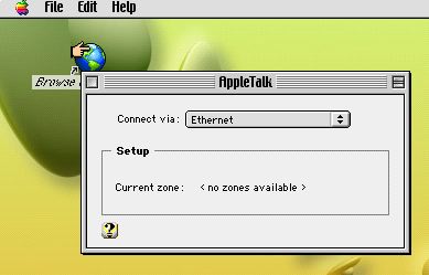

I'd try the Ethernet route first.
In the Apple Menu of the 7300 go to Control Panels>TCP/IP.
Set 'Connect via:' to Ethernet and 'Configure' to Manually. You want to setup a P2P two Mac network so pull your other Mac offline for this.
Where the IP addresses are, just assign the 7300 an IP of 192.168.0.1 with a subnet mask of 255.255.255.0 You can leave the other fields empty.
On your other Mac go into Network inside System Preferences and select your Ethernet connection. Set it up to be manual and assign it an IP address of 192.168.0.2 with the same subnet mask. Be sure to apply the changes.
On the 7300 go back into Apple Menu>Control Panels>File Sharing
Setup File Sharing, Users and Groups if you like, but be sure to turn it on.
Connect the 7300 to the OS X Mac with an Ethernet cable.
In Finder on the OS X Mac, go to 'Connect to Server'. Enter: afp://192.168.0.1 and press return.
Give the credentials and mount the drive. Find the data you need and copy over like normal. I would suggest that you copy in small chunks so nothing locks up.
If the 7200 does not have a TCP/IP Control Panel, see if it has an Appletalk Control Panel. If it has both then make sure the Appletalk panel is also set to Ethernet.
Wow! Thanks you so much for info. Especially the screen shots. Very helpful. When I get the chance, hopefully tomorrow, to get back to the customer's office, I will try this. Again, thanks for the detailed response!
Reactions: eyoungren
Well, the screenshots were from Google Images, so no biggie there. 😉
But I did want to illustrate where things are in OS9 and below. If you don't know where stuff is it gets confusing. It takes three places in an OS9 Mac to set up file sharing, where OS X has it down to two.
