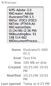

i have this really cool CD that i need to extract the images off of it. OS X won't even read the disk, it gives me the error -"The disk you inserted was not readable by this computer."
so i used Data Rescue II to extract the image folders off the disk, but illustrator CS2 wont read them... seems everything is messed up.
HOW do i get these images off the disk.. i would even consider paying to have these extracted to a readable format for CS2.

they are illustrator 5.5 files...

check out the preview of the files...

I would try several things:
1) rename the file from its current filename of "Illustrator5-00002.5" to a new name with the ".ai" extension. This forces illustrator to try to open it as a native ai file. Also try the ".eps" extension.
2) if this fails, rename the file to a ".ps" extension, then try opening the file either by dragging and dropping on the illustrator CS2 icon or using the open command from the illustrator application itself.
3) failing this, try dropping the file that you've renamed with a ".ps" extension onto Acrobat distiller. It might distill to a PDF file which is openable in illustrator.
4) try placing the file with the renamed ".ai" or ".eps" extension in Indesign CS2. If that works, export as a PDF from Indesign CS2, then open the resulting PDF back in Illustrator.
5) try opening the file with the renamed ".ai" or ".eps" extension in photoshop. It'll rasterize it, but if it works, you'll at least get the image back.
If all this fails, it could be that the file itself is corrupted. The fact that the file size is exactly 100MB seems fishy, like the recovery program you used sliced up the readable data from the CD into 100MB chunks.
Good Luck!
thank you for all your help. it seems that the restored files were corrupt.
i bought a cheap 8600 with OS 8.6, and it read the original CD right away.
now i just have to transfer them to the G5...
