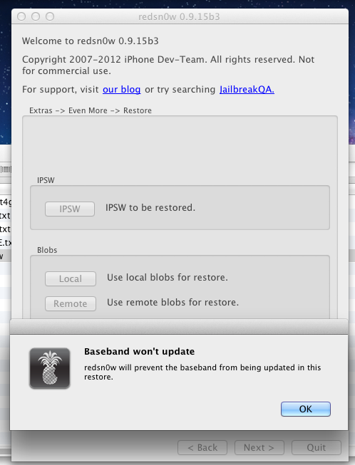

I can't seem to find anything that does this? Everything seems to 'preserve' the baseband which is not what I want. I updated my father's iphone 4 which had a very old baseband (1.0.05) and a very old ios (4.2.x) and basically couldn't really run anything anymore because the old IOS. With my limited SHSH blobs available I updated to the newest available (5.1.1). That went fine with redsn0w except for the fact that when i did it redsn0w says:
redsn0w will prevent the baseband from being updated in this restore.
I want it to update the baseband! This super old baseband appears to have a problem where the connection just constantly drops. Like every few seconds it says Verizon 3G and then goes to searching. I can make a call and get a few rings and then quickly gets dropped. Someone with a 1.0.06 baseband reported the same thing:

During your restores, you should reach a screen that looks like this. Clcik no.
What version are you using? What exactly did you do to get that state?
With the newest (0.9.15b3) I do:
Extras -> Even More -> Restore
I click the IPSW button and chose my 5.1.1 IPSW. Then I get this:
The ONLY way to get the baseband to update is to restore to current firmware.
