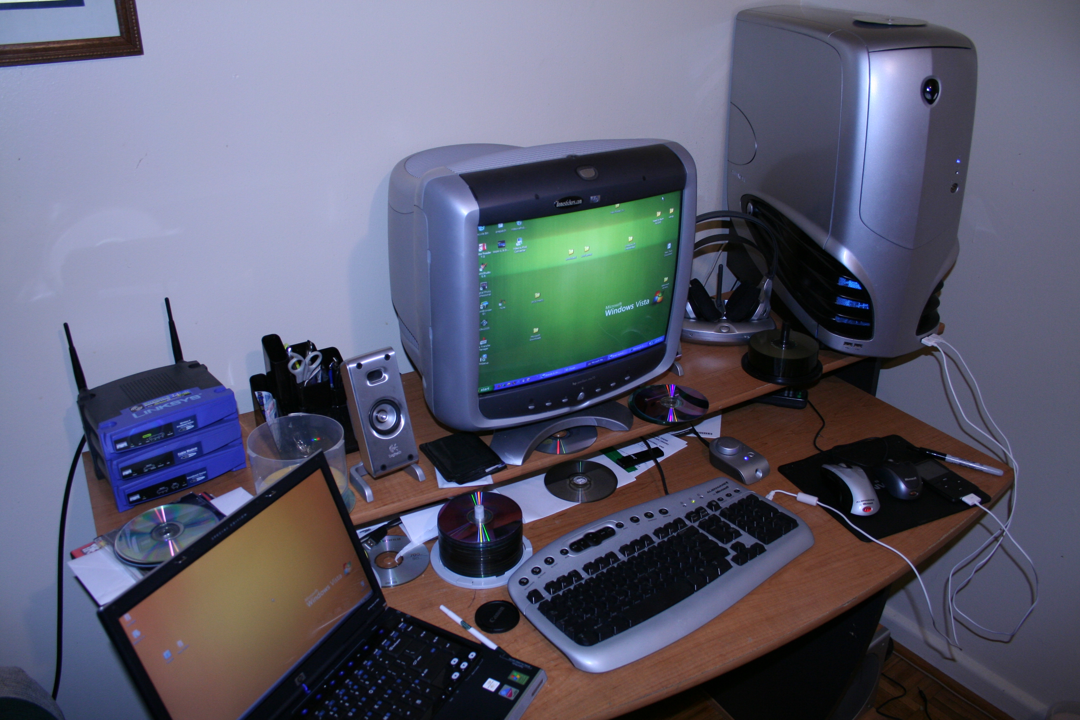

Actually came across a photo of my setup back in '05 with the WRT CableModem, Router and WiFi.
Kind of miss all that... and those wireless headphones with wireless charging back then. Oh my.
I loved my old WRT54G
I had one of those as well - it was like a tank, which is why I was (am?) gravitating towards the Linksys. I currently have a Netgear, its not a ACS router, and it seems to reboot itself every so often. Plus setting it up was a pain
